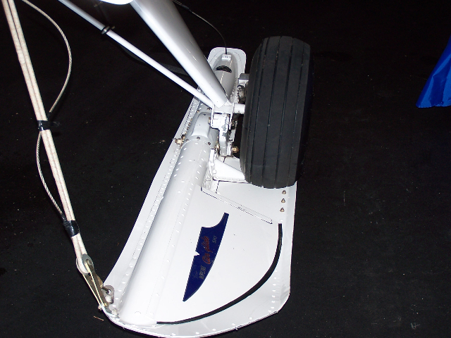

What I was trying to describe was the shape of the bottom of those
Wipaire Air Glide skis which (in the Aviat Husky picture on the cover
of Aircraft Owner http://www.aircraftowneronline.com/45/index.cfm
(or the picture that Randy posted)) seem to have a stepped bottom.
That is, it appears to have the outer half (from side-to-side) raised
higher than the inner half. I think this is a trick of the camera
angle. Try this: take a piece of paper and draw a square with a
pencil on it. Make the square about 1" on all sides. Now draw a
rectangle on the lower left side of the square. The rectangle should
be about 1 - 1/2" long and attached to the square. You're trying to
make it look roughly like the footprint of the ski pictured below:
Now cut out this shape, and curl the paper slightly in the long
dimension so that it becomes concave like the top of the ski. It
might help if you draw the wear bars onto the bottom of the ski like
the Husky picture shows. Now hold the paper ski up in front of you,
and closing one eye (so you eliminate the 3-dimensional aspect...this
is what the camera does after all) look at the very front of the
ski...the wide part....head on, just like in the *airplane's* left
ski in the Husky ad. Now rotate it slowly upwards as if the plane it
was on was taking off/rotating right toward you. At a very slight
angle above horizontal, you will perceive what appears to be a step
on the bottom, where the side where the wheel would be (the outside
of the ski) looks like it is raised above the inner half of the ski
bottom. I maintain that this isn't a step on the bottom, but an
illusion...like the "bent" propellor in the Husky picture.

My eyes are playing tricks on me... The wheels are retracted so that side
of the ski appears to be higher. The main gear not only moves up but
forward as well.

Actually, Noel, the main gear doesn't move at all. It is the ski that
moves down and rearward to make the wheels' new position of being
forward and above the ski.
Your eyes ARE playing tricks on you, but I don't think it's because
of what you think. I think...and this is only my view, with no proof
without seeing the ski...that, well, I've gone into much detail to
describe what I think..no point in repeating myself. Read and make
the little paper ski as I described yesterday, and you'll see.
