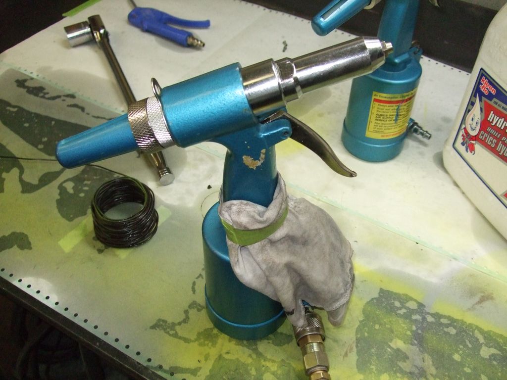

When I first started looking for a rivet puller, I shied away from the gun that
was being offered by Zenith because I had heard from builders on this List, that
there was many instances of cracking in the casings. As a replacement I decided
to go with a gun that was being offered by ACS ( see pic below ) however it is
starting to look like this was not my best decision.
I had difficulty with the setup instructions ( Chinese instructions ) and for
the life of me I still have not been able to get the oil level correct. The
instructions state that the unit should be filled with oil up to the top of the
frame, without showing where exactly what they consider as being the top or the
exact filling level is.
My second mistake was purchasing two guns so as not to have to continually swap
out the two tips. As it stands, when I do get one of the (at)#$%&* things to
work, it won't pull more then a dozen or so rivets, before me being obliged
to open up the air cylinder and start fidgeting with the oil level again.
I am basically a neat person, and I can't live with the constant spewing of
oil out the front, or the back stem catcher, and ending up on my freshly made
parts, or my work table for that matter. I am now in the process of trying to

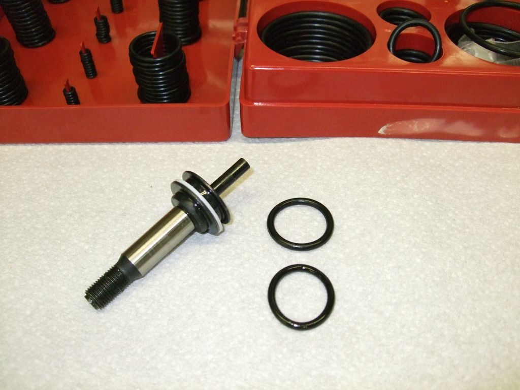

Yesterday evening I was able to find, and correct the problem with my rivet gun. As was mentioned in a previous response, the defect was with the large O-ring on the piston at the top of the handle. it has an O-ring at the rear to seal the oil, and both guns had O-rings that were dried out and hardened.
This is why the gun was quitting after a dozen or so rivets, because the oil was leaking pass the O-ring into the stem catcher. Now it is working great, with no oil leaks.
There was however one casualty in all this and that is my second gun. While I was rebuilding the first one on the bench I casually pulled the trigger to check how far back the piston was pulling, and when it evacuated the air from the lower canister, it blow the spring from my second gun off the bench, and was never to be seen again.
