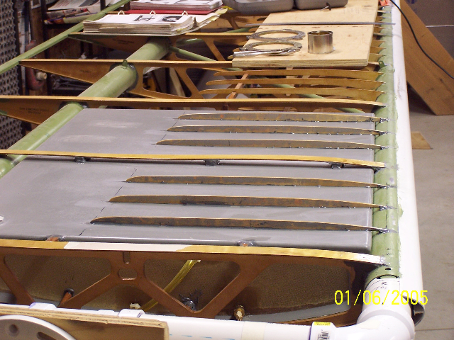

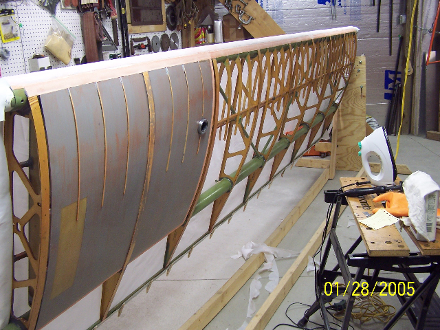

Lloyd-
Here's a shot of my capstrip, and the false ribs I built on both
sides of it. I don't think the manual calls for the false ribs on the
tank, but I figured to keep the same look for the whole wing they
needed to be added. The second shot is of the top false ribs over the
tank. These were 1/8" spruce from the model airplane store.

PostPosted: Sun Jan 04, 2009 11:29 am    Post subject: Wing Repairs Reply with quote
Lynn,
Thanks for the reply.
Now that I like, if I were to open the wing in that area I would definitely
steel you idea and duplicate it.
Lloyd
