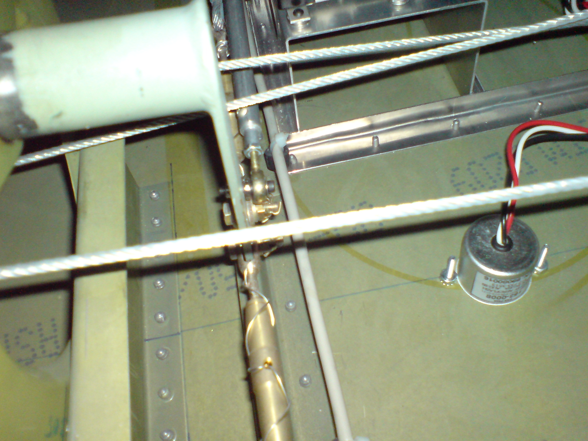

i just would like to point out that i have been several times to the CZAW factory
have a look yourself (www.czaw.cz)
for the material i only can say when the stores where shown to me i did see mostly American spec materials.also they way the planes where build look good to me as the have a proper production line system there.
Workforce has been former LET personal.
all the panels i can see on my xl it seem to be US made panels (print in the alloy)
i think the reason the relationship was terminated was the CZAW Sportscruiser if i would be CH i would be also pi... off
i looked close to it and it is like a development of the 601xl many many similar parts.
the unprimed angle i installed when i installed the AP
if there is a problem with the xl that is for sure not down to the material spec.
my first xl has been weighing 298 kg with bare instruments (no avionics) no wheelcovers, no seats rotax 912s no airbox, no carpets etc, carbon fibre engine cover incl. BRS, no lights strobs etc when the plane is complete with avionics more instruments etc it is about 315kg
