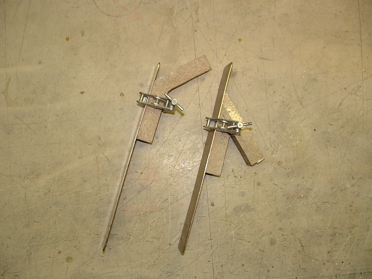

PostPosted: Wed Dec 24, 2008 9:56 am    Post subject: 45 degree angle on the door edge Reply with quote
Ben
Here is was I used, see attached.
The blocks were cut from 3/4" MDF, one for the door and one for the door frame.
The Perma-Grit sanding boards, one coarse & one fine, are clamped to the blocks as needed.
Clean the sanding boards regularly.
Hope this helps.
John
