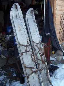

I thought this was interesting. Found them on craigslist this morning.
The wheel sits in a cradle and a strap over the top holds the skis on... would be very easy to use this set up on the snow boards.
