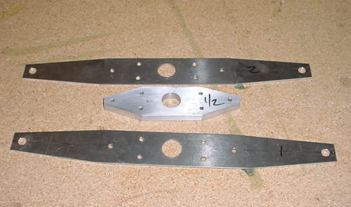

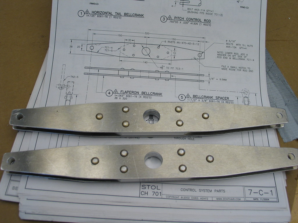

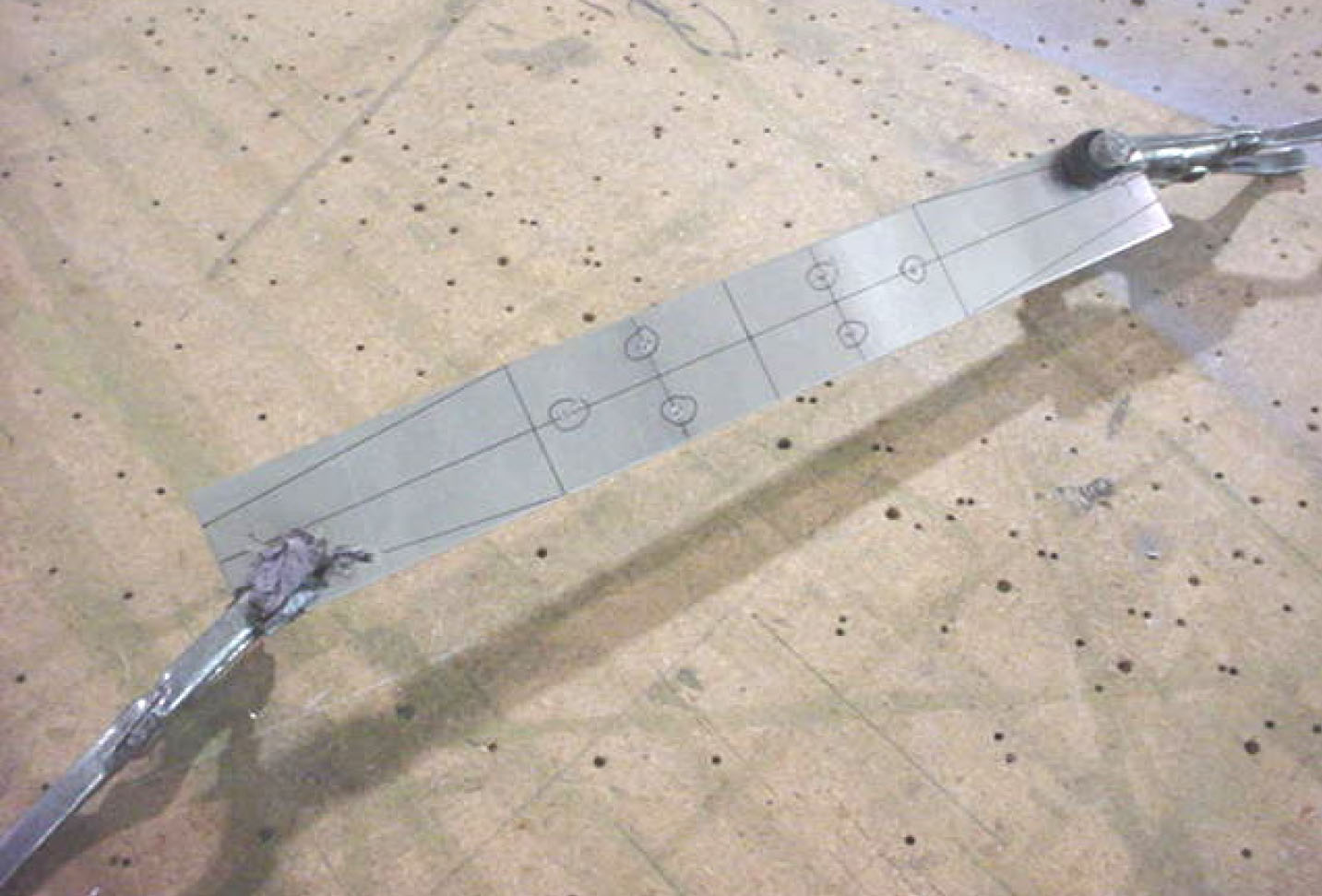

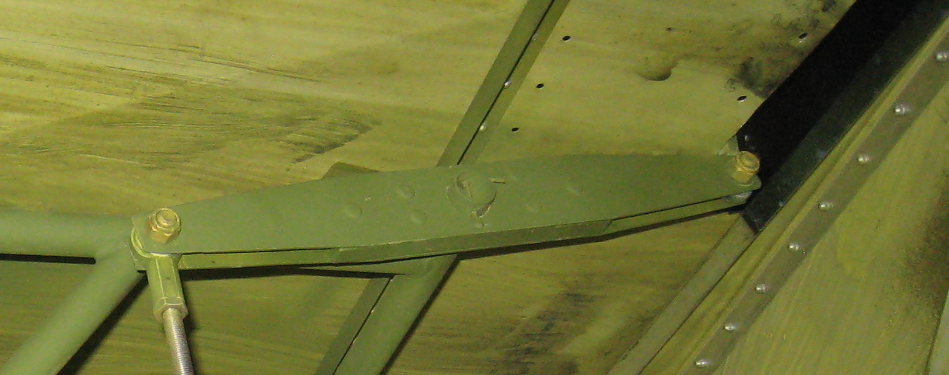

I don’t have exact dimensions but I’ve attached pictures from three different sources. P1 and P2 are from the Zenith photo guide, P3 is of my plane and P4 is of George Race’s. Hope this helps.
