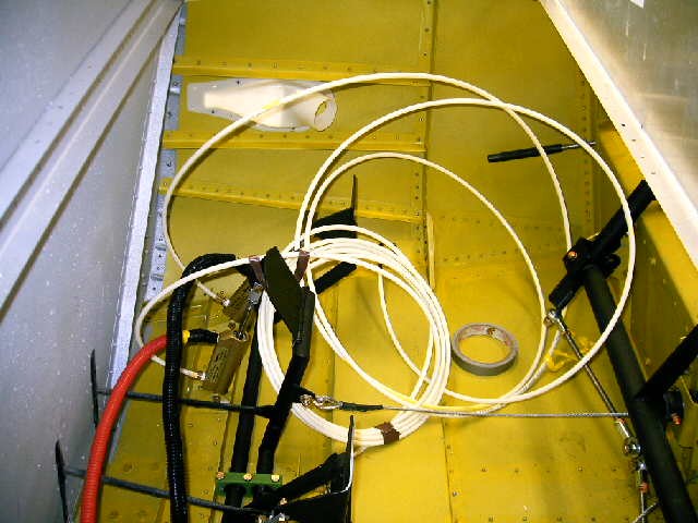

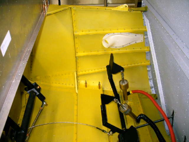

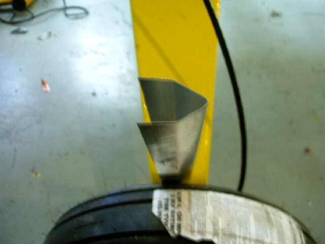

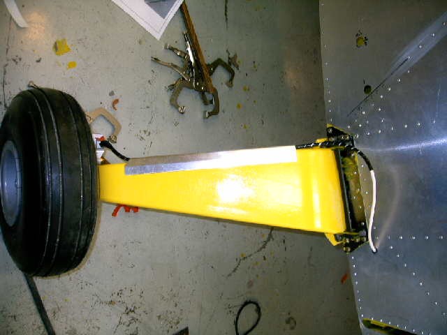

tonyplane(at)bellsouth.ne Guest
Posted: Thu Dec 25, 2008 9:20 am Post subject: Brake Line Anchors |
John,
Attached is how I did mine. I procured the 3M double sided automotive trim tape from the aeroplane parts section of the local WalMart. (I ran the brake lines through the center spar, adel clamped going in and coming out and with ribbed conduit to prevent any chaffing/interference. Grommet through the side skins.
Tony Graziano
Buchanan, Tn
601XL/Jab:N493TG; 454 hrs; 976 landings
