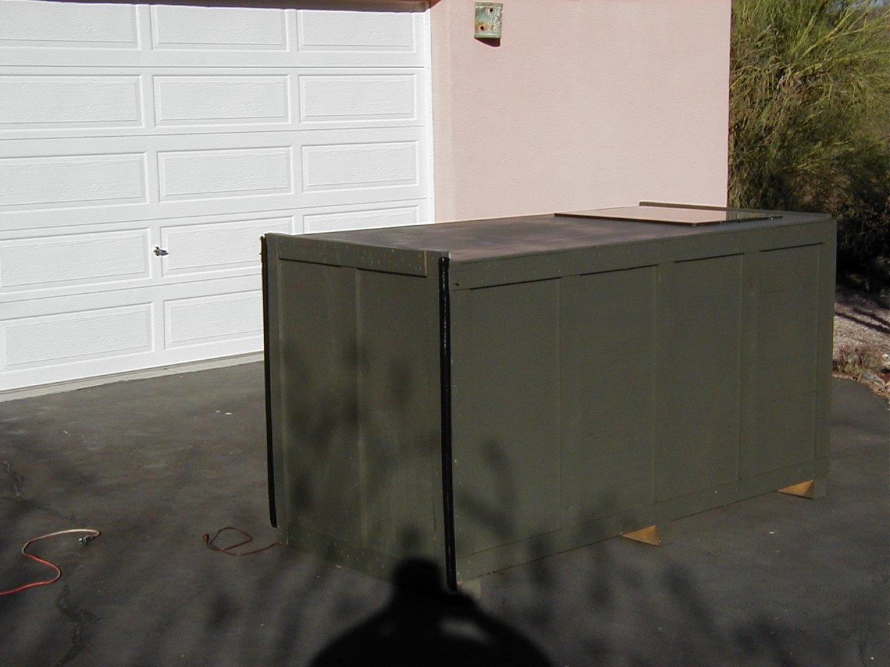

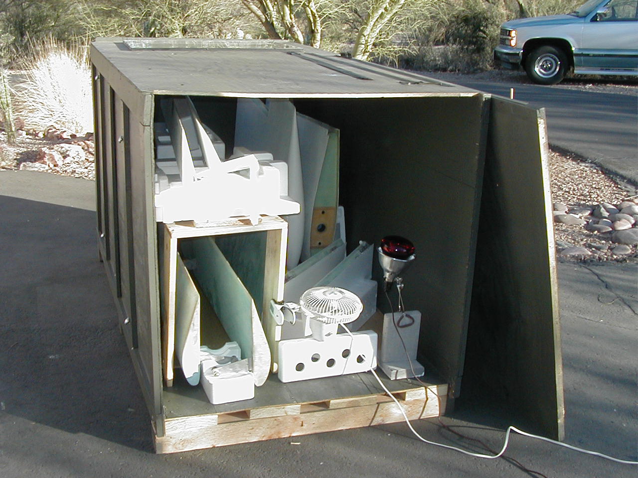

Dear Listers,
A question about post curing our epoxy parts.  Today we built ourselves an "oven" for baking our parts at the appropriate 40-50 degree celsius for post cure.  We built a 16' X 4' X 4' enclosure out of foil claded 4X8 sheets of insulation foam.  The box is backed up to a basement brick fireplace (no open flames) in which I would like to place a suitable heating element.  I also have use of an attic fan to low air around the cavity.
Has anybody attempted this before?  And if so what did you use to heat the space.  I went to a website that helps you calculate the heating requirements for 256 cubic feet of space (at) 50 degrees celsius came to about 8900 btu's, however, heat does build up and I want a consistent heat over a period of hours therefore I will need a thermostat of sorts I would guess.
Any advice out there?  I'm not a  thermo engineer just an individual Europa builder who's looking for an inexpensive way to do the job.
Thank you for your time and consideration.
Cheers and Happy Holidays,
Sincerely,
Jeff  and Peter Paris  Kit# A012 Monowheel Classic

PostPosted: Wed Dec 17, 2008 6:44 pm    Post subject: A question about post curing? Reply with quote
Jeffrey C
Keep it simple. No need for complicated thermostatic control. I used 2 fan heaters plus a larger fan to circulate air. Use a couple of thermometers with remote probes C one for the upper and one for the lower level. Then do it by trial and error: let the heat build up until it reaches the required temperature C the heaters should have multiple heat settings. I had to modify the heaters to bypass the thermostatic safety cutout. Start the job in the morning and monitor it through the day. Position the heaters such that they don't blow directly onto the work pieces.
Karl

PostPosted: Wed Dec 17, 2008 6:51 pm    Post subject: A question about post curing? Reply with quote
Jeffrey C
That oven looks great C but it might have been better to have the foil on the interior.
Karl

ptag.dev(at)tiscali.co.uk
PostPosted: Thu Dec 18, 2008 12:28 am    Post subject: A question about post curing? Reply with quote
Hi! Jeffrey
You won’t be able to imitate my scheme without an insulation lined covered trailer but for what it’s worth I had two 2kw fan/convector heaters with their own thermostats.
But I regularly monitored the enclosed area with a digital thermometer by going into it. Seriously much better to start it early morning and the temperature “climb” and “decent” need to be over long periods to allow the polystyrene to normalize gradually. My trailer allowed me to do all parts including the fuselage simultaneously, the wings and all flying surfaces being cured fully assembled and adequately supported.
I find myself somewhat pleased you have reminded me why I built such an expensive trailer !
IMHO don’t just rely on thermostat control …….don’t trust it take regular readings from different locations.
Bob Harrison G-PTAG
rick.sivier(at)btinternet
PostPosted: Thu Dec 18, 2008 1:24 am    Post subject: A question about post curing? Reply with quote
Hi Jeff and Peter
I used a small fan heater to heat my oven, but with a thermostat from a hot water tank wired into the mains supply.  The thermostat was simply dangled inside the oven somewhere around the middle.  You will need a more accurate thermometer as well to set the temperature on the thermostat and I found that there was a bit of trial and error involved in setting the thermostat correctly.  My thermometer has a max and min display and I found that the temperature varied from 40° to 50°, so the control wasn’t that accurate, but sufficient for these purposes and stopped any potential overheating.
Rick

davidjoyce(at)doctors.org
PostPosted: Thu Dec 18, 2008 2:34 am    Post subject: A question about post curing? Reply with quote

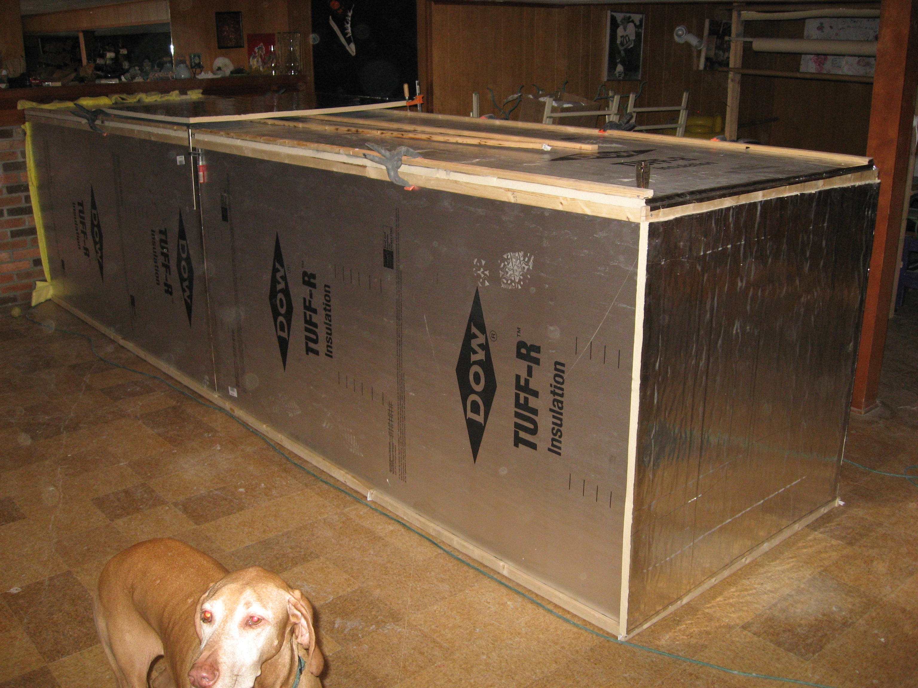

Jeff & Peter, I also built my oven out of 2 in polystyrene insulation blocks
with foil backing. With an XS mine only had to be big enough to take
ailerons, flaps & tail planes. I sealed mine at both ends, except for a
small exit hole at ground level at one end and heated it with a single hair
dryer poked through the foam at the other end. A thermometer poked through
the side wall kept a check on temp. For Ampreg I was aiming at 16 hrs at 50
C, and the system delivered this perfectly. I guess if you have a big enough
system to take complete wings then you might need 2 hairdryers. Don't forget
to support the cooked items generously to discourage them from bending! Best
of luck! David Joyce, G-XSDJ
jeffrey-j-paris(at)excite
PostPosted: Thu Dec 18, 2008 2:34 pm    Post subject: A question about post curing? Reply with quote

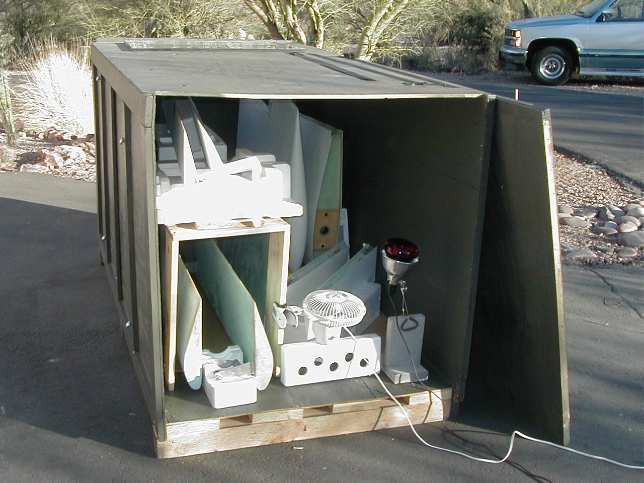

Thanks guys for the response. We went to good old Harbor Freight and picked up a blower fan and a heating element and some 4 dollar temp. probes and we warmed up our oven to 45 degrees C no problem.
All parts are loaded and tomorrow we bake our parts for post curing.
Thanks for the help.
Jeff and Peter Paris Monowheel kit# A012
PS All sides of our oven are foil!

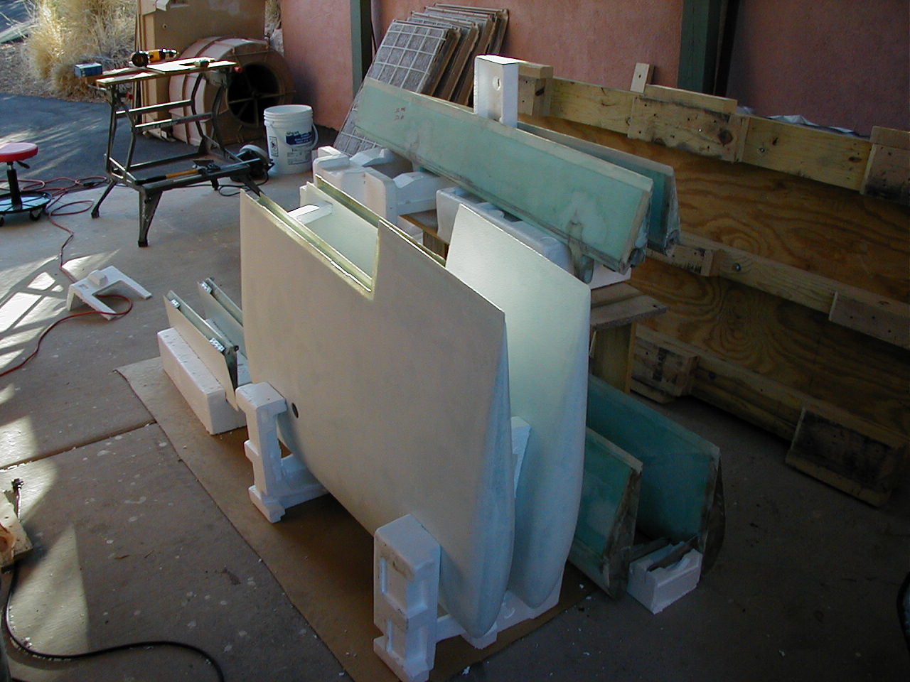

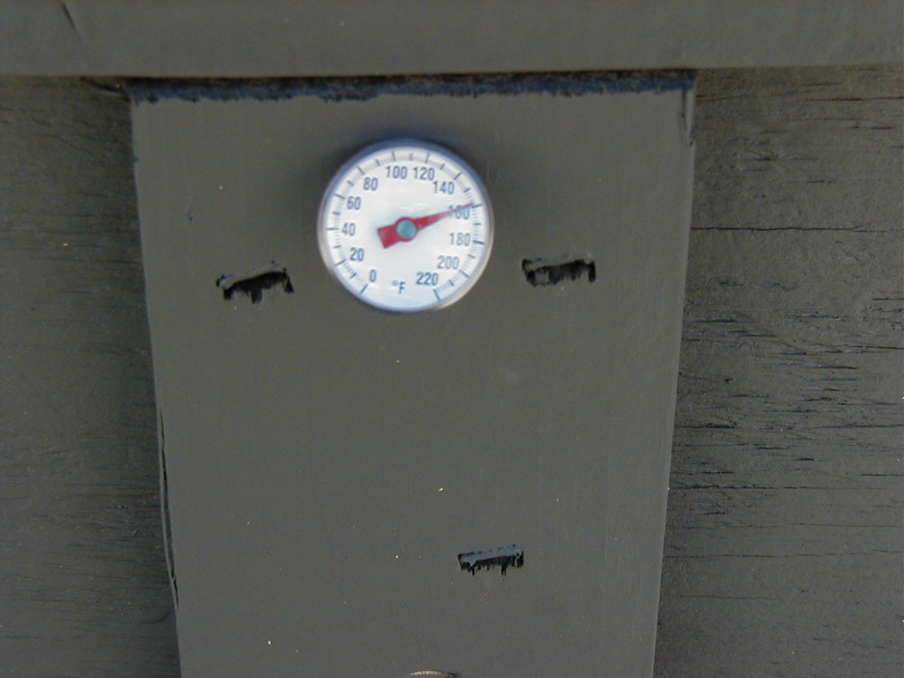

I went solar with mine. Of course, it helps if your in Arizonia in July. I peaked at 160, and held 130 for over 8 hours.
GRoberts A187

Be careful. The surface temperature and the air temperature, even only a couple of millimetres away, can be very different. In motor racing you often see a 10 degree C difference between air and track temperatures.
In the UK I imagine you can easily see a surface temperature of a wing left in the sun being over 40 C. Anyway I cured my surfaces in the open on a hot July couple of days and I'm still here.
Perhaps someone has some accurate figures?

I thought one of the reasons for post cure was also to stop your paint job
from crazing (lots of little micro cracks) which would require post cure of
filler
as well
craig
grahamsingleton(at)btinte
PostPosted: Sat Dec 20, 2008 3:51 pm    Post subject: A question about post curing? Reply with quote
Rowland & Wilma Carson wrote:
Fred - I had my control surfaces etc post-cured in my inspector's oven
before filling. As the epoxy in the filler is not going to contribute
any structural strength, I see no benefit in post-curing it.. Rowland
Rowland
there might be a slight advantage in post curing the filler, it will be
harder. It might also pre shrink it, so sand flatter, and maybe the
weave won't show through after a few months.
Graham
raimo.toivio(at)rwm.fi
PostPosted: Sun Dec 21, 2008 8:43 am    Post subject: A question about post curing? Reply with quote
I postcured whole plane just before painting.
It was 8 hours (at) 50C.
I heated my 200 cubic m shop using 20kW gas heater w fan and one 11 kW electric heater w fan.
I was there all time long just to control temps (it was like very mild sauna).
It was still quite hard experience because those gas burners took all the oxygen away.
Raimo OH-XRT
