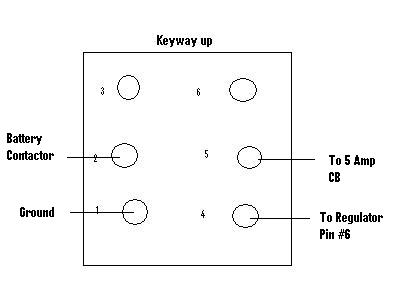

PostPosted: Tue Dec 16, 2008 1:43 pm    Post subject: Master Switch Reply with quote
Bob:
I've attached a jpeg picture of the wiring. With the keyway up, it appears
to me that since terminal #3 & #6 are empty that theOFF position would be
with the toggle in the up position ---the middle position would be BATTERY
ONLY and with the toggle in the down position, BATTERY & ALTERNATOR.
If that is correct, then could I move Ground to terminal 3 and Regulator to
#6, so that the OFF position would be down, or would I be better off to flip
the switch to keyway down?
Sorry for my confusion ?
Henry

PostPosted: Tue Dec 16, 2008 1:55 pm    Post subject: Master Switch Reply with quote
I'm not Bob, but the behavior of every toggle switch I've ever played
with was to 'make' the contacts that were opposite the position of the
toggle. Try to visualize the action inside the switch. The lever passes
through a pivot, so when you move the lever up, it moves the 'guts' of
the switch down. Keyway isn't relevant to this particular issue, except
possibly for a keyed label plate matched to the switch.
(Slide switches are different animals, obviously.)
Charlie

PostPosted: Wed Dec 17, 2008 5:42 am    Post subject: Master Switch Reply with quote
At 04:06 PM 12/16/2008, you wrote:
I always thought that the keyway on any switch should go up. When I completed the wiring of my panel, I found that about a third of the switches were backward. I simply reversed the switches, placing the keyway down. All worked correctly after that.
Jay in Dallas
I'm not aware of any industry-wide conventions for keyway
orientation on switches. The only time it makes a difference
is when you have special features in a switch that are
orientation dependent. For example, and on-off-(on) switch
is spring-loaded from one end of travel to center. If you
want the spring loaded-position to be lower-most in the
installation, then that drives how the switch is installed
irrespective of keyway orientation.
Similarly, if you have a switch with terminal numbers molded
into the rear housing, then wiring in accordance with a diagram
that cites terminal numbers will work correctly only if
keyway orientation for that particular switch is observed.
I have switches in my junkbox with no keyway.
And of course, this would include rocker switches. These
can generally be mounted either orientation but the
switch may not function as anticipated if there are
non-symmetrical features . . . typically terminal
numbering or special tabs like . . .
http://aeroelectric.com/Pictures/Switches/Split_Rocker_Rear.jpg
The keyway is added to many switches to facilitate robust
mounting.
http://aeroelectric.com/Pictures/Switches/Miniature_Toggle_w-Full_Size_Handle.jpg
The keyway is engaged by the often supplied tab-washer
to prevent the switch body from rotating on the mounting
due to torque applied by wires to the back or operator
from the front.
--> AeroElectric-List message posted by: Charlie England <ceengland(at)bellsouth.net (ceengland(at)bellsouth.net) >
I'm not Bob, but the behavior of every toggle switch I've ever played with was to 'make' the contacts that were opposite the position of the toggle. Try to visualize the action inside the switch. The lever passes through a pivot, so when you move the lever up, it moves the 'guts' of the switch down.
Yes. Here's a couple of shots that illustrate Charlie's
explanation.
http://aeroelectric.com/Pictures/Switches/Carling_Cutaway.jpg
http://aeroelectric.com/Pictures/Switches/Toggle_Switch_with_Mold-Captured_Terminals.jpg
Keyway isn't relevant to this particular issue, except possibly for a keyed label plate matched to the switch.
http://aeroelectric.com/Pictures/Switches/On-Off_Plate.jpg
Henry Trzeciakowski wrote:
> Bob:
You originally cited a 2TL series switch which
I presume is a Honeywell-Microswitch product. I've
illustrated the Miocroswitch convention for terminal
numbering at . . .
http://aeroelectric.com/articles/Progressive-Xfr_Split-Rocker_Switches.pdf
Now, as it turns out, the folks at Carling seem to
have adopted the Honeywell-Microswitch convention
for terminal numbers a couple of years ago. Bottom
line is that you MIGHT need to deduce how YOUR
particular switch functions. Quite often, you can
glean operational information from the manufacturer's
catalogs. I have a sampling of such documents on
the website at . . .
http://aeroelectric.com/Mfgr_Data.html
So for individual who read this posting now or in
the future, be aware that not all switches with
interchangeable functionality are labeled or keyed
the same way. So if the thing doesn't work the way
you want it to, the simplest solution is to get out
the ohmmeter and figure it out.

I have always been a proponent of the keyway-down school of thought. The reason being, that a small splash of water or rain would stay in the keyway, or drain inward perhaps, if the keyway were facing up. (I also presume toggle up is ON and down is OFF.) There must be a patent on the keyway in the late 1800's or some mil-spec but I can't find it.
NKK sells little ON/OFF switch plates for use with keyed bushings and they seem to agree with my described system. I have seen many of these little plates and they mostly seem to agree. But I am sure you can get the opposite kind, too.
On a related subject. The little "face" on US 120 VAC outlets: By NEC code, the little "face" is oriented so that U-ground connection is the last to exit the socket when a power cord is pulled out of it. This is judged by height usually (but not always). The high sockets have the U-ground "nose" down whilst low mounted sockets have the U-ground "nose" up.
