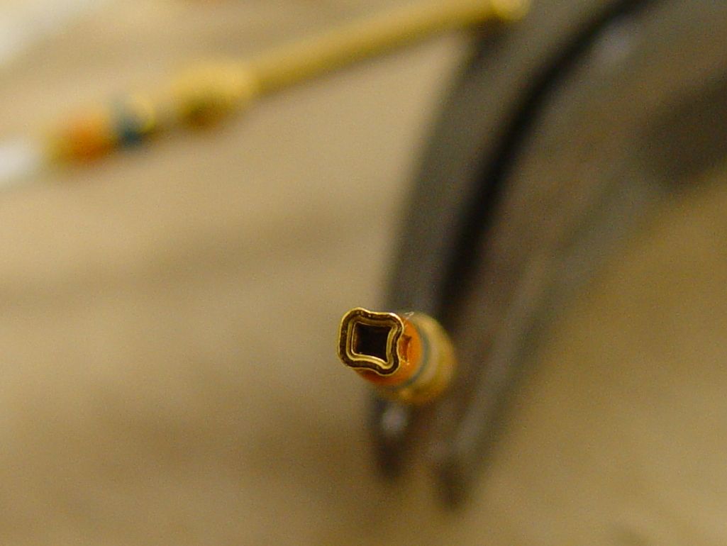

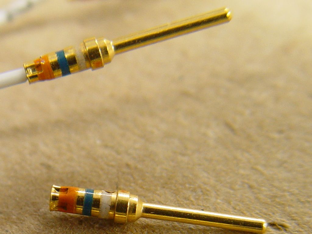

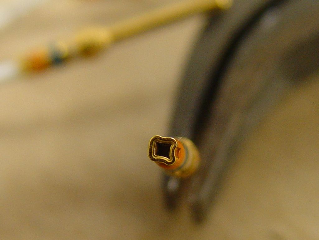

I think I have several problems and oversights that need to be addressed.
I'm using a tool that looks like this:
http://aeroelectric.com/Pictures/Tools/Crimp_Tools/rct-3.jpg
As you said, it is setup for one size of wire and one type of
pin/socket. I've been using it on 20AWG and probably 22 AWG which
would immediately indicate some inconsistency. But in this case, I was
using it on 24AWG wires that was part of a pre-made harness pig tail.
In addition, I was trying to strip the wire just far enough to barely
clear or be flush with the pin. Given that this crimper seems to crimp
concentrically at the the very tip of the pin, allowing any of the
insulation into the pin could further compromise the crimp. (I'm
attaching 2 pics of the pin that failed).
I first need to determine what size wire the crimper is setup for and
limit its use to that wire. And re-confirm I'm using the right pins
(non-high density).
For this particular connection involving the 24AWG wires, I'm going to
follow your guidance on using a 9 pin D-sum with solder terminals along
with shrink tubing, clear adhesive and more shrink tubing. It's a good
solution for this particular connection.
I'll have to take a closer look at the adjustable Daniels crimper if I
want to get serious... but it may be too expensive to justify.
What do you think?

Insulation can touch the pin but the wires need to be
inserted a minimum depth as observed through the inspection
hole. My installations have a pretty good gap between
end of pin and insulation when the strands are fully
inserted on the pin.

Bill Schlatterer
Posts: 195
PostPosted: Thu Dec 11, 2008 6:52 pm    Post subject: Crimping of machined D-sub pins with 4-Way Indent Pin Cri Reply with quote
I used this crimper and D-Subs on my full panel with no problems but it is
not made to do 24 gauge wire. For that you need to double up the wire and
it will work fine. Assuming you are using 20-22g wire and pins this tool
works nicely.
One other caution is that with this tool you NEVER double crimp a fitting.
If you partially crimp one and then crimp again, you run the risk of taking
the normal 4 point crimp and making it into an 8 point buzz saw for the
wire. While you can carefully position a partially crimped terminal in the
jaws and crimp again, it is very likely to cut some or all of the stains in
the wire if not perfectly repositioned. If you want to try it just crimp a
wire, then rotate it 45 degrees and crimp again. Most likely, the wire will
easily break right at the terminal.
The trick with this tool is to strip the wire correctly and then hold the
pin in the tool with the wire inserted. Pressure on the wire keeps the pin
in the right place in the tool. Then make one smooth firm crimp and leave it
alone.
Hope this helps.
