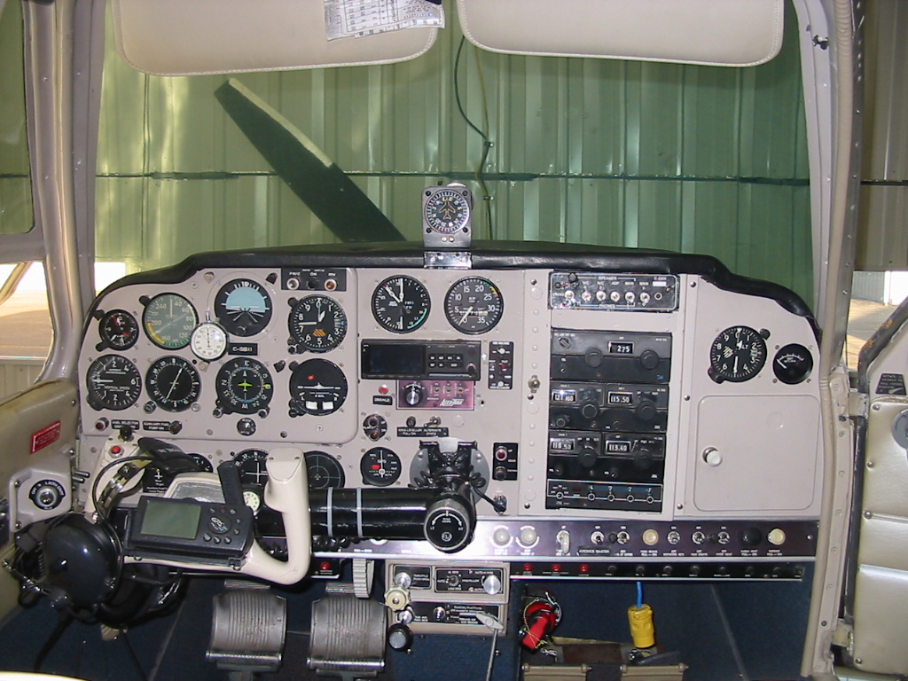

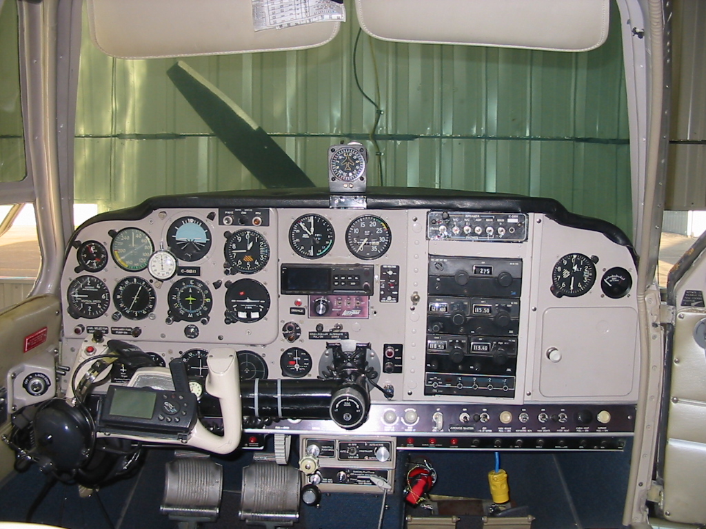

I am replacing the fixed cowl vents on my 64 35B33 (Debonair) with bonanza cowl flaps. I have all the parts and the cowl flaps are in place etc. I am not sure where the cowl flap control is positioned on the instrument panel. I would very much appreciate a description or picture of the cowl flap control placement from an owner with a 35N /33E or newer bonanza. Thanks in advance

The cowl flap control goes to the left of the flap switch. It can just be seen in the attached picture. I have some cowl flap parts if you need any.
