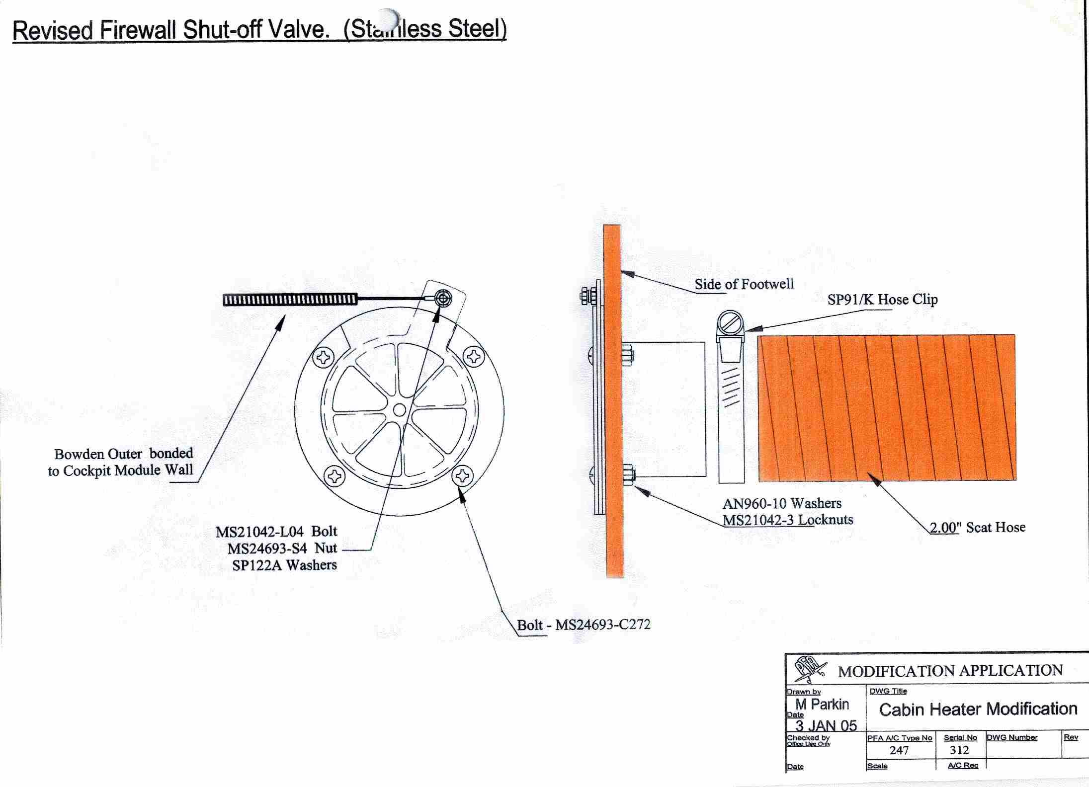

To those, in the UK, interested in installing the "air-scoop-behind-coolant-radiator" type of cabin heater (a la Bud Yerly / Dave Andersen / Paul McAllister / Mike Parkin), the UK LAA requires steel, firewall-shut-off-valve(s), to reduce the risk of fire / smoke ingress into the cabin.
Mike Parkin devised a very elegant, stainless steel daisy wheel valve (See <Cabin Heat MP.jpg, attached), which gained LAA approval as part of his aircraft-specific installation. However, it was expensive (in time or money) to produce, especially as a one-off.
I have simplified Mike's design slightly and gained the LAA's (informal) approval that it is acceptable.
The pertinent design aspects are: (Rough sketch attached - <Firewall Shut off valve.pdf>).
- Laser cut from 1.5 mm stainless steel
- Sized to match the Aircraft Spruce aluminium flanges for 2-inch Scat hose.
- Use of sleeves (2-3 mm long) under the heads of two of the mounting bolts, as the "end stops" for the rotating wheel.
- A 1.5 mm overlap at each edge of the "petals" when the valve is closed.
- The "valves" are opened and closed by Bowden cable.
The method of installing is illustrated in the Mike Parkin drawing <Cabin Heat MP.jpg>
