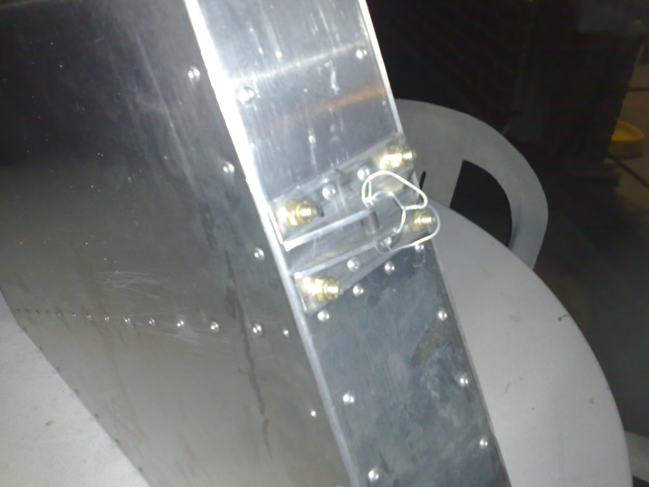

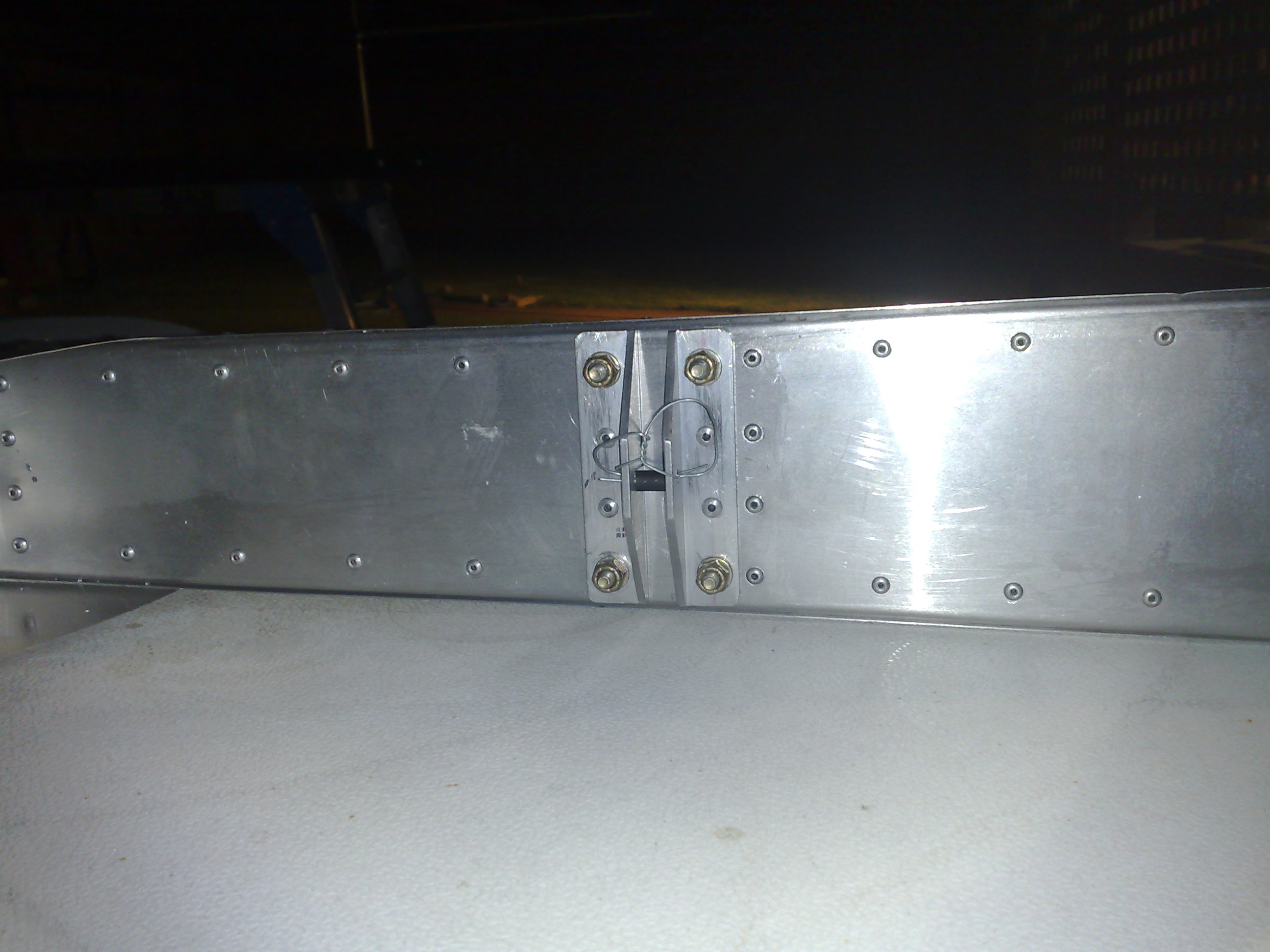

I have used small bolts instead of the outer two rivets. Some plains were having a problem with the hinge becoming loose over time. If you can not get the rivet gun onto the rivet you can get a puller that has the sides ground back. Most tool suppliers will have these. Yes i did wait until i was able to fit the rudder to the fuselage before fitting the top hinges.
Hope this helps you out
Ianrat
Bolted top rudder hinges
