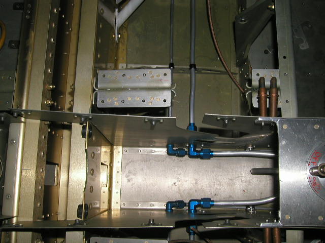

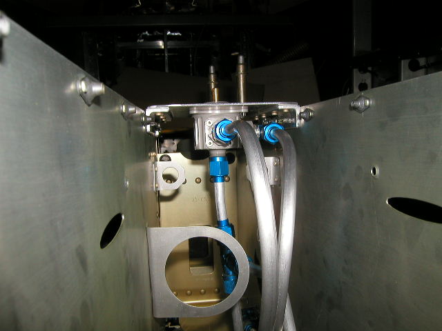

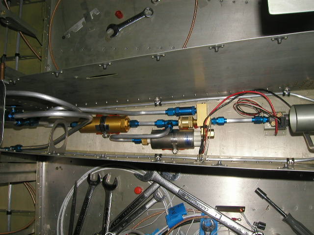

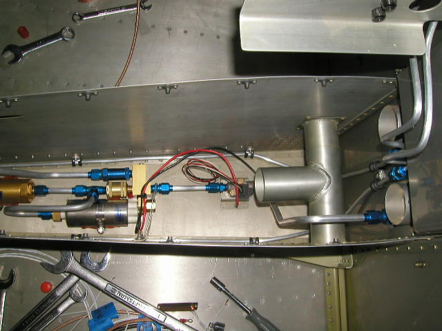

Using the Vans supplied Andair valve. The elbow for the left tank was
shortened .25" on the pipe thread side and oriented forward; also bulkhead
fittings were installed at tunnel entrance. There is adequate clearance for
the rear heat tubing and the rudder cables. wiring to be routed along the
bottom of the tunnel. selected cables will be wrapped with nylon spiral wrap
to avoid any potential chaffing.
