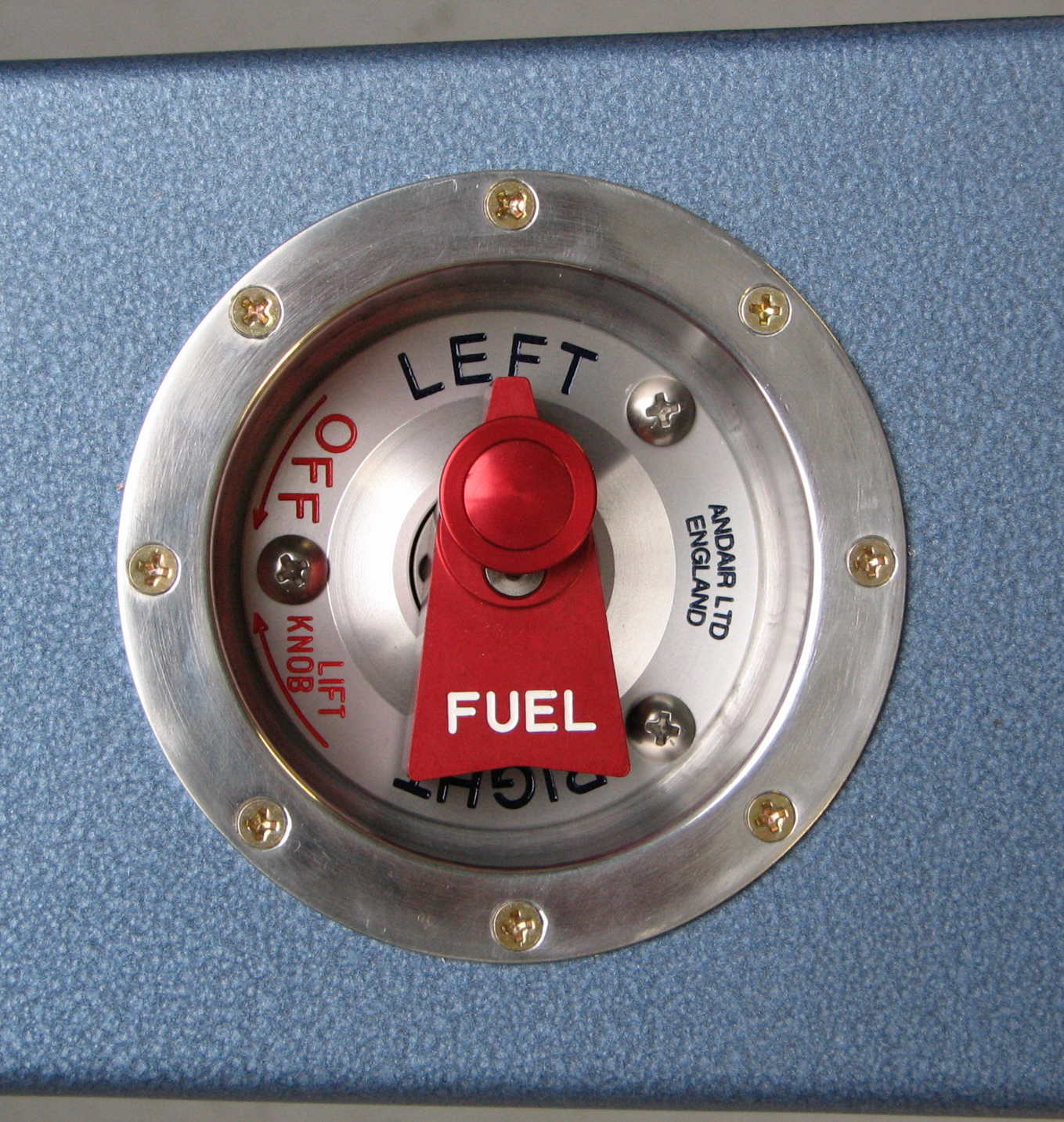

I'm installing my Andair Valve under a plate at the top of the
tunnel... essentially the same location as Vans intended for their
valve except flush to the tunnel cover. I'm routing the scat tube
under the valve and between the fuel lines. I'll cut a hole in the
tunnel cover to the size of the Indicator Plate so the cover can be
removed without disturbing the valve.
For those with a similar installation (I think Deems may be one),
what type of screw are you using to attach the Indicator Plate,
through the mounting plate and valve and into the K1000-3 nutplates?
Do you have a spec to save me some hunting around?

I used #8 screws and nut plates. I had to order a another valve with the extension to fit my console installation. The original valve I bought is for sale if any one is interested -- http://www.nwacaptain.com/4sale.html

I ended up using some stainless steel hex head screws (Ace Hdware),
mostly because I couldn't readily get any of the Phillips button head
screws long enough.

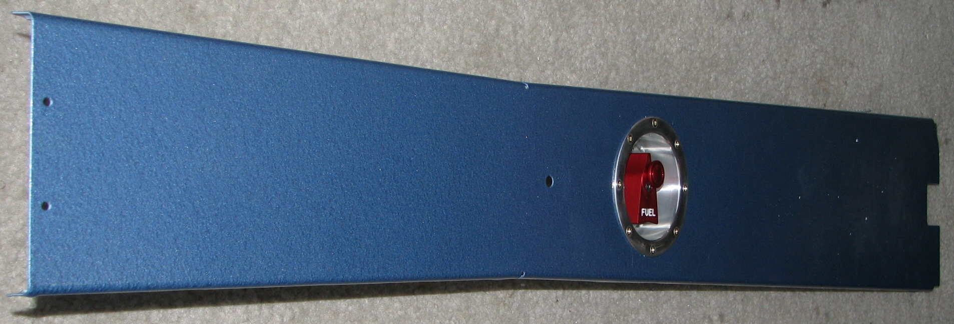

Here's what I did... and we made enough pieces to weld up 10. I finished the install, and it looks great. Routing of the scat was easy. Used Van's bridge to support a connector. Will take pics tomorrow.
Don McDonald
#40536

Also, where I mounted mine was 5" forward of the Van's valve location. Moving it forward not only got it further out of the way, but the tunnel is wider and the valve fits perfectly in the center... of course, being recessed also created more room.
Don McDonald.

robin1(at)mrmoisture.com Guest
Posted: Mon Dec 08, 2008 8:01 pm Post subject: Andair Valve Installation |
Don,
That application looks really nice! If you have any more of those metal cups you can use them to hold your beer.
We cut up an Cleveland wheel disk that was hanging around and mounted the valve in the center of the cup.
Robin
Don McDonald

Don't need em' for that... I bought some of those A&W cup holders..... you know... ya just roll down the window and hang em'.

you might consider segmenting the tunnel cover; it makes it very easy to inspect beneath without a lot of disassembly

We have since that photo was taken.
