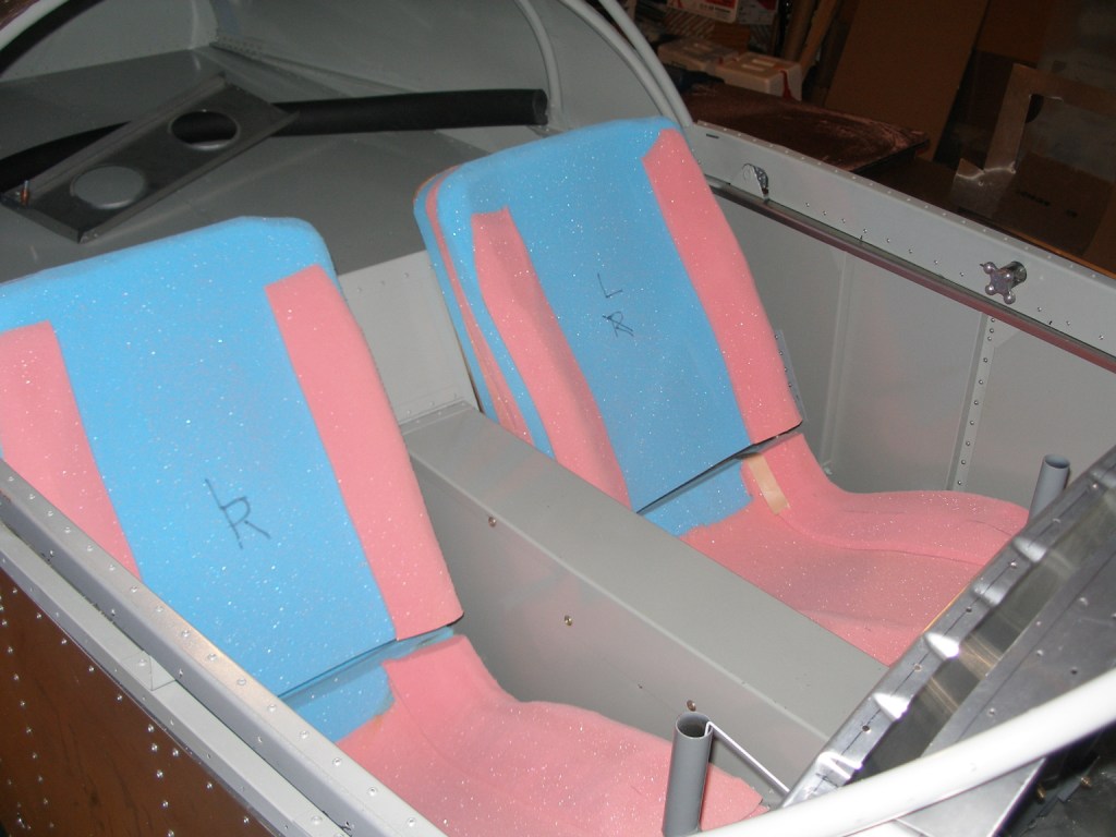

PostPosted: Fri Dec 05, 2008 7:13 am    Post subject: Re: Seat Foam Reply with quote

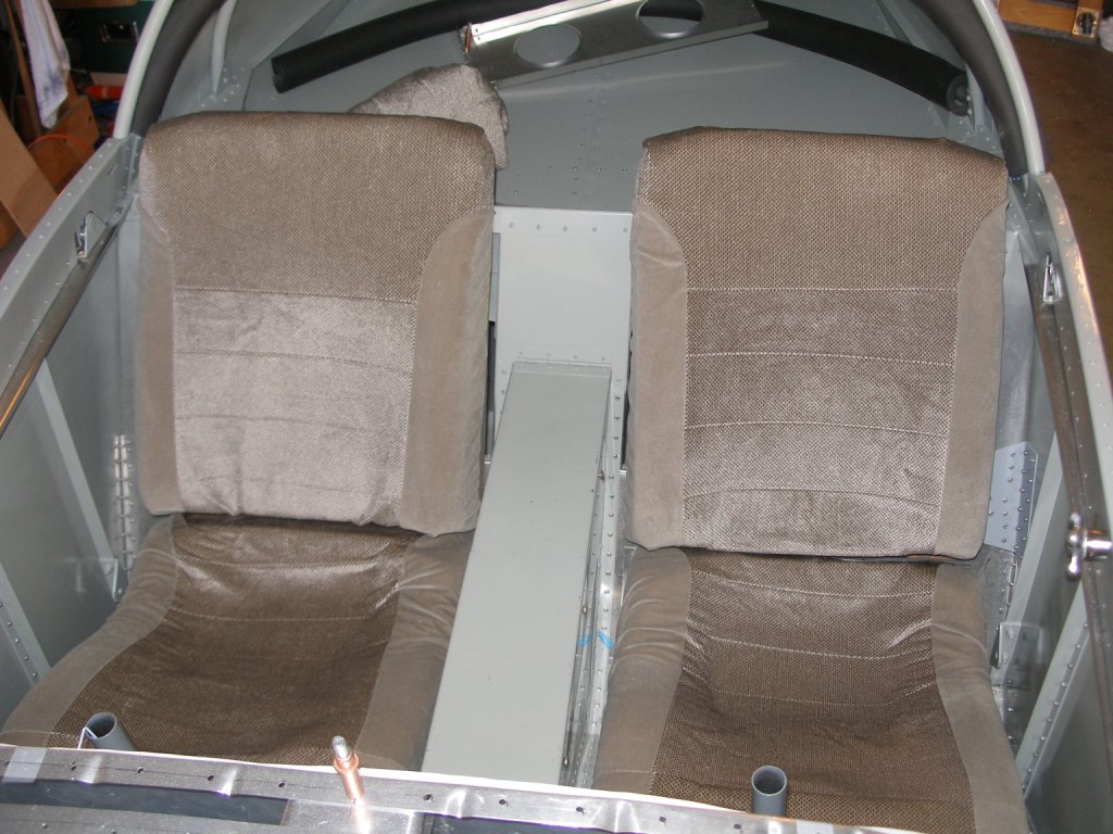

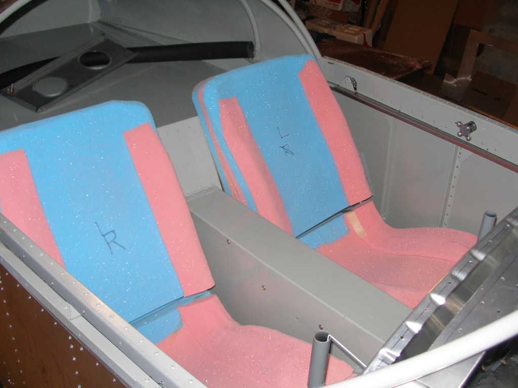

Rich,
I would have liked to have gotten off cheaper, but I really wanted memory foam. I spent around $230 for the foam on both my seats. I bought like 5 each of the blue and green (firm and firmer) from Wicks. I bought a king sized memory foam mattress topper from Wal-Mart for the soft stuff. If I had to do it again, I would not use the really hard green foam and use all blue for the support portions. I like it even when it is cold. After a few minutes it warms up and I sink right down into it.
Good luck,

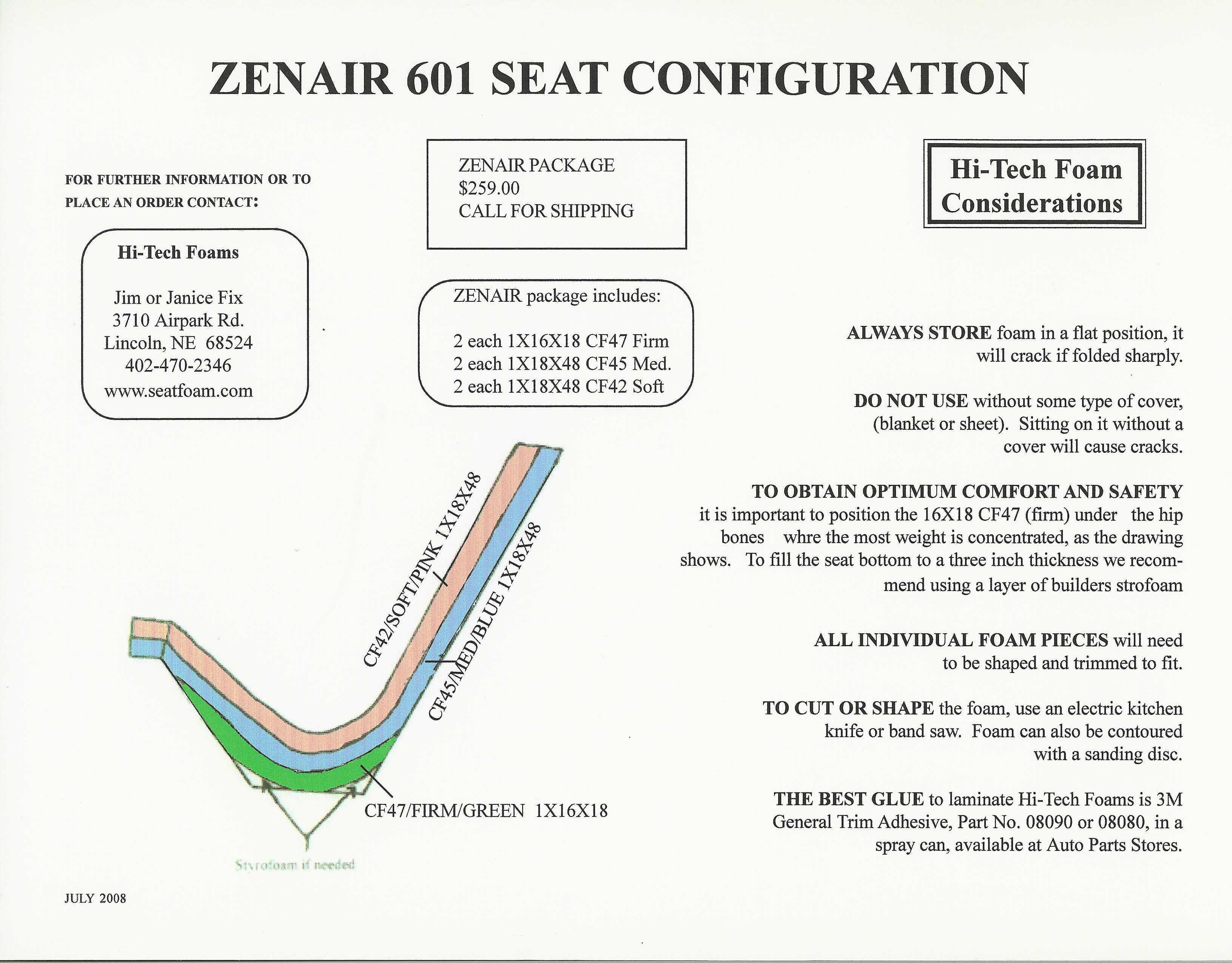

PostPosted: Fri Dec 05, 2008 8:32 am    Post subject: Re: Seat Foam Reply with quote
When I called a couple of months ago Hi-Tech Foams quoted me $259 +shipping for their 601 package.
I've attached the flyer they sent.

PostPosted: Fri Dec 05, 2008 8:54 am    Post subject: Seat Foam Reply with quote
The design shown in the flyer is a good place to start, but I would
recommend making the seat backs and seat bottoms as separate
assemblies for easier removal and handling. Then you can flip the seat
backs forward out of the way for access behind the seat without
worrying about cracking the foam in cold weather.

PostPosted: Fri Dec 05, 2008 9:49 am    Post subject: Re: Seat Foam Reply with quote
That is exactly what I plan to do. I also ordered an extra piece of the soft softer foam for an arm rest and to add lumbar supports.
This thread reminded me I needed to order and did this morning. And the price is still the same.

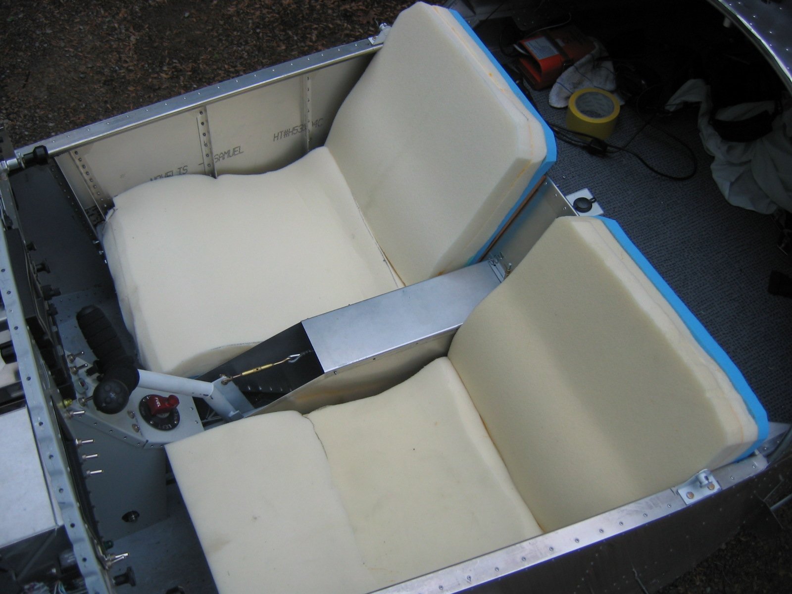

DaveG601XL wrote:
Rich,
I would have liked to have gotten of cheaper, but I really wanted memory foam. I spent around $230 for the foam on both my seats. I bought like 5 each of the blue and green (firm and firmer) from Wicks. I bought a king sized memory foam mattress topper from Wal-Mart for the soft stuff. If I had to do it again, I would not use the really hard green foam and use all blue for the support portions. I like it even when it is cold. After a few minutes it warms up and I sink right down into it.
Good luck,
David Gallagher
601 XL/Jabiru 3300
First flight 7/24/08

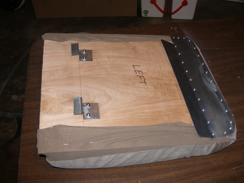

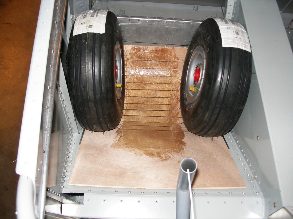

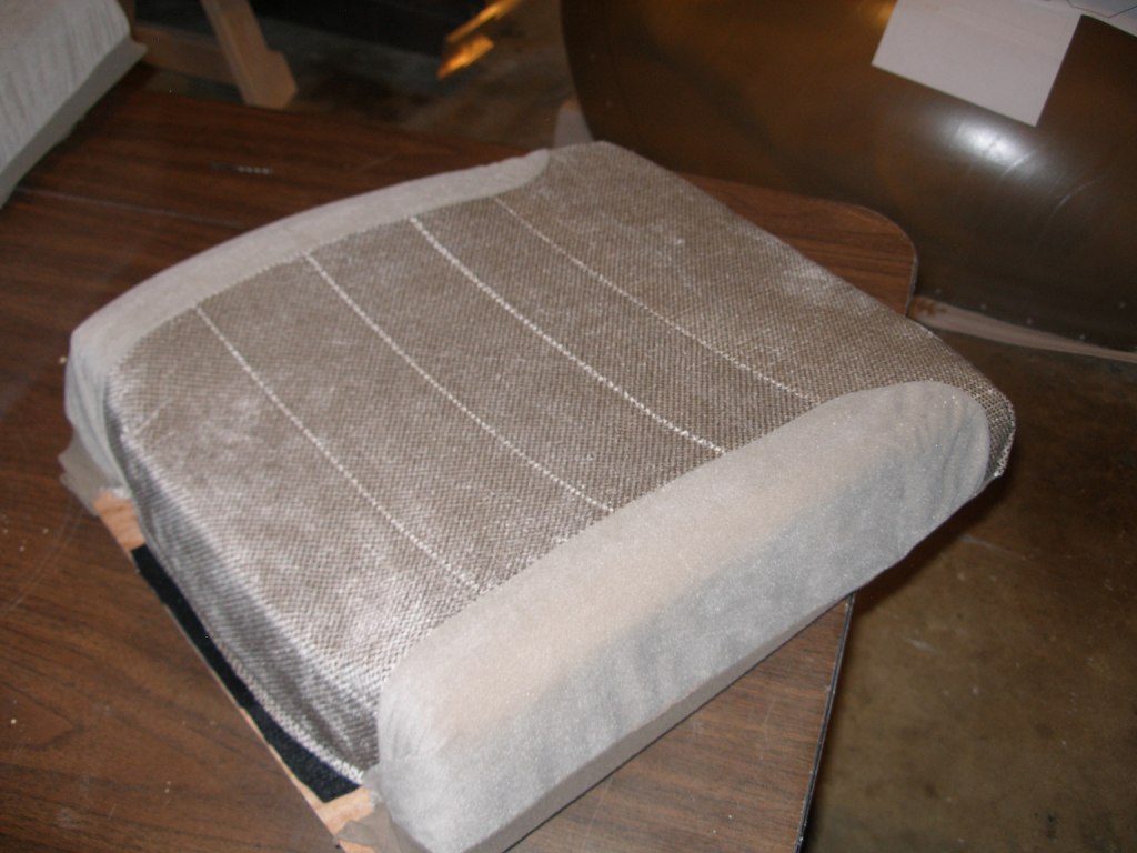

PostPosted: Sun Dec 07, 2008 6:12 am    Post subject: Seat Foam Reply with quote
I didn't use the ACS pads, but here is how I made mine fit the bottom seat pan. I kerfed a piece of 1/4" plywood, pressed it down in the seat pan and filled the kerfs with epoxy. When the epoxy dried, the plywood retained the shape of the pan. Then I glued the foam to the plywood. The seat covers are from Pep Boys.
Jay in Dallas

PostPosted: Sun Dec 07, 2008 7:34 am    Post subject: Seat Foam Reply with quote
Jay-
Uh, I always thought the tires were supposed to go on the OUTSIDE of the plane.
You know I'm kidding- good ideas.
