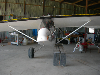

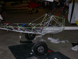

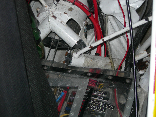

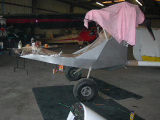

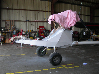

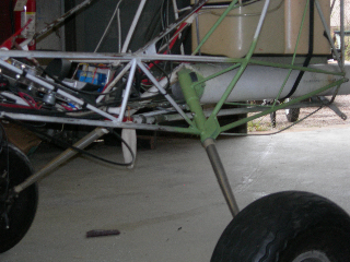

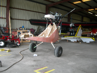

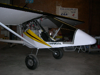

Broke my plane in September with a hard landing. Sheared off the left
gearleg socket where the aluminum gearleg ends. Got the welding done
at an FAA Repair Station shop because I have no welding experience at
all. I did everything else with a little help on painting from my
local flying buddies. Finished it over Thanksgiving weekend. It turned
out nice, big thanks to Danny Still in Angleton TX for teaching me to
finish paint. Here are some pics:

Joined: 09 Jan 2006 Posts: 4639 Location: Titus, Alabama (hauck's holler)
Posted: Fri Dec 05, 2008 5:31 pm Post subject: fixed my screw up |
| Quote: | gearleg socket where the aluminum gearleg ends. >
Jimmy Young
Jimmy:
I did that in 1988 to my FS.
During the repairs, we developed 4130 gear legs, extending them all the way
in the socket until they bottomed out at the intersection of the two
sockets. Never had another gear leg shear the socket again, although there
have been many hard landings since then.
Old Kolb designed the system that way. It saved weight and material. It
also created a weak gear leg socket.

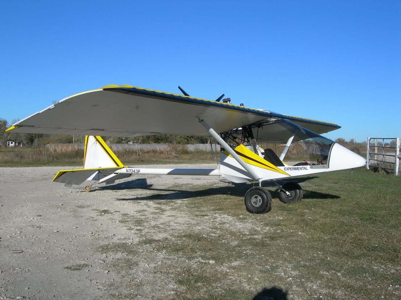

Jimmy Young
Joined: 24 Nov 2007 Posts: 182 Location: Missouri City, TX
Posted: Sat Dec 06, 2008 4:00 am Post subject: fixed my screw up |
John H wrote:
| Quote: | >>During the repairs, we developed 4130 gear legs, extending them all the way
sockets. Never had another gear leg shear the socket again<<John,I have read most of the archives on the 4130 gearleg topic. I also read Larry Cottrell's posts along the same subject. Since I already had one brand new alum leg, I just ordered one more to save a little time.Changing out to 4130 gearlegs may be the next project in line right behind building an enclosed canopy. I've missed 3 months of the best flying weather here in the Houston area, and those open sides get pretty chilly.I did get another photo taken outside I wanted to share. I know no one is more interested than me in it, but sorry, I feel like a proud papa showing pictures of his new baby!Jimmy YFS II, Angleton TX [img]cid:34AF4C72-7A8A-4590-951E-62DFFA9522B6(at)hsd1.tx.comcast.net.[/img] |

slyck(at)frontiernet.net Guest
Posted: Sat Dec 06, 2008 7:28 am Post subject: fixed my screw up |
Jimmy, I think it looks great. Doing a nice job yields pride of ownership that an "out of the box"owner will never have. Let us know what you think of those fat tires after flying it for a while.
Posted: Sat Dec 06, 2008 11:07 am Post subject: fixed my screw up |
Jimmy Y:
I don't think I did a very good job of explaining my most important point of my last msg. Old Kold designed the gear legs to end at the midpoint of the socket, the weakest point of the socket. That is why it sheared when you landed a little hard.
Didn't take rocket science to figure out pushing the leg all the way into the socket until it bottomed out would spread the load through out the entire socket, instead of concentrating it at the midpoint which is weakest. Acts like a shear.
