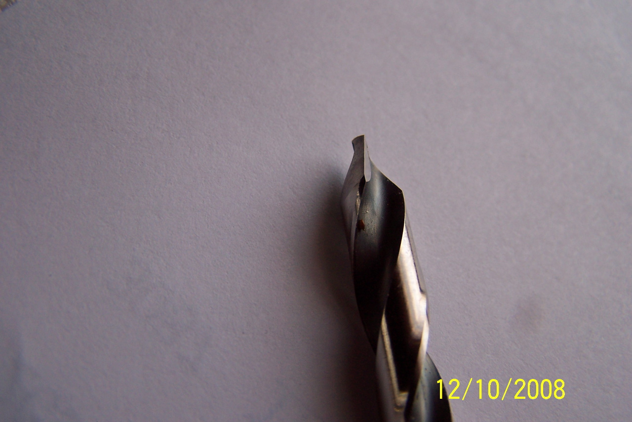

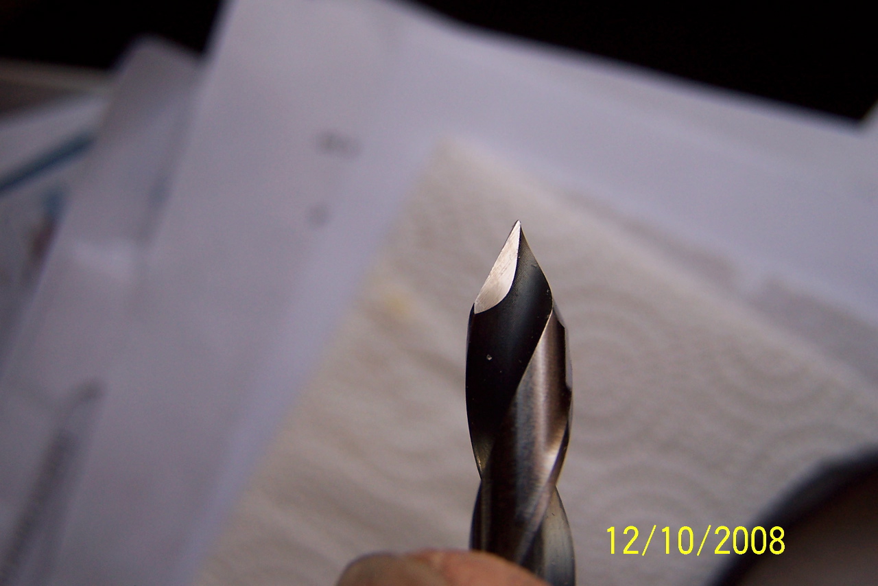

PostPosted: Wed Dec 10, 2008 10:55 am    Post subject: Acrylic Drill Bits Reply with quote
I just checked mine, Gary, and the included angle is 54°...pretty
steep compared to the normal 118° angle of a drill bit for steel.
Also, the cutting edge needs to be flattened so that it does not cut
into the material, but scrapes it instead. Here are a couple of
pictures of the ones I got from LP Aeroplastics.
Lynn
