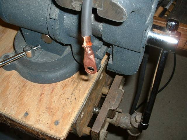

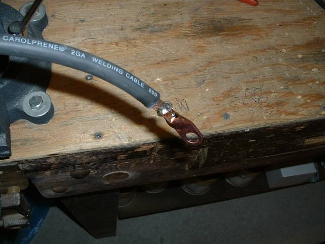

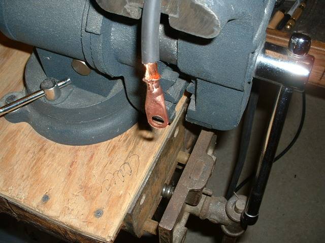

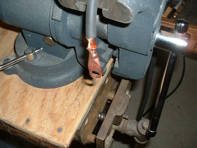

1. Crimp the terminal using your NicoPress tool. (Tony Graziano).
2. Solder the connection using rosin core and a low flame from a propane torch. (Jay Bannister).

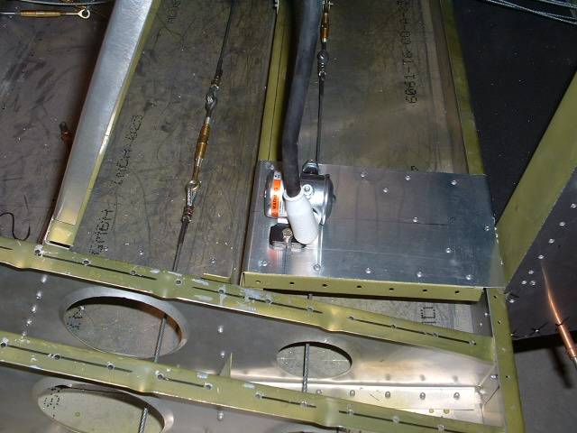

3. Cover the joint using the appropriate ACS boot. (William Wynne).
Looks like a factory job, doesn't it?
