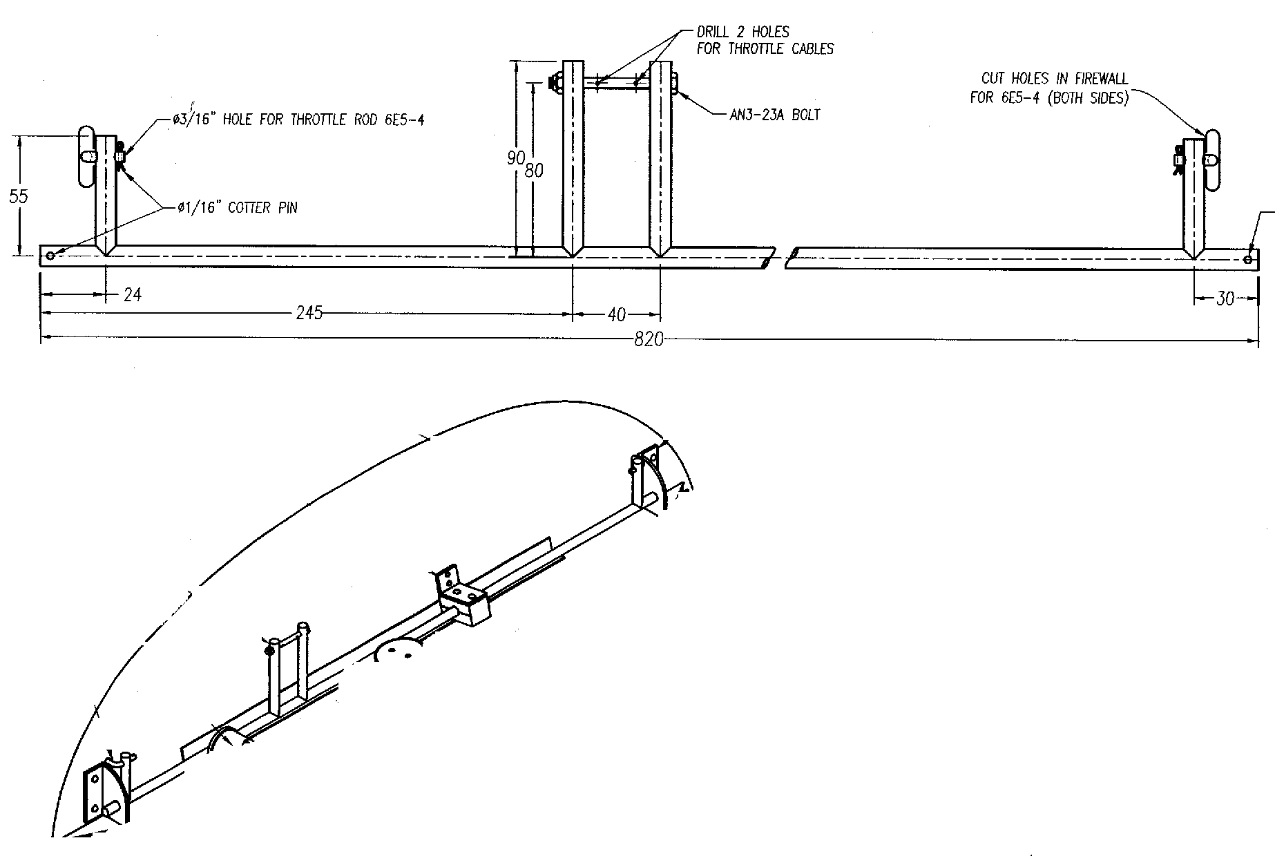

99.99% of the listers who responded to my posts have no idea what I've been talking about. Attached is the section from my HDS manual- THE BIG ROD ASSEMBLY THAT GOES OVER THE HORIZONTAL FIREWALL BRACE! WHERE DO YOU POSITION THE UPRIGHTS TO ACCOMMODATE AN MA3-SPA?? The cable for an MA3 comes from the right side of the centerline looking at the firewall from the front. That's why I'm thinking I can just swap this drawing end for end.
Sorry for the use of caps- I'm not mad, just frustrated.
Thanks.
Bill Naumuk
Townville, Pa.

  I believe the drawing you show is the arrangement for a Rotax with dual bing carbs & dual throttle.
If you wish to use this arrangement then far as I can see you can weld the bell crank uprights at any position you wish on the drive shaft provided it clears equipment on your particular engine arrangement the height of the bell crank uprights may require adjusting to give the correct travel to what ever you drive the carb with.
We used a single throttle & Idle cut-off sold by aircraft spruce similar to those fitted to C152s to directly operate the carb. they are a belden type cable with solid cores the throttle knob A800 has a friction lock & idle cut off A790 has a lock release knob & vernier control
In the Rotax arangement the carbs are opened by a spring pulling on the belden cables from the bell crank, there is no idle cutoff but a choke is fitted.

Yes, it's for a Rotax. Since there's only a single carb, the distance between the uprights can be less, and the MA3 favors the opposite side of the centerline.
I never thought about the height, but that can be adjusted at the last minute.
It would seem the throttle proper would need a minimum of cable for my set up, if any at all. Also, a vernier would only be practical on the pilot's side.
People might think I'm spending an inordinate amount of time getting the best information I can for the cockpit layout, but I just, and I mean JUST was able to clear my battery cable when reattaching the header tank straps for fit. I also had my battery cable neatly tucked up under the left upper longeron using cable ties and had to remove one. I didn't have the access to get my panel on and off any more. I'm sure all the flying listers will agree- a minor lapse in panel layout will result in big trouble down the line.
