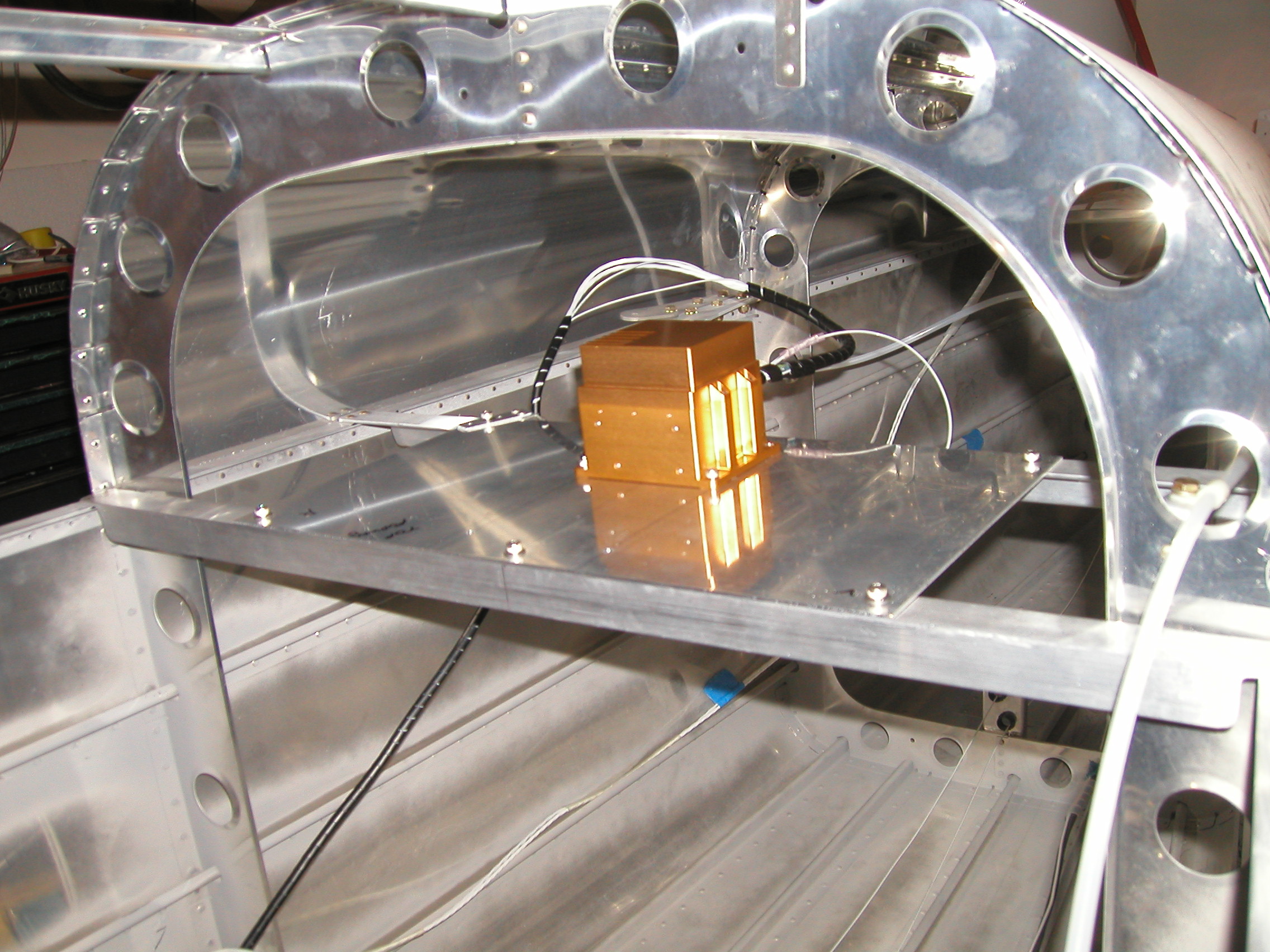

I went with the Chelton which has the magnetometer integral to the AHRS; However my suggestion is a platform in the rear and mount it next to the AHRS. It makes alignment on/parallel to the axis easy.
 Filesize:  827.67 KB
 Viewed:  621 Time(s)
