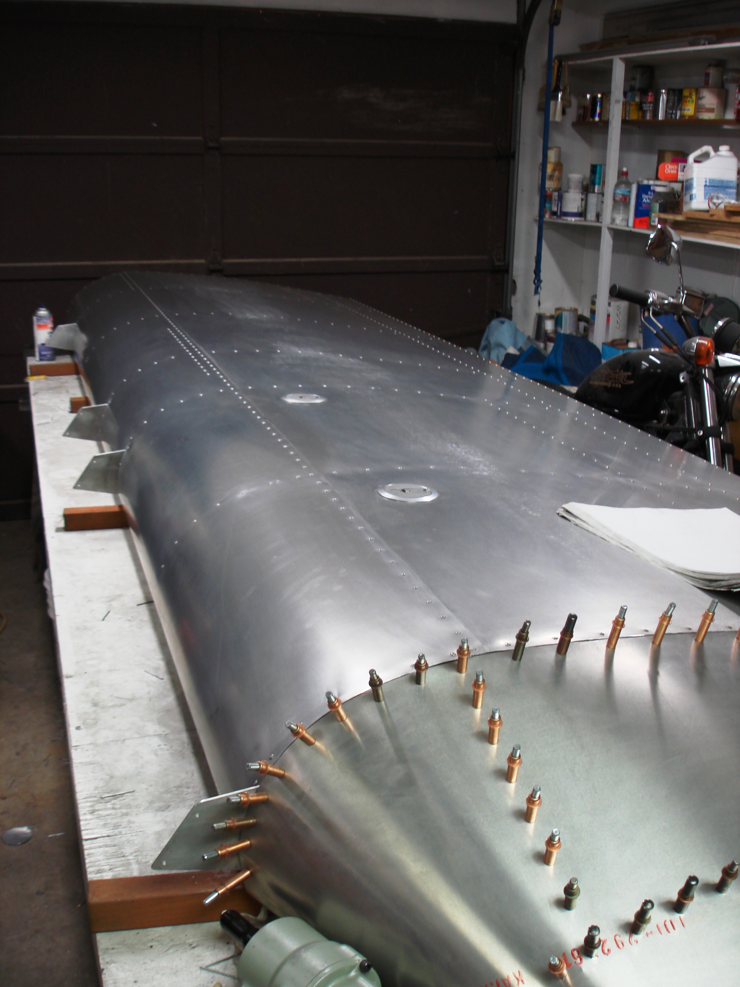

Vic,
Here is a picture of the caps I put in my wings.
Is this what you had in mind?

Great job Brady, could you provide some more info about the installation. What type of caps and where did you get them? How do they attach to the fuel tank? How did you attach them to the skin? Anything you can provide would be of great help as I have wanted to make this mod for a while but just haven’t gotten there yet. So it looked like now is the time.

Vic & Rick, Smile
The Caps are the same ones the 601 boys use. I got them from Aircraft spruce # 05-28666.
To get the flange to sit flush with the skins I had to adjust the angle of the threaded bung that is welded into the tank. Because I welded my own tanks and I knew I wanted flush caps from the out set, I just welded them in at the correct angle.
I don't think this would be an easy retro fit. Smile

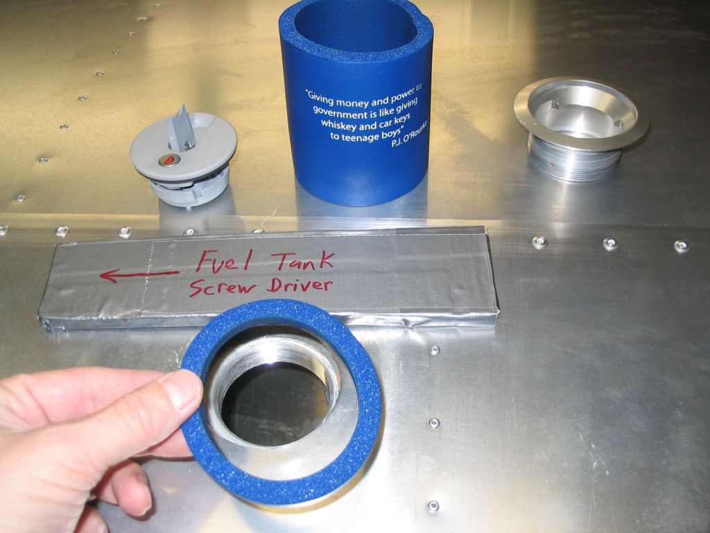

To keep the skin tight to the flange I put a piece of soft foam (like a sponge) between the skin & the tank to evenly hold it up and then just screwed the cap flange down over it.

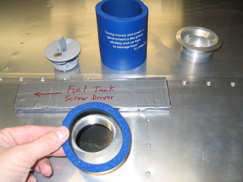

One 601XL builder (Patrick W.) used the foam sleeves you put around a beer
can to support the skin around the neck.

My only question about the beer can insulator is if the foam rubber
disintegrates in contact with fuel.

I had considered that the gas may melt the foam as well so I seated the flanges in a compound call 3M 5200 which (from what I understand) was developed by 3M for Boeing.
This stuff is common to boat builders and has the reputation for being very tenacious stuff.
I have used it extensively in the marine industry and I have seen it De laminate the best of composite layups on dis assembly.
there is a liquid anti adhesive that allows you to un-glue it but it is slow and expensive.
I have found that a hot putty knife is best used to cut the bond.
I have not seen how it reacts to long term exposure to gasoline but that's why we call it experimental. Smile

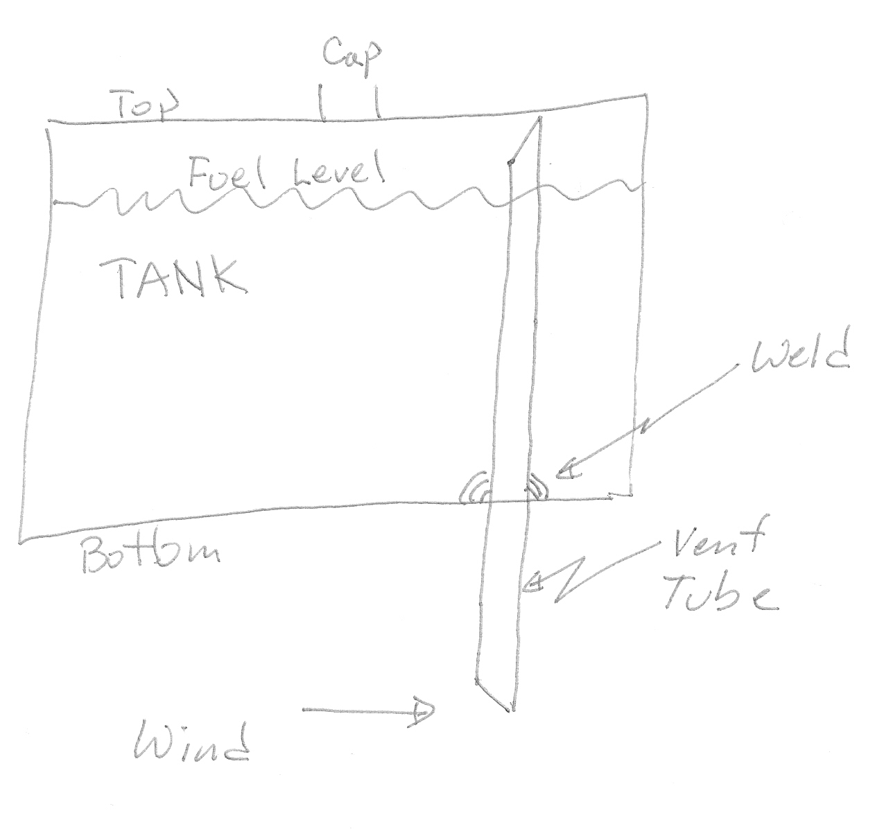

raymondj(at)frontiernet.n
PostPosted: Sat Nov 29, 2008 9:12 pm    Post subject: Flush fuel caps Reply with quote
Greetings,
I'm not familiar with the way Cessna vents their tanks. Can you refer
me to a diagram?

I'm still looking for a diagram for the physical setup of the vent. I
can't visualize the way it was described.
Raymond Julian
Kettle River, MN

Curt.Thompson(at)verizon.
PostPosted: Sat Nov 29, 2008 10:36 pm    Post subject: Flush fuel caps Reply with quote
Here is a sketch of what I think Brady was writing about.
Curt
 Filesize:  108.06 KB
 Viewed:  826 Time(s)

PostPosted: Sun Nov 30, 2008 2:07 am    Post subject: Re: Flush fuel caps Reply with quote
That's it !
Exactly! Very Happy
Except the vent is as far forward in the tank as possible because they are taller in the front.
The low side of the fuel cap is a bit farther aft so you can never fill the tank all the way to the very top. so unless you had over full tanks and were in a severe nose down attitude fuel should not leak out the vent. (other than slosh)
PostPosted: Sun Nov 30, 2008 3:53 am    Post subject: Flush fuel caps Reply with quote
Thank you very much, now I understand. Looks like a good simple system.
Thanks again Curt and Brady.
