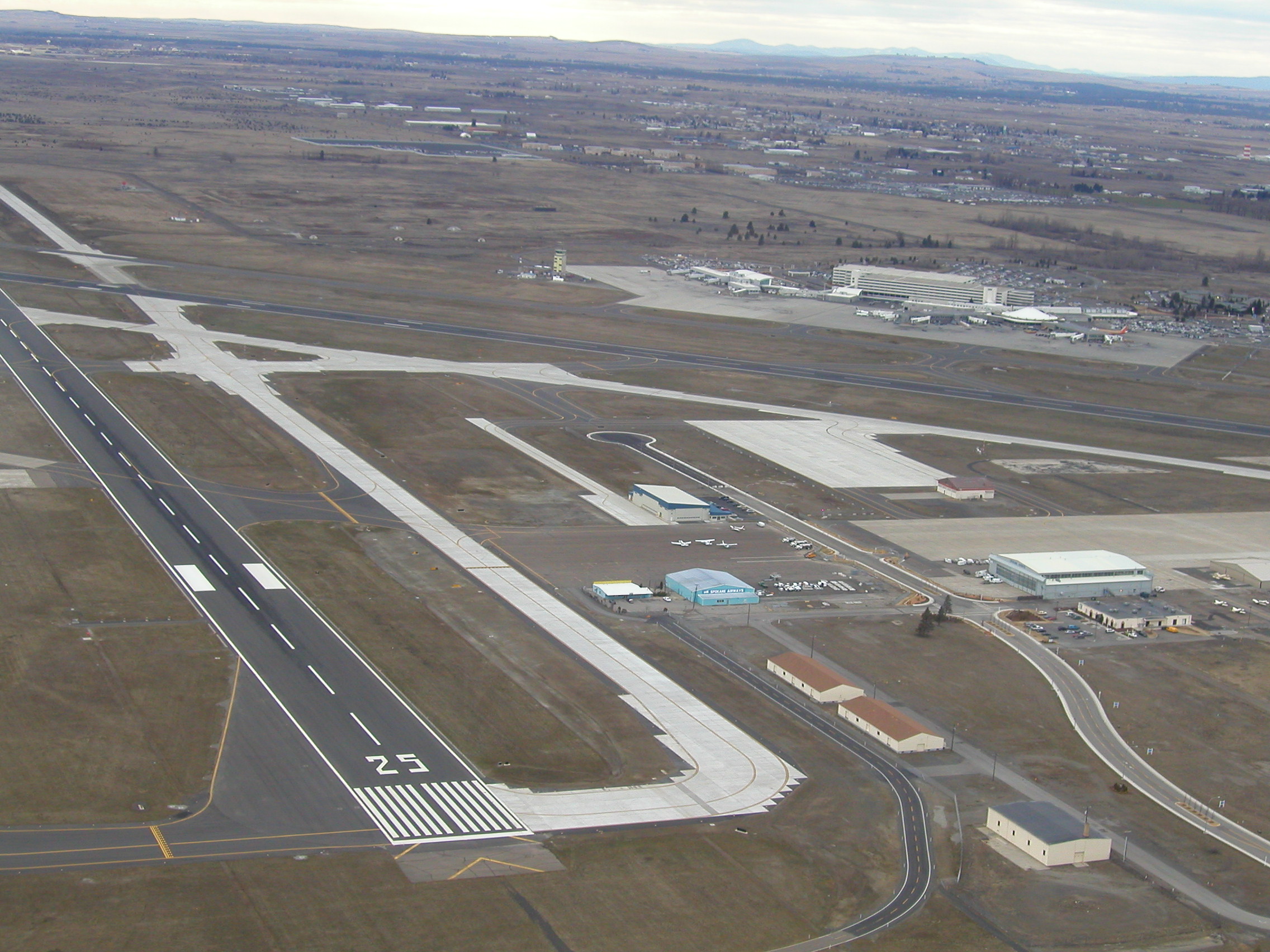

no, a farm house about 15mi south. I'll get a pic of felts when I can and post. want to see spokane international, here you go.

Excuse me . . .the fifth picture you have posted is no farm house. Must be
GEG?
