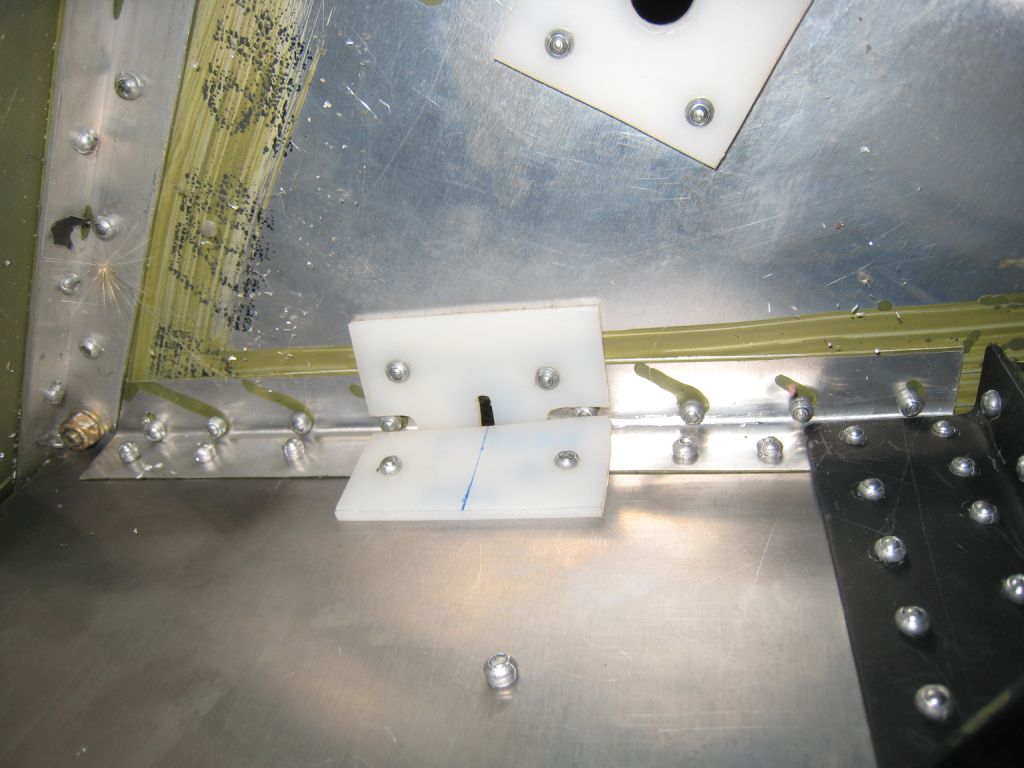

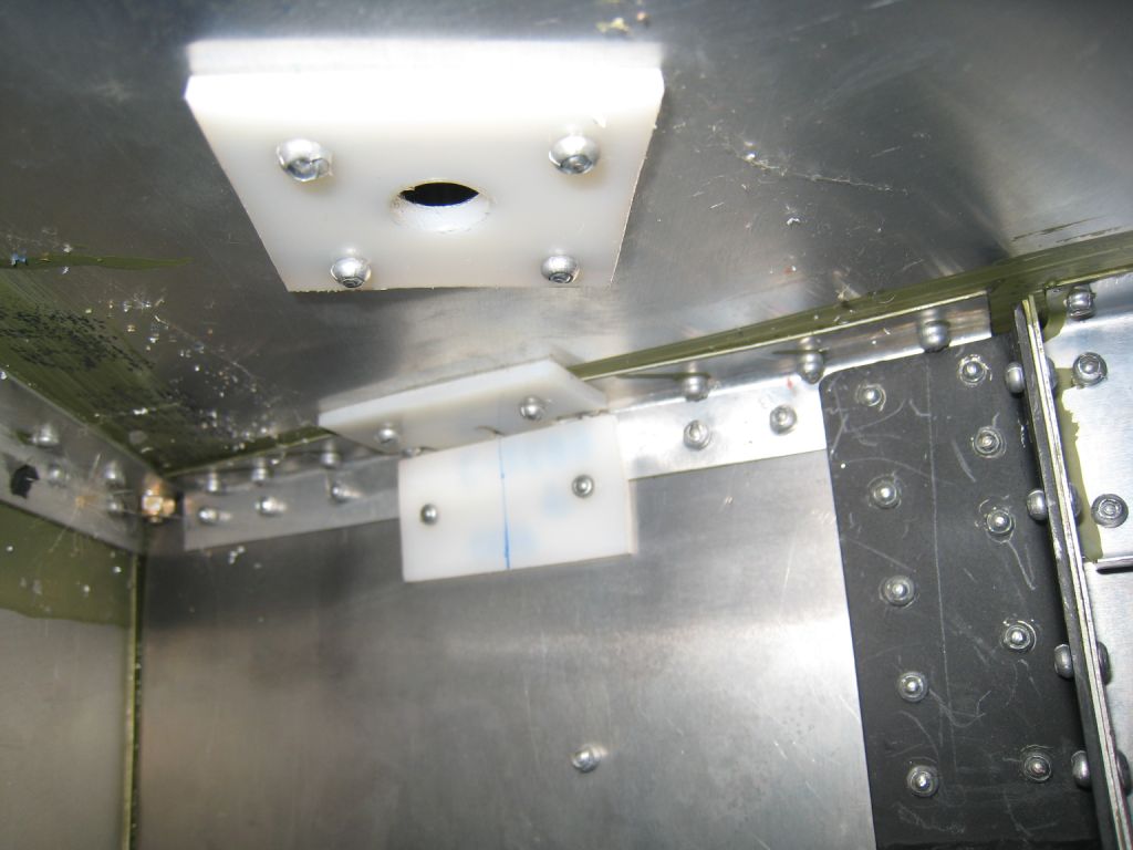

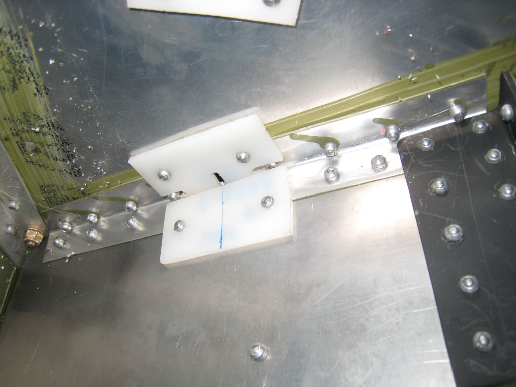

craig(at)craigandjean.com Guest
Posted: Tue Nov 25, 2008 8:23 pm Post subject: 601XL Aileron Balance Fairleads |
I’m not certain the attached photos will help. But this is how my Oct-2007 vintage quick-build-kit was done.
-- Craig

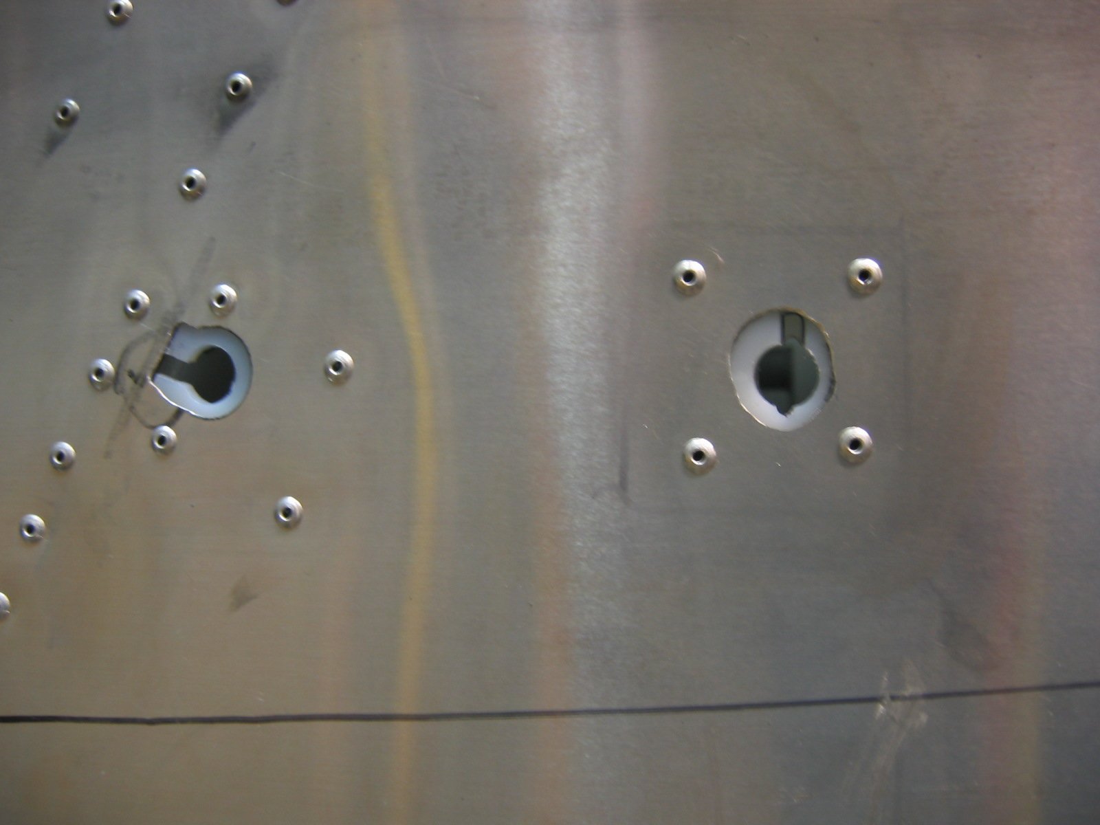

DaveG601XL
Joined: 27 Oct 2006 Posts: 351 Location: Cincinnati, Oh
Posted: Wed Nov 26, 2008 6:20 am Post subject: Re: 601XL Aileron Balance Fairleads |
Like Craig's pictures show, ZAC has changed the way they do quick builds, but the plans don't seem to have changed to match. I talked to Roger about the change and the larger hole on the aileron fairlead is meant to allow the entire turnbuckle to be passed through. I don't know why the balance cable does not mimic it. I took the large hole idea and applied it to both cables. Attached is a picture of my fuselage.
Hope this helps,
