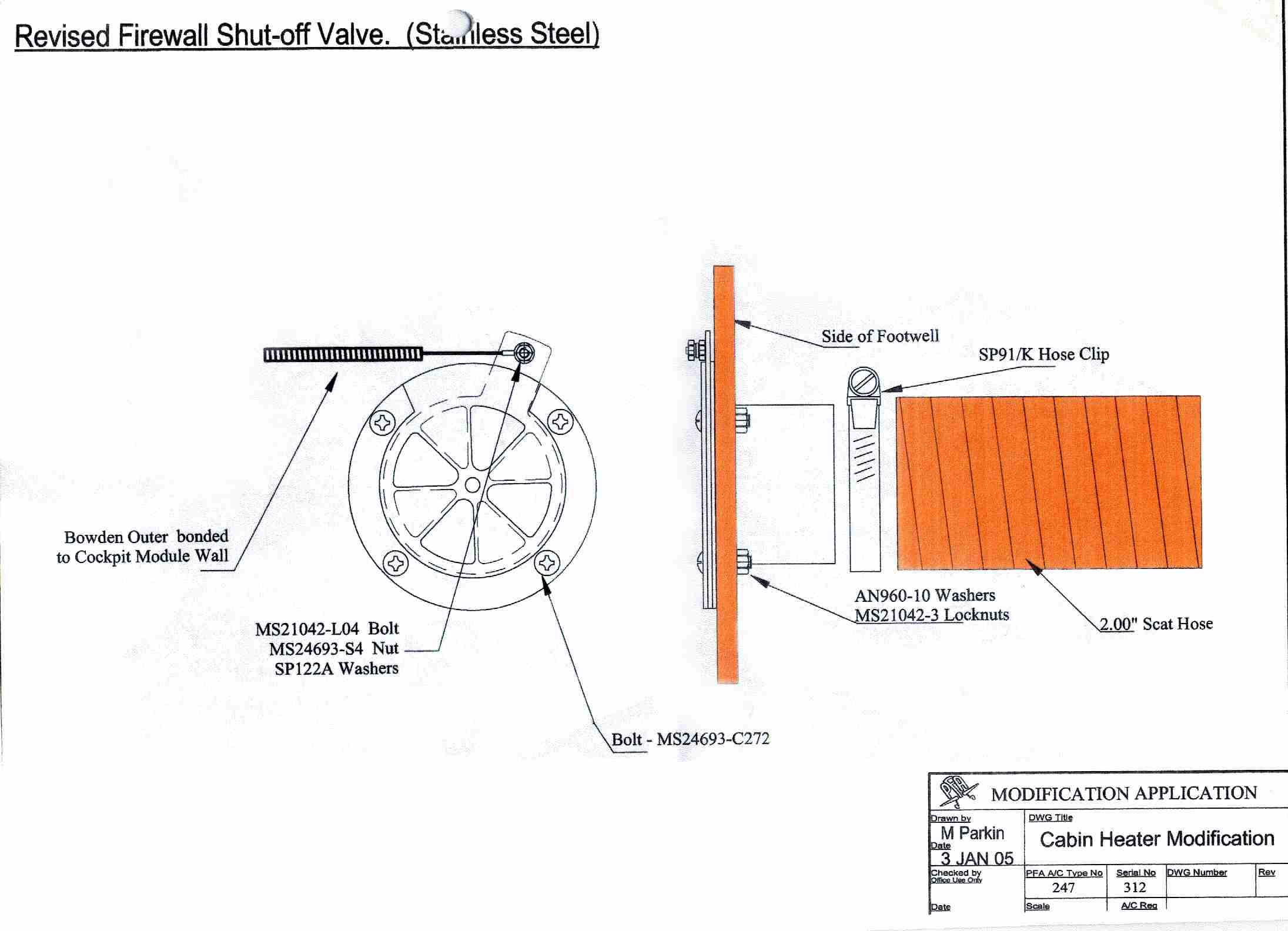

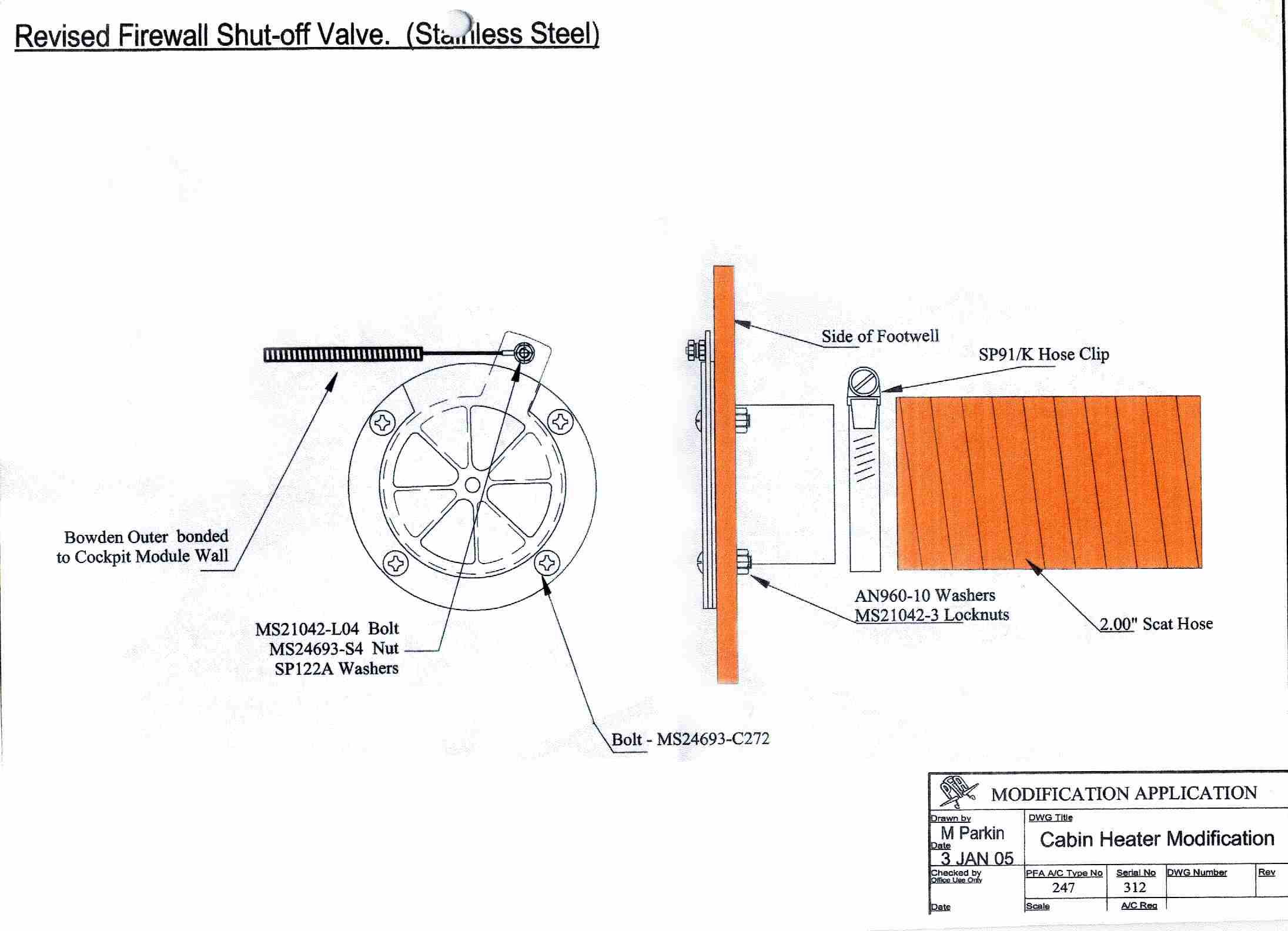

I have looked at your heater and it is in principal the same as mine and many others. That is taking the warm air off the rear of the water radiator. Mine is fitted but not operational (fire wall phenolic is bolted over the outlets of the SCAT tubes)
The reason for this is that Francis Donaldson (LAA) insists on a fire stop valve at the point were the tube passes through the fire wall. One builder, Mike Parkin, has made up some very expensive petal valves to achieve this. See attached. I am still looking for a cheaper and simpler solution to these valves.
Obviously US regulation is not the same as ours. What are your thoughts on a) the need for fire stop valves and b) a simpler cheaper way of achieving a fire stop?

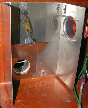

Here’s my method of maintaining firewall integrity. The brass colored item hooked between the two tabs is a fusible link (McMaster-Carr part number 1147A14) with a melting point of 100 deg C. The stainless steel flap employs a hinge with a spring to snap it shut once the fusible link melts. This takes more space than Mike’s scheme but it is an inexpensive solution.

<?xml:namespace prefix="v" /><?xml:namespace prefix="o" /><![endif]--> I use an expensive and fully lockable cable which holds the flapper shut because I fear the same problem. That shuts off the fire inlet at the duct. I draw the air from a low risk fire area, but not a perfect solution.
If I had regs requiring a stop valve, I would make it from stainless as a box with a flapper in it. Aircraft Spruce has a heater valve which I would use as a guide. Theirs is made of aluminum. Let's face it, if the aluminum melts because of a fire, you're in serious do do.
