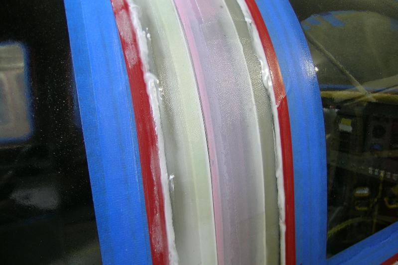

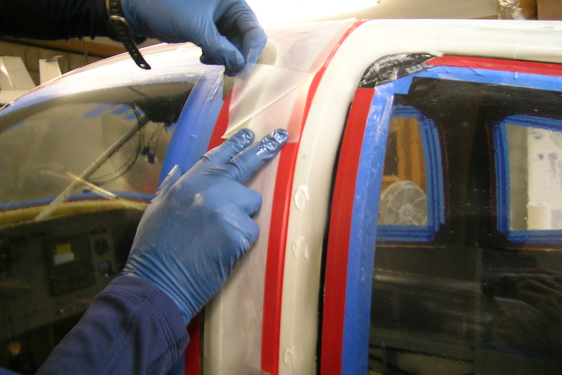

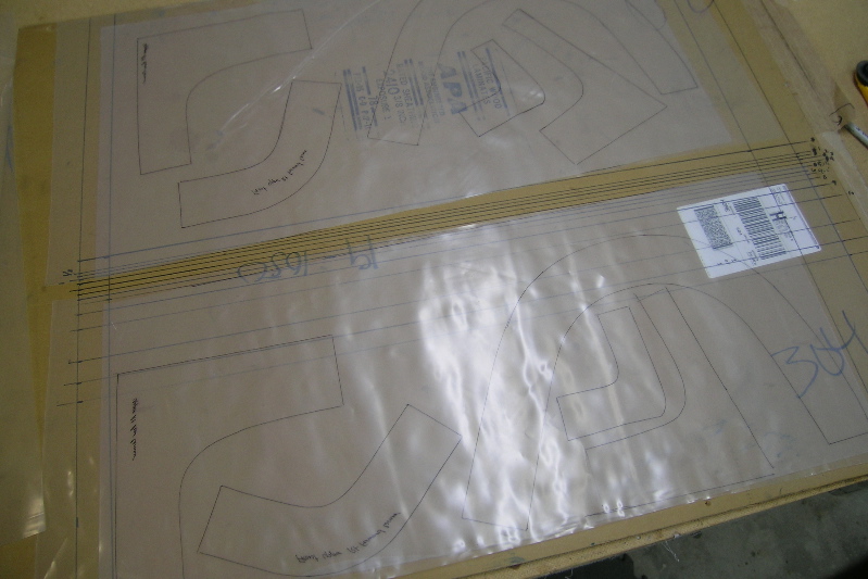

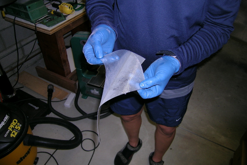

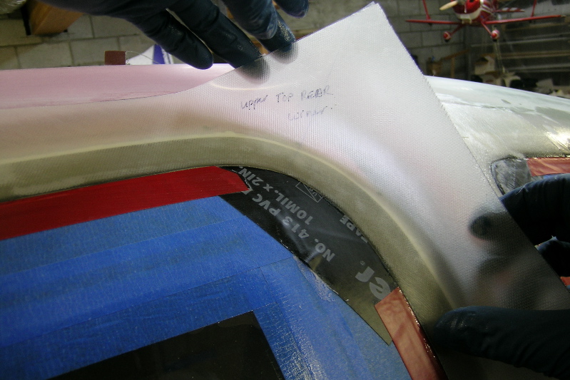

Make vinyl acetate templates(not shown) Material is see through and you can trace your tape lines onto the material.
Trace that onto thick plastic drop cloth material. Use same material for a backing piece
Place the appropriate size of fiberglass cloth on the backing piece and squegee resin into the cloth C lay the other piece with the tracing on top and use a clean squegee to join the top plastic drop cloth to the sandwich.
Cut the shapes with a roller blade.
Peel back the backing plastic and transfer to the plane. Once on the plane C remove the top layer. Use the brush to work the edge of the cloth to the tape line.
Finish that edge with a monjet syringe with micro resin mix C do this before it is all set. Sooner the better as it penetrates into the cloth better. This makes sanding the edge easier and keeps the cloth fibers intact.
All this give a clean edge C the shapes are correct and the transfer is simple C and clean with minimal manipulation of the fiberglass.
