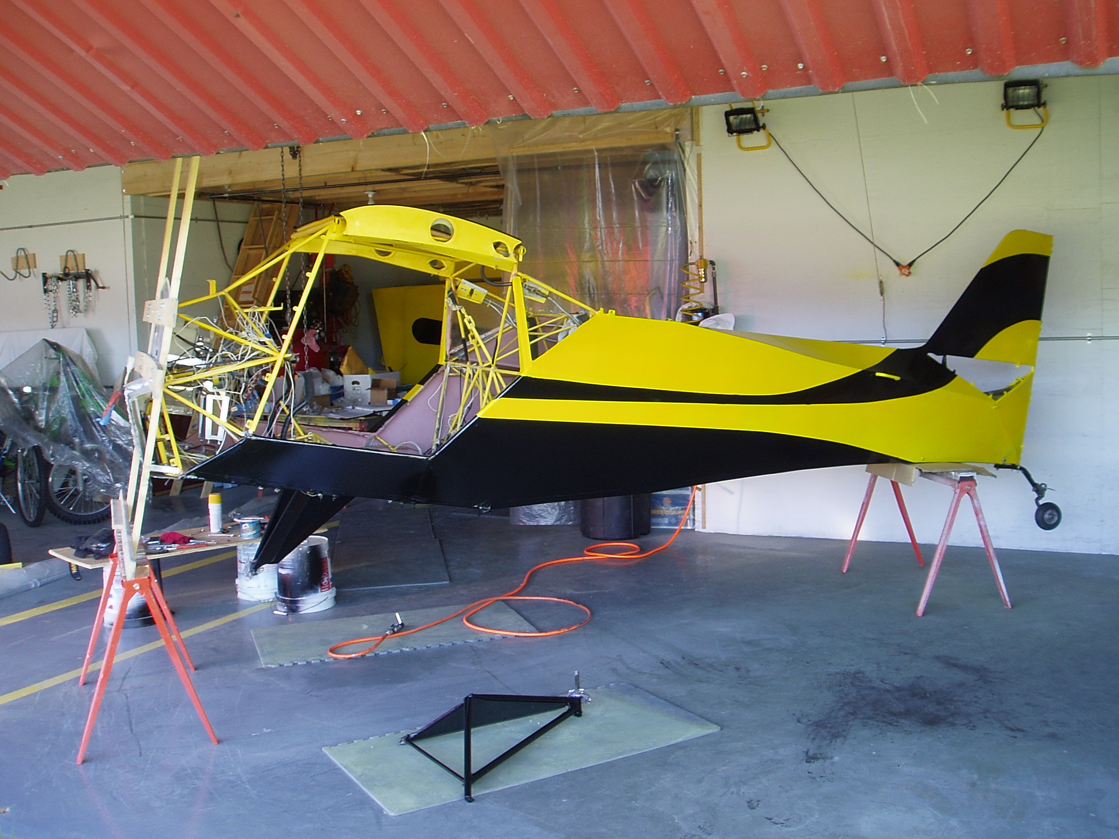

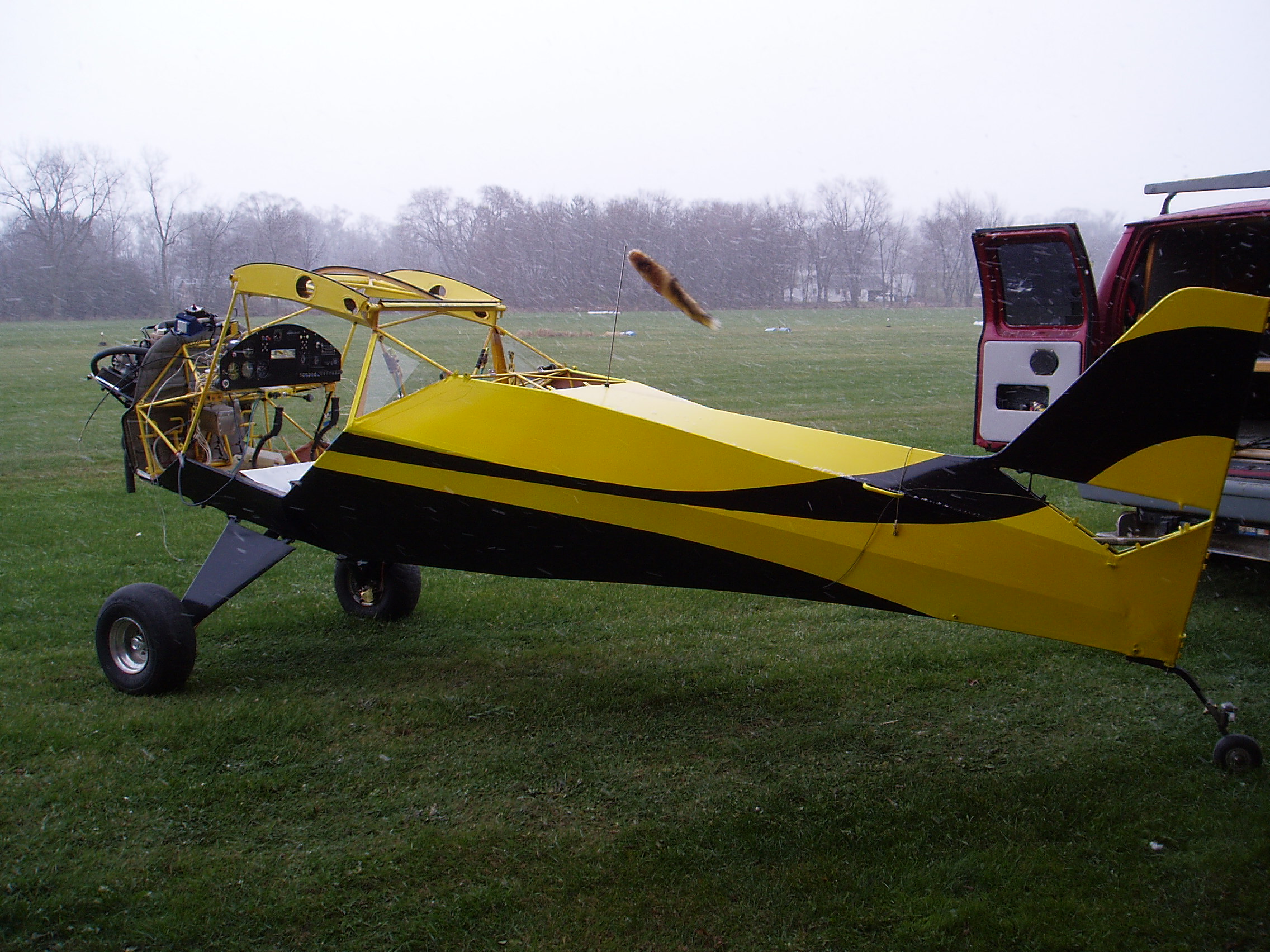

Kitfoxers C Finally learned how to attach pictures. Here's my rebuild project after painting fuselage.

On Mon, November 17, 2008 8:20 pm, patrick reilly wrote:
Kitfoxers, Finally learned how to attach pictures. Here's my rebuild project after
painting fuselage.
Very nice design. I like it!
Looks like it was about to snow in that outside photo, at least you're getting some
streaking that makes it look pretty cold out.
Did you make any mistakes? I'd sure like to hear some points on avoiding problems.
Looks like a lot of masking had to be done. You probably have developed some
techniques. Especially masking in a curved pattern on a plane.

Paul C Did I make any mistakes! If you paint an airplane or car C you make mistakes. You just hope they are not that noticeable. Masking isn't that hard. It is time consuming but the more you do it the faster it gets. The design I used isn't very complicated. I have painted a couple of cars but it is so infrequent that I am learning again from the beginning and by the time the project is done C I have finally relearned how to paint again. The major mistake I made was not having the right lighting. I used 5(at) 500 watt halogen lights and 2(at) 300 watt incandesant. It would have been much better to have flourescents. If you are going to paint a plane or car C you have to have enough of the right kind of light positioned correctly to always be looking into the glare of the light on the paint. I was finally doing it by the end of the job but because the lighting wasn't optimum I had to do everything but stand on my head to "look into the light". As far as masking C lay a line of narrow enough tape C most of my lines were done with 1/2" masking tape C to allow curveing the line C then site down the line from the end to make sure it curves evenly. Determine reference points to take measurements from C transfer the pattern to the other side. Lay your tape to those lines. Site down the tape and adjust to have even smooth curves like you did on the 1st side.
I painted yellow over a coat of white. Yellow needs white under it or you need many many many coats to cover C red requires the same white under coat. I then taped the pattern for the black and masked the yellow off and shot a coat of yellow along the tape lines. This coat of the base color (yellow) along the tape line is needed to seal the tape so no black seeps under the tape. This results in crisp lines.
I used Poly Fibre system and recommend you get "Poly Fibre How to Cover an Aircraft Using the Poly-Fiber System" book by Jin Goldenbaum. The EAA "How to Paint Your Own Airplane" by Ron Alexander is also a reference book I read an reread. What ever you do follow the directions to the letter for what ever paint system you use. If you think you can short cut or substitue some other product than the one specified C Good Luck! It might cost a little more $ than a less expensive substitute product. But time is also a cost and correcting an error due to non compatabile products is extremely costly C both $ and time.
Oh C yes it was starting to snow when the picture was taken.

Thanks for that tip. I haven't crossed a finishing tape yet with masking. Still
practicing on bare metal.
I did one wing without paying attention to pressing down the tape
real well, and I see the results every time I get up close and
personal with the plane.
If you are not doing very tight curves, you could get away with 3/16"
or maybe 1/4" tapes, but remember that the sharper the curve, the
narrower the tape has to be.
How did you lay out long straight lines? Some kind of chalk line? Did you mark the
surface at all as a guide?
When I've asked about how to make the lines really nice looking, I've been frequently
told that if I'm going to be so picky about them, then I need to use vinyl tape. I
don't know if that works over polyfiber though. It also occurred to me that a lot of
really nice pin striping is done on cars and has been done for a long time before
vinyl cutting was available. Also, if the vinyl panels are pretty big then weight
might be a consideration. Maybe I need to hire an experienced car painter to help me
some. I'm learning this on my own without the benefit of an experienced painter so
far.
Paul A. Franz, P.E.
PAF Consulting Engineers
Office 425.440.9505
Cell 425.241.1618
paul(at)eucleides.com
PostPosted: Tue Nov 18, 2008 12:03 pm    Post subject: Mod 3 Rebuild Reply with quote
On Tue, November 18, 2008 10:58 am, patrick reilly wrote:
Paul, Did I make any mistakes! If you paint an airplane or car, you make mistakes. You
It sure is impressive looking to me!
I
the beginning and by the time the project is done, I have finally relearned how to
have flourescents.
All that heat from those lights might have helped though. Is the idea that using
fluorescent lighting is going to mean you don't have to reposition the lights as much?
If you are going to paint a plane or car, you have to have enough
light".
OK, you're making me a believer on that. In my test painting, it's been on a real job
but just not as critical. I have been repairing corrosion damage and blistered paint
on a truck frame and doing a lot of masking of wires, bolt heads, decals and rubber
parts. I have spent many hours with rubber gloves, using various wire brushes and some
powered and naval jelly to remove the rust. Some parts didn't need to be repainted
since there was no damage by blistering under the Imron paint from corrosion. My
mistakes were often due to poor lighting and the other problem was not being able to
position the paint gun the best distance because stuff was in the way. If I
accidentally got a run, I just wiped it all off immediately in the area and shot it
again. Some places I put on too light of a coat simply because the lighting was not
bright enough. I think your trick of sighting into the glare is something I didn't
know and will adopt as standard practice.
As far as masking, lay a line of narrow enough tape, most of my lines were
done with 1/2" masking tape, to allow curveing the line, then site down the line from
from, transfer the pattern to the other side.
what do you make your transfer marks with? Or do you just start the masking as
measured points without a mark?
many many coats to cover, red requires the same white under coat. I then taped the
Oh, I see, that's clever. Do you pull the masking when the paint is still wet? How to
you keep from getting tiny little fracture lines in the paint when you pull the
masking off?
I've got that one.
OK, thanks for that tip. I'll get that one too.
What ever you do
you can short cut or substitue some other product than the one specified, Good Luck!
Sometimes, I've found that some of the more expensive products are horribly marked up
though. I will pay a little more locally to give them the business for the service I
get though.
But time is
costly, both $ and time.
I'm a believer in that. I'm using only the polyfiber products on my airplane.
Oh, yes it was starting to snow when the picture was taken.
Sure is more fun working on the airplane than doing the yard work and house repairs.
Thanks for the coaching.

On Nov 18, 2008, at 2:35 PM, Paul A. Franz, P.E. wrote:
<paul(at)eucleides.com>
On Tue, November 18, 2008 10:38 am, Lynn Matteson wrote:
> When doing curved patterns, I used 1/8" wide plastic tape from an
> auto paint supply. They also have it in a thinner, less "curveable"
> tape, which won't work as good, but it is better for making straight
> lines.
I don't understand. Why is "thinner" less curveable?
> Don't pull and therefore stretch the plastic tape, as it will
> lift off the surface, especially in a curve.
If you put a section down that isn't quite in the right position,
can you adjust it or
do you have to replace the piece that you want to move?
> After you've laid the
> 1/8" tape in the pattern you desire, go back and lay a wider tape
> over it, letting the narrower tape be the guide tape for your
> pattern, and the wider tape do the job of masking, and holding down
> the paper which you also get at the paint store...don't use
> newspaper, as it has fine holes which will bleed paint through.
I've been using the kind that is folded plastic about 4 inches wide
on the roll that
is preattached on one side to the tape. Stick it down, then unfold
the plastic to 16"
wide if needed. My problem has been if it don't stick it down
perfectly and have to
move it, I get a resulting ragged edge when I peel the masking off.
I haven't been able to get perfect lines at the edges of the
masking. I don't know
when to take the masking off either. Should it be done while the
new paint is still a
bit soft?
I was told that you have to spray a coat of clear over all the
edges to get them real
smooth. I was also told to try to feather the clear. I have tried
that and where it is
thin it gets a sort of dry dull look. Maybe I don't understand what
"feathering" means
exactly.
> Wherever you tape over a fabric finishing tape, or any other "edge",
> be sure to use a fingernail to press down on the tape, otherwise
> paint will find its way under the tape, and you'll have little tiny
> streaks of paint that you (and others) will see every time you get
> close enough to "sniff" the paint job. : )
masking. Still
Did you mark the
use vinyl tape. I
me that a lot of
long time before
big then weight
painter to help me
far.
Paul A. Franz, P.E.
Office 425.440.9505
Cell 425.241.1618
Lynn
Kitfox IV-Jabiru 2200
N369LM
patreilly43(at)hotmail.co
PostPosted: Tue Nov 18, 2008 3:09 pm    Post subject: Mod 3 Rebuild Reply with quote
Paul C The halogens were hot. Too hot. It was summer and I didn't need extra heat. Halogen lights tend to spot light the light. Flouresents give a flood light light that is better. less heat and much less power to operate. Set them up properly and use enough of them so you don't have to reposition the lights.
Yes C you have to look into the glare on the paint to see how wet it is C how much paint you have or don't have on the surface.
I just used a lead pencil to mark every couple of feet where I wanted my lines. Don't use a marker. It is easier to see but will bleed through the paint.
I pulled the tape before completely dry. That Poly Fibre book tells you when to pull tape.
Build yourself a fresh air system with a shop vac that you can reverse the air flow. I bought a new one for $35 at Farm and Fleet as a clean dedicated air supply unit. Get a Tyvek hood for $35 and coveralls from Cole Parmer on the internet. And run the air in with a garden hose. It was hot and the shop vac heats the air also C so I bought a wash tub C coiled up 20' of swimming pool vac hose in the tub C dumped 20# of ice in the tub and had cool dry air to the hood. Do it even if you are using a non-carcinogenic paint. Mine worked great. You can buy a fresh air system from Hobby Air C but I think they are about $400+.
Good Luck
Pat Reilly
Date: Tue C 18 Nov 2008 12:03:01 -0800
Subject: RE: Mod 3 Rebuild
From: paul(at)eucleides.com
--> Kitfox-List message posted by: "Paul A. Franz C P.E." <paul(at)eucleides.com>
> I
> have flourescents.
> light".
OK C you're making me a believer on that. In my test painting C it's been on a real job
on a truck frame and doing a lot of masking of wires C bolt heads C decals and rubber
parts. I have spent many hours with rubber gloves C using various wire brushes and some
accidentally got a run C I just wiped it all off immediately in the area and shot it
Oh C I see C that's clever. Do you pull the masking when the paint is still wet? How to
masking off?
I've got that one.
OK C thanks for that tip. I'll get that one too.
> What ever you do
Sometimes C I've found that some of the more expensive products are horribly marked up
get though.
> But time is
Office 425.440.9505
&gt=====================
_=======
Lynn Matteson
Posts: 2778
PostPosted: Tue Nov 18, 2008 3:33 pm    Post subject: Mod 3 Rebuild Reply with quote
Looking back at some pics I shot, I might not have used
1/8"....probably 1/4" or even 3/8" judging from the comparison with
my finishing tapes over the false ribs. Man, that was 3 1/2 years
ago! How quickly we forget.
Lynn Matteson
Jabiru 2200, 591hrs
Sensenich 62x46
flying again after rebuild, and new Electroair direct-fire ignition
system
On Nov 18, 2008, at 5:47 PM, gary.algate(at)sandvik.com wrote:
I did the same as you Lynn - the tape I used was 3/16" and is
called "Fine line Tape" available from most Autopro shops.
Ended up with really sharp detail and no seepage
Gary
Gary Algate
Classic 4 Jab2200
Lynn
N369LM
Lynn Matteson
Posts: 2778
PostPosted: Tue Nov 18, 2008 3:45 pm    Post subject: Mod 3 Rebuild Reply with quote
It seems like I read that the regular masking tape...crepe tape...is
too "wrinkeley" to use for fine edging, although the type of paint
used might have something to do with that...thin, runny paint would
tend to seep under a not-well-pressed-down tape edge.
All this talk of doing a perfect paint job reminds me of an old
photography professor (talking about making very crisp, sharply
focussed prints) who said "are you going to stand back and admire the
picture, or get your nose two inches away and sniff the damn thing?"
Lynn Matteson
Jabiru 2200, 591hrs
Sensenich 62x46
system
On Nov 18, 2008, at 2:29 PM, patrick reilly wrote:
Lynn, Most of my curves were gentle enough to use 1/2" paper tape.
I had some 3M special plastic tape(expersive). I couldn't get it to
stick very well and went back to regular paper masking tape. I
could pull and strech the tape to conform to any curve I was
making. I did have to go to 1/4" paper tape on the smaller curve on
the vert stab. and cowling. Also, shooting the tape line with the
base color before shooting the trim color will seal the tape. Any
bleed under the tape will be in base color, not visable, and avoid
the trim color run under the tape, resulting in crisp lines.
Pat Reilly
Mod 3 582 Rebuild
Rockford, IL
Lynn
N369LM
Guy Buchanan
Joined: 16 Jul 2006
Posts: 1204
Location: Ramona, CA
PostPosted: Tue Nov 18, 2008 4:32 pm    Post subject: Mod 3 Rebuild Reply with quote
At 03:09 PM 11/18/2008, you wrote:
Paul, The halogens were hot. Too hot. It was summer and I didn't
I suggest hanging 4' flourescents vertically. It works wonders. Don't
paint them, though. Wink
I just had great success doing some straight lines with a
construction laser. It works even over curved surfaces if you orient
the laser correctly. I've also had success getting straight lines on
small curved parts using the sun's shadow off a straight-edge to
locate the line.
Guy Buchanan
San Diego, CA
Guy Buchanan
Deceased K-IV 1200
A glider pilot too.
