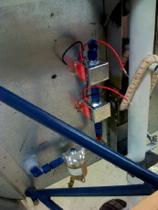

Well you can just not with the Zenith designed fuel system. The fuel system for the WW Corvair install has two pumps and the gasolator forward of the firewall here is a photo. And yes the gasolator is at the lowest point.
Here's a photo.

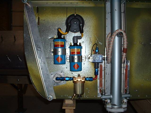

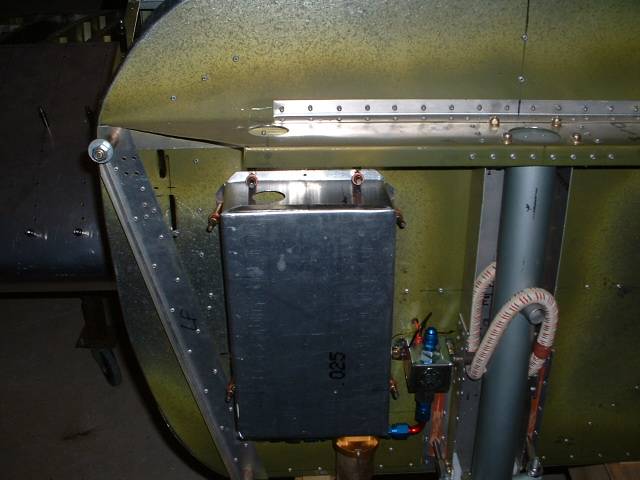

PostPosted: Mon Nov 17, 2008 5:53 pm    Post subject: Gasolator and Fuel pump location Reply with quote
Mike-
Possibly, yes. Corvairs use a setup similar to the attached pictures for
HDSs. The main idea is to keep the primary ignition components cool via a
box fed by a rear engine baffle mounted SCAT tube.
I'm waiting the on components to finish my installation, which is a
direct rip-off of proven projects. I'll post pictures of the completed
effort if you'd like.
Bill
