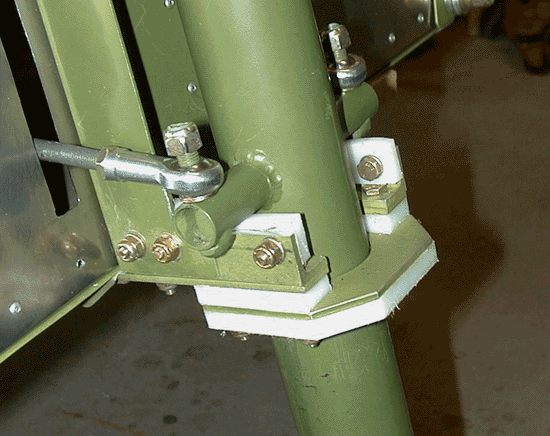

craig(at)craigandjean.com Guest
Posted: Tue Nov 11, 2008 5:43 pm Post subject: CH701 nose wheel bearing |
The attached photo is actually from an HD (Larry McFarland's?) but the
design on my 701 looks the same and I'll be adding the nylon. Basically add
nylon plates with V notches inside and parallel to the aluminum angle.
-- Craig
Posted: Tue Nov 11, 2008 5:50 pm Post subject: CH701 nose wheel bearing |
Even the latest plans (7-L-1 dated 04/2006) show the V notch as bare
aluminum (7F8-6 dated 06/2005). I sent a picture in another message showing
how to add nylon V notches.
-- Craig

gus
Joined: 10 Nov 2008 Posts: 5
Posted: Wed Nov 12, 2008 5:43 pm Post subject: Re: CH701 nose wheel bearing |
The pictures look good. I have some 1/4" Nylatron sheet stock, that should fit well. Thanks for the pictures.

gus
Posted: Mon Nov 17, 2008 6:40 am Post subject: Re: CH701 nose wheel bearing |
In order to get full bearing contact I'm considering lathe turning two bushings , these would require opening the 2" up to 2 1/4" on 7.F.8.4 ,7.F.8.5 and 7.F.7.4 . I would leave a flange on these bushings to allow bolting or riveting in place . They would also need a saw cut to allow them to fit over the nose gear strut assy. 7.L.1.1. My concern with the method in the photo is after the nylon wears a little , we will be back to metal on metal. What are your thoughts on this method ? Thanks Gus
