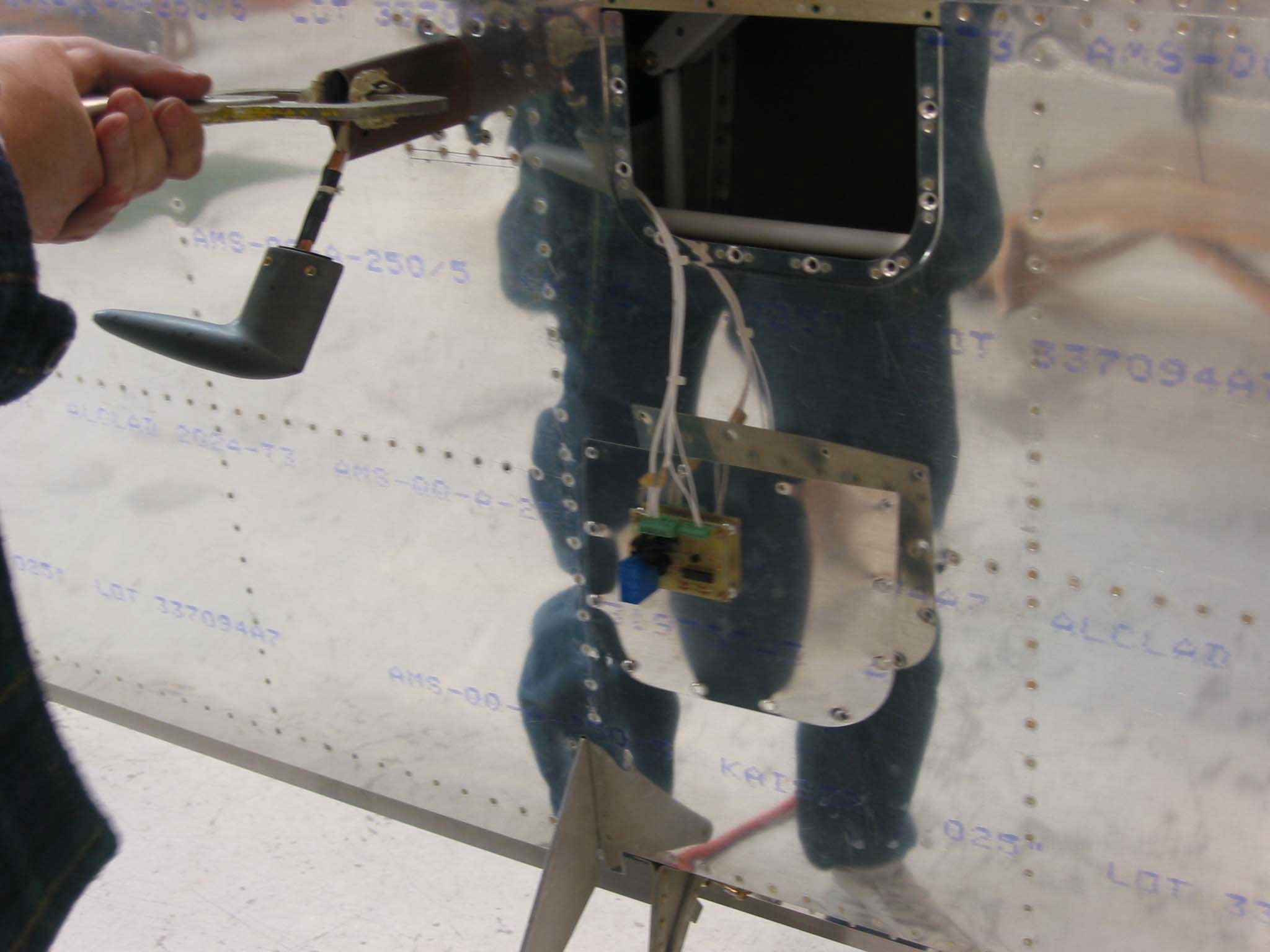

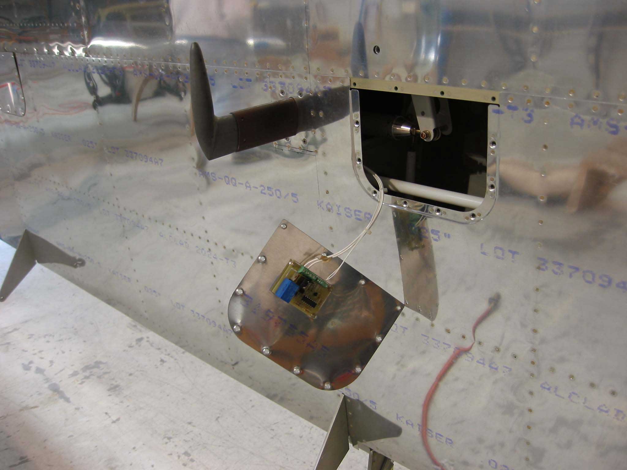

Mike,
I have the Gretz pitot tube and here are a few photos of where I installed it and the controller board. As you can see from photo 2 it's right near the tie down ring. It's very easy to access, just take off the inspection plate and reach in. I've not had any difficulty with it being placed here.
Wayne Edgerton N602WT

Several people also moved it out to the second bay or so from the wingtip. This makes it very accessible.
