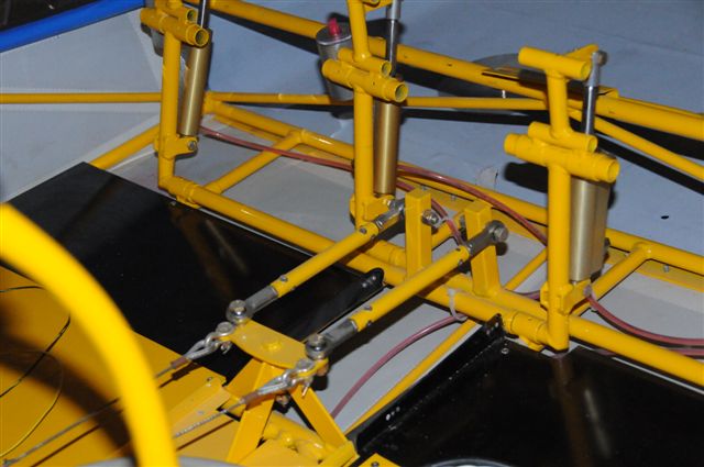

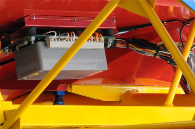

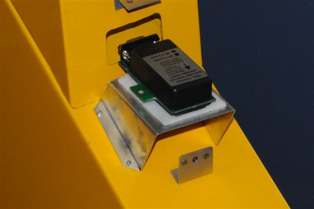

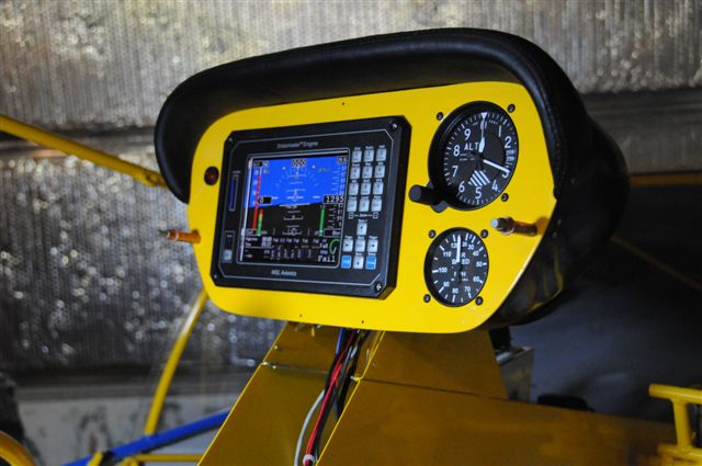

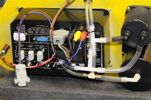

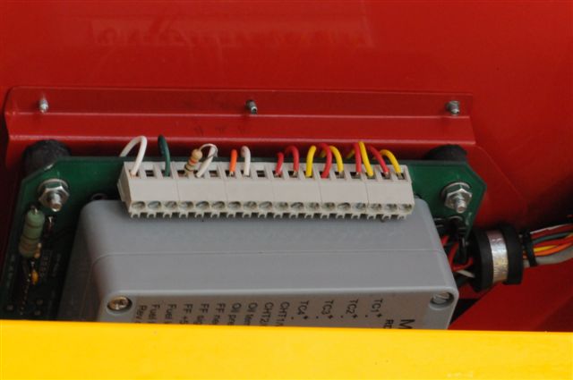

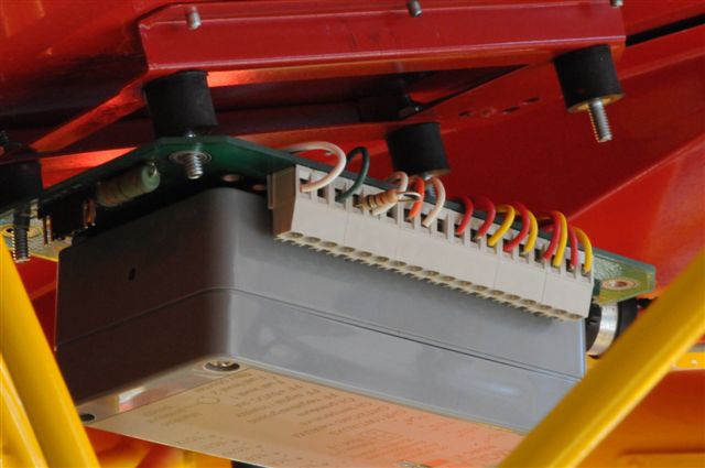

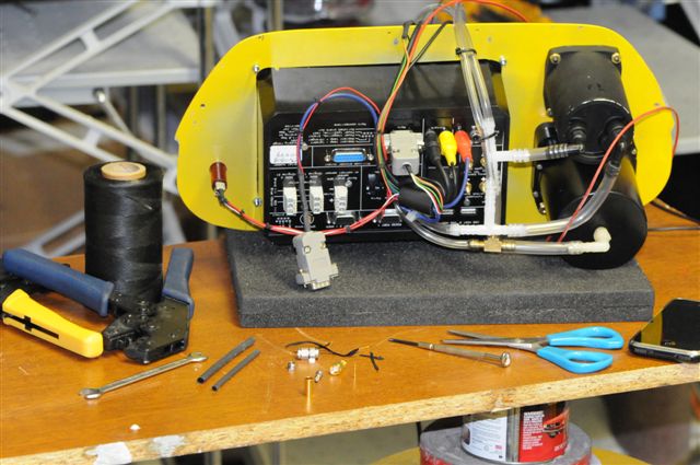

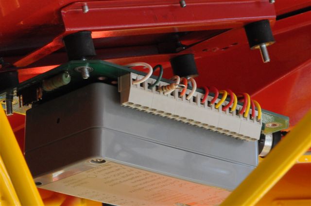

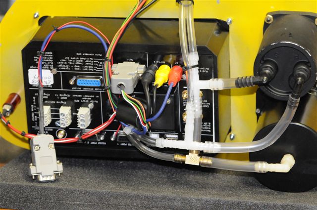

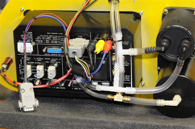

I have been involved in my annual inspection. Removed the cowling and
found a lose cht bolt and a wire lom nut had come off. I have had some
trouble with the EIS. My tach was working intermintaly and the cht that
was irregular was deffinatly the blot that had worked lose. The tack
problem was where I had made a solder connection at a plastic conector
plug. it vibrated till the wire workhardned and brke lose. The shrink
tubing held the ends together that's why the intermint operation.Decided
to do something drastic B4 I started you can see the results in the
photos. B flying next week

I used a similar electrical connector system on the Victor 1+. I found that
if one does not closely control the wire flex next to the connector, they
will, in time, vibrate in two. You may want to consider laying a soft piece
of tubing across and above the wires to keep them vibrating relative to the
connector.

I like to collar the joint with shrink tube. Looks nice, is
waterproof, and reduces flex.

Seems like I had heard that you shouldn't solder wires on airplanes due to
that very problem. What do you guys think?
I used only crimp connectors in my plane. You also need to support the wires
as much as possible to keep them from moving and breaking.

agreed, I use only crimp. My weak spot is the push-on flag
connectors on my ignition module.
I bought the best ones I could find.
ok so far.
