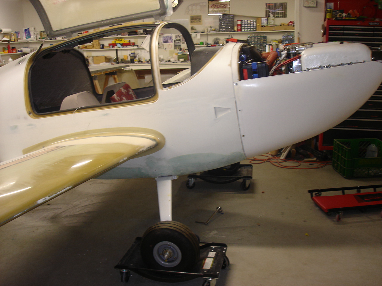

I am in the USA and am building the Bob Berube version. I am not flying yet but have heard a lot of good things about it. I've attached a pix of mine during the build.
