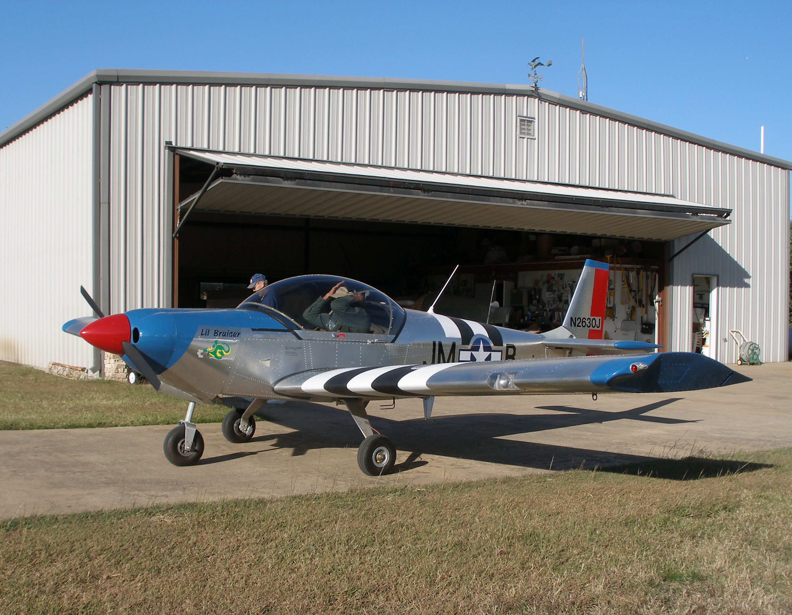

I understand that 6061-T6 is very corrosion resistant. Therefore, I only painted the fiberglass parts, invasion stripes and a little other cosmetic painting. I actually like the look of the "raw", unpolished aluminum. Judge for yourself.

I didn't paint for the first 4 years and only polished twice. After the four years and four Canadian winters small white pockets began to appear on the 6061, particularly round the rivets.
I had it painted.
