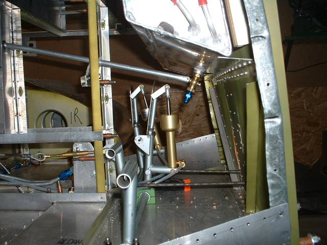

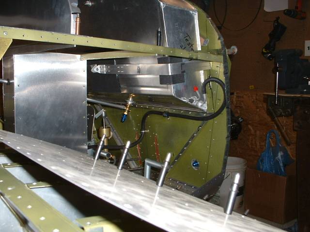

WW (And others) question whether my header tank was built correctly at the factory. Pictures are attached. The feed line comes from a console mounted Facet. The extra ports are (Supposedly) for a sight gage quantity indicator. He thinks the input should be at the top of the tank, and he's not the only one that has expressed that opinion in the past.

With the feed at the bottom, fuel will leak back into the wing tank possibly causing it to overflow unless a check valve is installed in that line. That is the only issue you might have with that configuration, the pump will feed fuel into the tank just as well either way. Some Facet pumps have a built-in check valve, some are designed to allow a very small amount of back flow (as I recall about 1/2 gallon per hour) in order to allow fuel lines to depressurize after shut-down. If you want to use the Facet pump as your check valve, make sure you get the correct model number.

Is there a possibility that that feed goes up to the top of the tank on the inside of the tank?
Plug the output, or hold the hose up and put some liquid in the tank to see if it siphons out the input tube when half full.
I would not trust a check valve if the tank can siphon.

My 8 gallon header tank had two inlets on the bottom. I had a welder
relocate one of them to the top and plug the resulting hole at the bottom.
Neither bottom inlet had a tube inside the tank.

My HDS 8 gallon header tank came with 2 fittings at the top of the tank, a fitting at the bottom, and an output at the bottom that goes to fuel shutoff and engine.
My instructions say to plumb one of the top fittings to my optional wing tanks. The other 2 are for a clear sight glass to be used as a fuel gauge.
I've seen some instructions in the early models that had the top fitting being shared as a feed line and the top of the fuel sight gauge. I can remember 8 or 9 years ago when folks that were flying HDS's and HD's saying they used that feature to know that their pump was working.
By using the bottom as a feed I would worry about leaving the plane with the header and the wing tanks full. Over time the fuel would siphon out of the header through the built in leak in the facet pump to the wing tanks.
