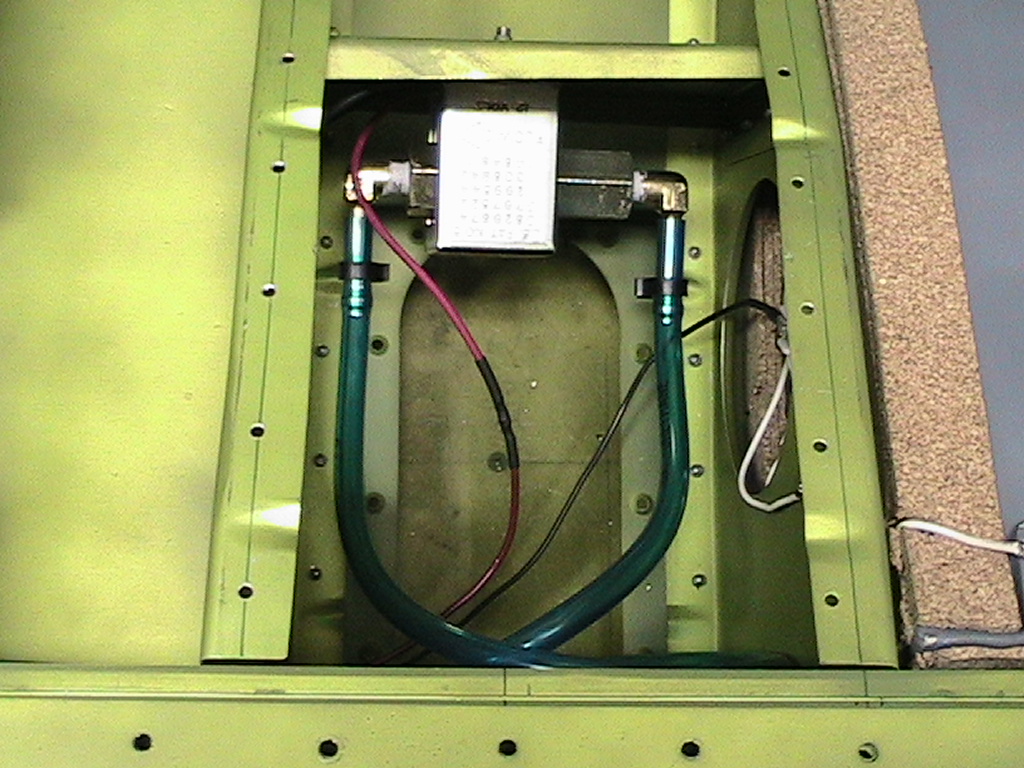

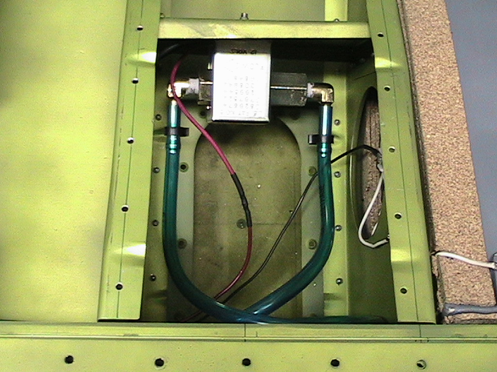

PostPosted: Sat Nov 01, 2008 5:06 am    Post subject: Fuel Systems Reply with quote
They aren't the best photos in the world but this is how I installed the Facet pumps in the wingroots near the tanks. In this location the pumps can pressurize the entire line, prime the entire line, make fule flow uphill, etc. No worries about auto gas vaporizing on a hot day at altitude.
Ed
