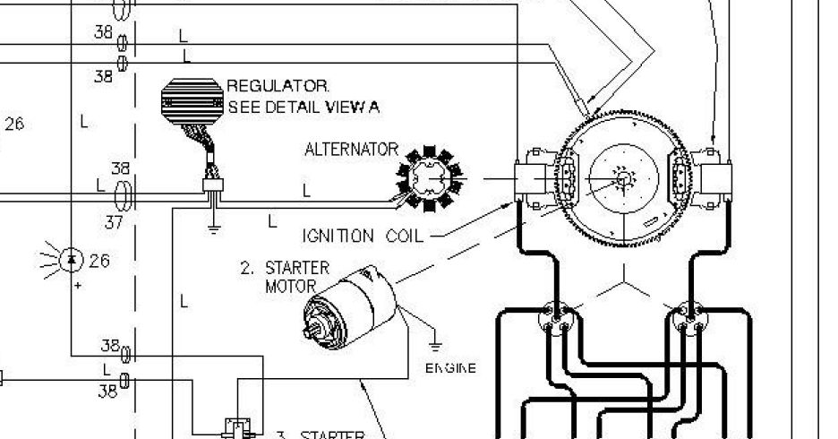

Clive,
Are you speaking ignition coils (two of them, either black or dark gray in color) or the "coils" in the rotating alternator??? A mismatch in terms here might tend to confuse those of us who speak American English. Connectors in ignition coils should have no impact on charging.
CAVU jeff
[quote] New coils (with dodgy crimps) were fitted in 2006 or 7.
Clive J
Joined: 03 Nov 2007
Posts: 340
Location: UK
PostPosted: Thu Oct 30, 2008 2:25 pm    Post subject: Found it at last-Coil feed wires not crimped on new altern Reply with quote
Sorry, alternator 'stator' coils.
CAVU?
CJ
