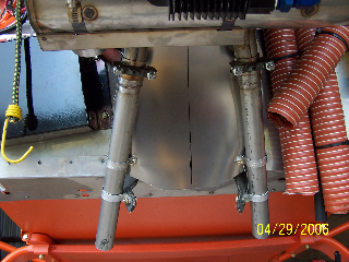

I always love the topic of "unsupported tailpipes" because it gives
me a chance to display what did, and imagine what could have, happen
(ed) if you leave your pipes unsupported, especially if you extend
them to any degree. I was dumb enough to do both, and got lucky when
it didn't progress any further than what is pictured. You can see
that the (then) open exhaust licked at the firesleeve-covered fuel
line and the motormount, and got behind the flange of the battery
box...the black item at the left of the picture. Three weeks later,
the battery gave out, and I investigated and found the battery had
melted from the heat. Here's a shameless plug for Odyssey
batteries...took a lickin' and kept on tickin'
The last picture is of a stainless steel heat deflector that I built,
just in case the problem should ever occur again, and it also shows
how I supported the tail pipes.
This is a Jabiru installation, but a similar deflector/support method
could be used on other engines.
Lynn Matteson
Kitfox IV Speedster
Jabiru 2200, 579.1hrs +
Sensenich 62x46
flying again (17 hrs) after rebuild, and new Electroair direct-fire
ignition system

Just for the record, I saw an even better method of supporting a
tailpipe when I was at Oshkosh this past summer. This idea came from
an award-winning (I believe) Hatz biplane.
There are two of these hangers on each pipe...you can just barely see
the mounting bracket for the second one. His is way better than the
"rubber strap" hangar like I used on mine, and someday I'll change
them out for this type of hanger....completely fireproof. It's just a
length of SS cable, a nicopress sleeve, a hose clamp, and a short
length of SS tubing...simplicity itself! I just got to thinking that
you could even leave off the SS tubing, and use another nicopress
sleeve for the two loops of SS cable to run through, and clamp that
to the pipe. That would bring the two hangers a bit closer together,
but it might work in some circumstances.
Lynn Matteson
Kitfox IV Speedster
Sensenich 62x46
ignition system

my exaust leeks at the joint it was cut to fit the cowling (582) I put little trim piece under the cowling to help draw the fumes out by low pressure vacuum is works very well. is there anyone there that can re cut and weld a new elbow for me??
