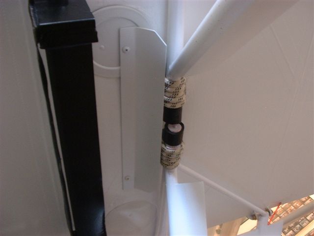

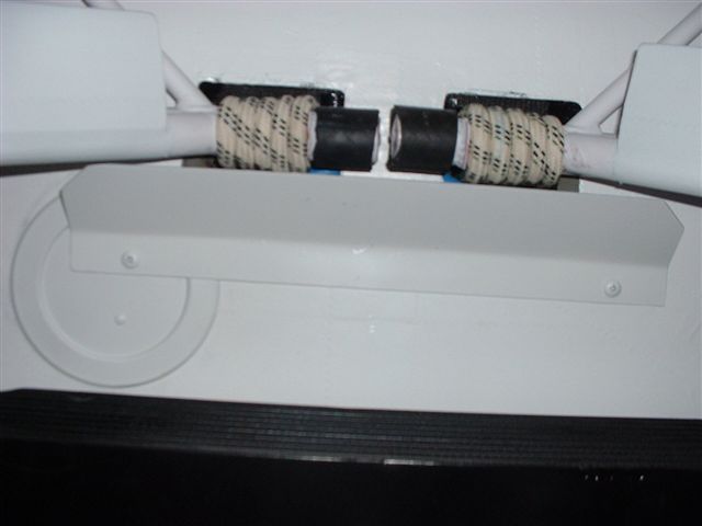

HERE IS A WIND DEFLECTOR I MADE UP AND INSTALLED IN FRONT
OF MY BUNGEE CORDS THAT STOPPED THE WIND FROM COMING UP INTO THE COCKPIT COMPLETELY AND
KEPT THE EXHAUST FUMES OUT ALSO. MAKE SURE THE FIREWALL
IS SEALED AND AND THE SIDE PANELS INSIDE ARE SEALED ALSO.
IT WORKED GREAT.
DAVID YEAMANS
Kitfox 4 1200
Rotax 912 UL
