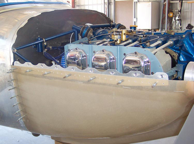

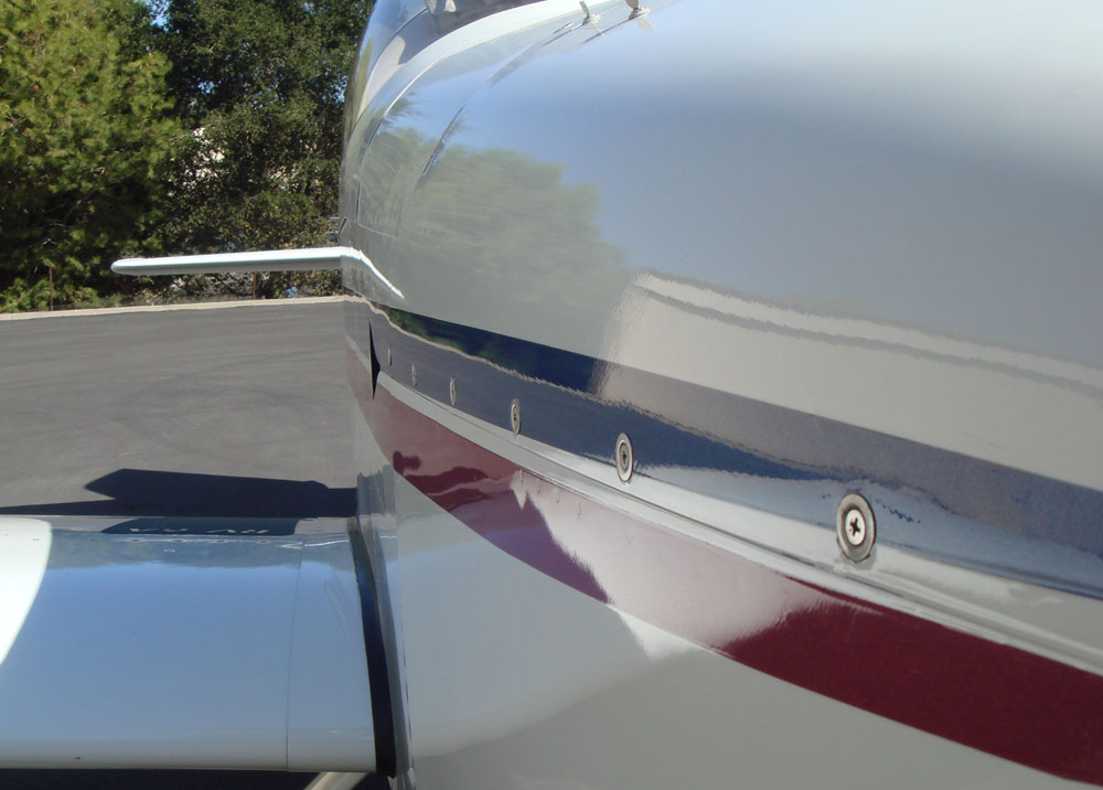

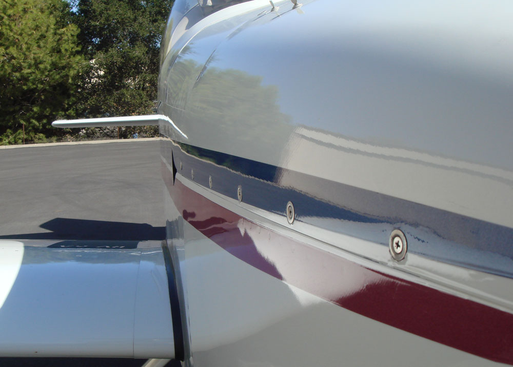

There are a lot of choices to connect your cowl. On my -10 we went all out with the sky bolts but they are unreasonably expensive and heavy IMHO. An excellent alternative to piano hinges and sky bolts or locks is a simple stainless screw. My RV-6A cowl is held together with S/S screws and they work great, look good and can you can replace 5 of them for a quarter.
The cowl uses piano hinges along the vertical lower sides but S/S screws along the top, horizontal sides & the underside. I much prefer these to piano hinges.
 Filesize:  65.98 KB
 Viewed:  555 Time(s)
 Filesize:  112.09 KB
 Viewed:  522 Time(s)
 Filesize:  117.78 KB
 Viewed:  573 Time(s)

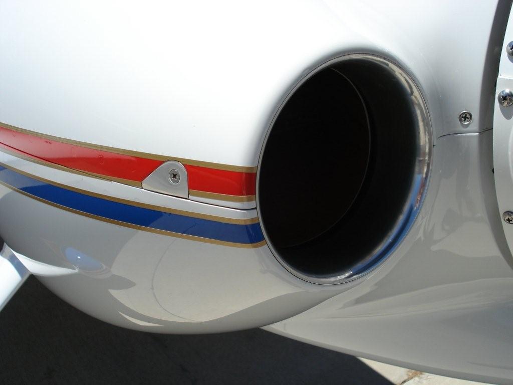

Here is a sweet pin cover:
Robin
 Filesize:  53.75 KB
 Viewed:  512 Time(s)
