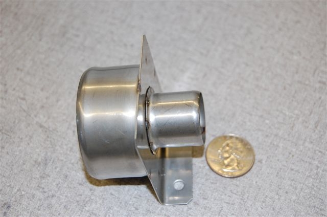

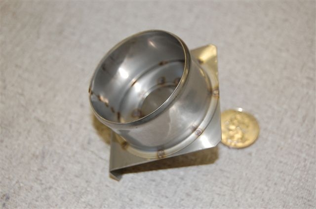

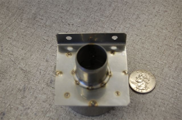

Thanks for the site info. Actually, I'm using an extended Andair valve stem and don't have a clearance problem. I'm trying to keep the total hose volume down to lessen the heat effect.
One guy has contacted me with a reducer he can build. I'm going to try two of them. One at the firewall to reduce hose and a second at the rear passenger valve to bring fitting back to 2".
I've attached some pictures but will leave it up to him to post his name and # unless he tells me it's ok to do so.
Thanks again,
Tom Hanaway

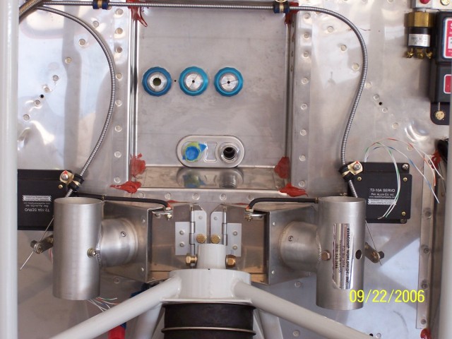

Tim, I wanted to be able to mix the cold with hot air also. This is what I came up with. I also have details on my web site page.
http://www.nwacaptain.com/heatcool.html
Greg...
