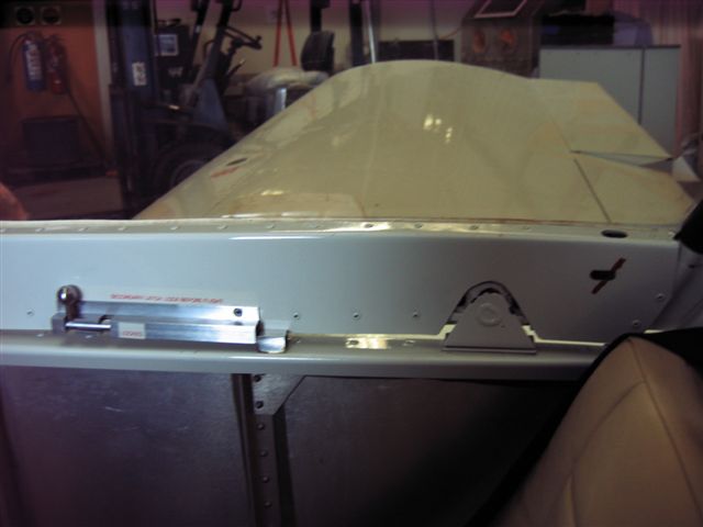

In Australia
we are recommending putting in an extra safety latch or cable to all our Zodiac XL's with the older thinner Aero Plastics 80 thou canopy's. It appears that the older 2 stage locking mechanism is easy to not lock properly. This results in it only locking to the first stage and popping up just after take off.
It normally happens on the passenger side, as they don't like to slam the canopy , so lowering gently and not locking it fully..
We can either have a cable system as Jan's one above or an extra lock on each side of the normal lock. If you upgrade to the newer canopy system you don't need to do this or get a Todd's Canopy as they are 120 thou.
I will try and attach some photos.
Chris.
