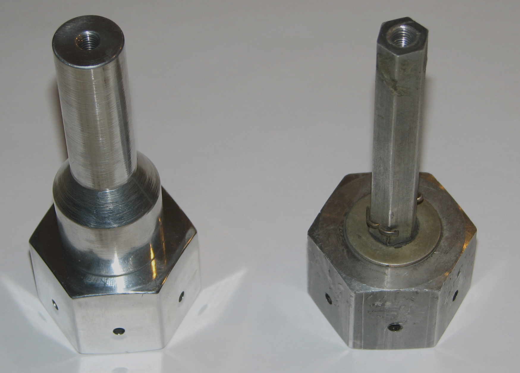

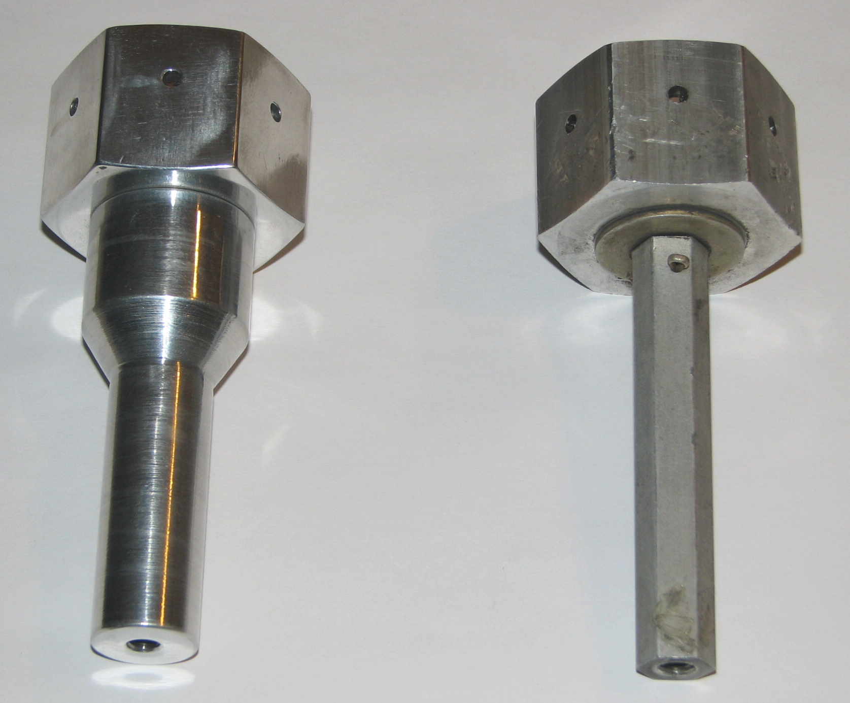

Not sure what most of you have done, but when I saw the extensions supplied with the kit, I knew I needed something different/better. So I machined a new set for myself. Then my neighbor, Mark Carey with a flying 10, told he he sure wished I had made him a set. That was 6 months ago. Last week he called me to tell me that after a hard landing, he broke one of the extensions. So, long story short, I gave him mine, and am now making more. Made out of Aluminum 6061T6, using an AN5 bolt to bolt to the axle nut, instead of the stk AN4. All that's left to do from the user end is drill out the attach hole in the nut, install the AN5 bolt, and drill for a cotter pin.
I am initially making 15 sets and am giving them away for $40 a set including shipping.

Posted: Sun Oct 19, 2008 5:13 am Post subject: RV10 Axle Extensions |
You guys do know that Cleveland Tools stocks these now, right?
So they're available all the time, and all of the drilling is done.
I think they may be $5 or $10 more expensive or something like
that, but just wanted you to know that they are there. Another
builder took that design that I originally made and decided to
build them and distribute them through Cleveland. Nothing
wrong with having multiple sources, but just pointing out that
EVERYONE should really get themselves a set sometime, from
at least somewhere, and Cleveland stocks them. I'm not sure
if they include all the hardware like I did originally, or not,
but I also did include a longer Stainless Steel screw for the
outboard side, because those screws definitely will work themselves
loose if not lock-tite'd in.

Tim Olson
Joined: 25 Jan 2007 Posts: 2882
Posted: Sun Oct 19, 2008 9:13 am Post subject: RV10 Axle Extensions |
Don't feel bad Don, it's just a general etiquette thing on
the behalf of the other responders. My suggestion would be
to always just request that
"Please send an email to xyz(at)yourdomain.com and DO NOT
reply to the list, or reply-all"
I know, it's tough, because I've had the same thing happen
tons of times where you request offline responses but people
just reply to the address without thinking. It's not your
fault, it's just something that people have to try to remember.
And, as William said, not such a big deal when one new
flying RV-10 announcement can generate 15 public replies,
but you just don't want every product announcement to
generate 15 "I'll take one's" that go to the general list.
I find it amazing that even on the VAF site, where it's web
forums, people STILL post those "I'll take one" responses...
when really they should contact the sender only.
Like I said, it's nice that we have multiple suppliers and
multiple design choices with some of these parts, so
nobody wants to stop you from getting them out. We could
use more innovation from people like you. They just want
to see orders requested in a different way than a long
thread generating multiple emails. I posted this response
"do not archive" but as part of the thread, in hopes
that it at least gets people thinking before they do the
same. I'm sure that the Axle extension business will be
continuing good business. At the time when I did the first
group order, there were over 160 pairs that went out, if
I remember right. As far as I'm concerned, this is one
of those parts GUARANTEED to cause problems if you build
it stock....just like people who use the old stainless
spacers on the front axle. If only someone (maybe you're
up for it??) came up with a good retrofit kit that included
anti-rotation stop screws such as this photo I grabbed
off the VAF forum a long time ago:
http://www.myrv10.com/tips/maintenance/NoseWheel/2005087365224441271_rs.jpg
Now THAT is a parts kit that I think would also be a "must buy".
My writeup on that problem is here:
http://www.myrv10.com/N104CD/maintenance/20060809/index.html
Good luck and folks, just email Don directly if you want
his extensions. If you're a newer builder who's completely
uninformed as to the problems with the original extensions,
here's my old write-up:
http://www.myrv10.com/N104CD/upgrades/20070118/index.html
What would be REALLY interesting is to see what Van's reply
would be, if a couple of people who had the standard ones
break called up and said "Have you ever seen this problem
before?" I'd put a couple bucks on the bet that they'd say
"No, we've never heard of that problem." Too bad in the
field, these things have been failing quite often...probably
due to the RV-10 using larger fairings than they were used to.
