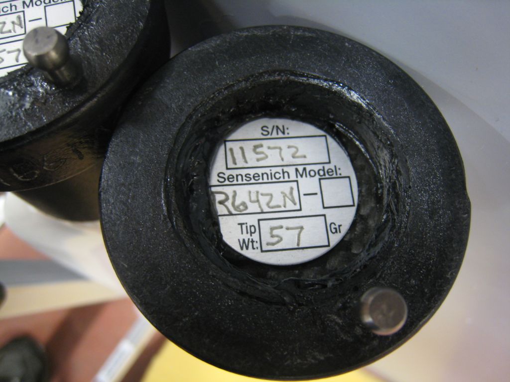

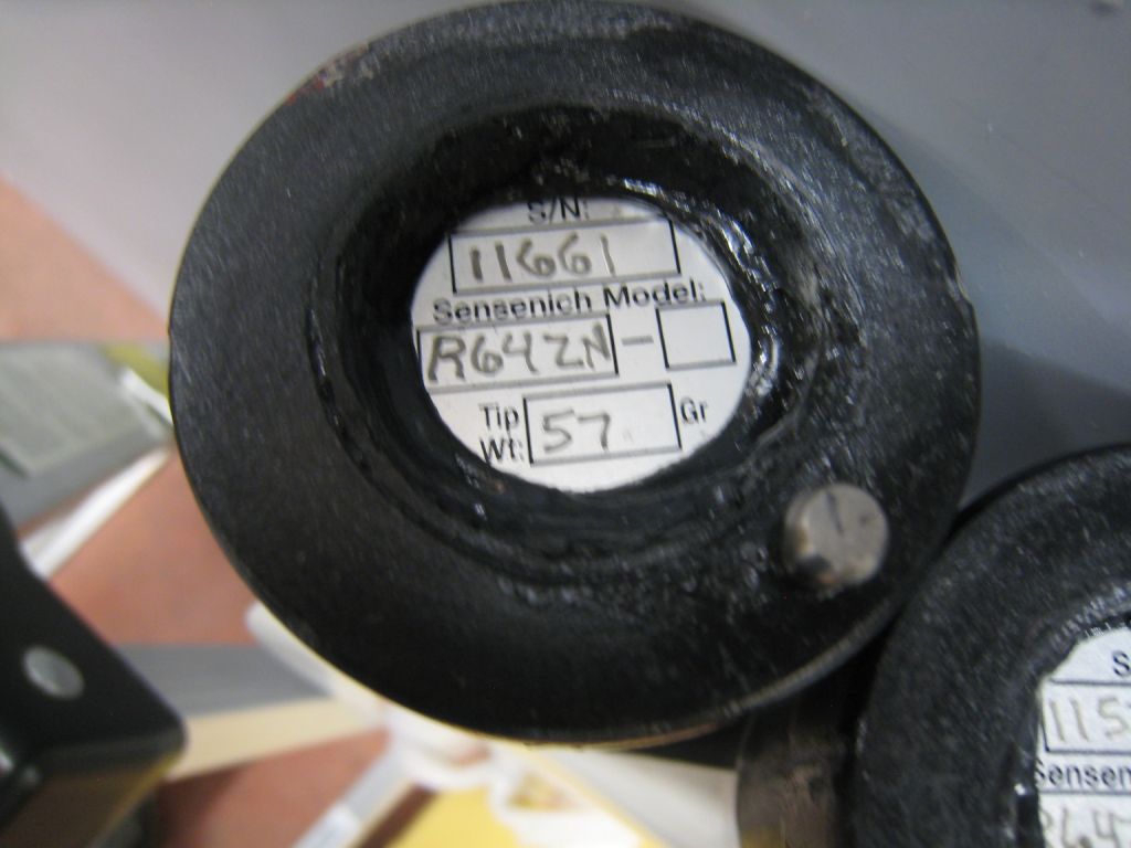

Look at the root of the blades (pictures attached). The part number on my
blades and invoice is 2A0J5R64ZN. The 64 is the diameter: 64 inch. By chance
I just measured mine and confirmed this. I believe the "R" means right-hand
and the final "N" flags the nickel leading edge which my prop has. The
description on the Sensenich invoice says "2 bladed right hand composite
aircraft propeller with nickel edges, short shank, 64" diameter. Blade S/N's
11574, 11661; hub S/N 23627". The is nothing on the hub but the serial
number and a label describing the specs, RPM limits and bolt torques for the
"EZ-Pitch Composite Aircraft Propeller"
