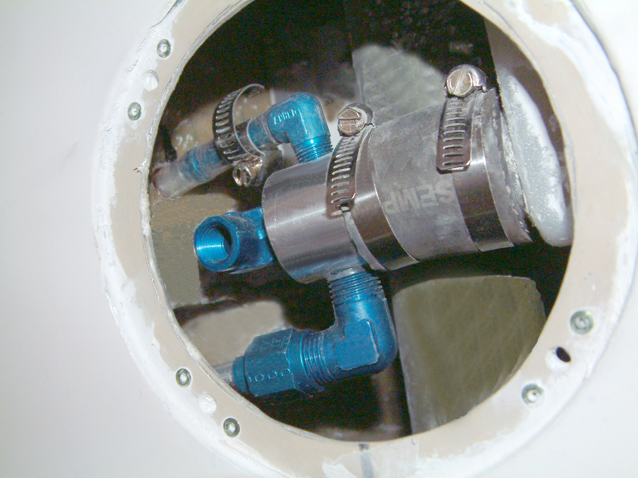

grahamsingleton(at)btinte
PostPosted: Fri Oct 17, 2008 4:40 pm    Post subject: Fuel drain kit Reply with quote
Remi Guerner wrote:
Hello Jerry
The supplied drain kit (Mod 33) has one inconvenience: due to the
length of the hoses from the tank to the drains, you must drain a lot
of fuel before actually draining fuel from the bottom of the tank. One
mod to the mod I made was to modify the fittings and use 4 millimeter
hose instead of 8 mm. Therefore the dead volume is reduced by a factor
4 and the purging is more likely to be effective. Moreover, with the
high fuel price we are experiencing now, there is some economic value
to this change.
Remi Guerner
This is what I did, (if the picture comes through) Wink The drain screws
into the AN914-1 fitting.
Graham
