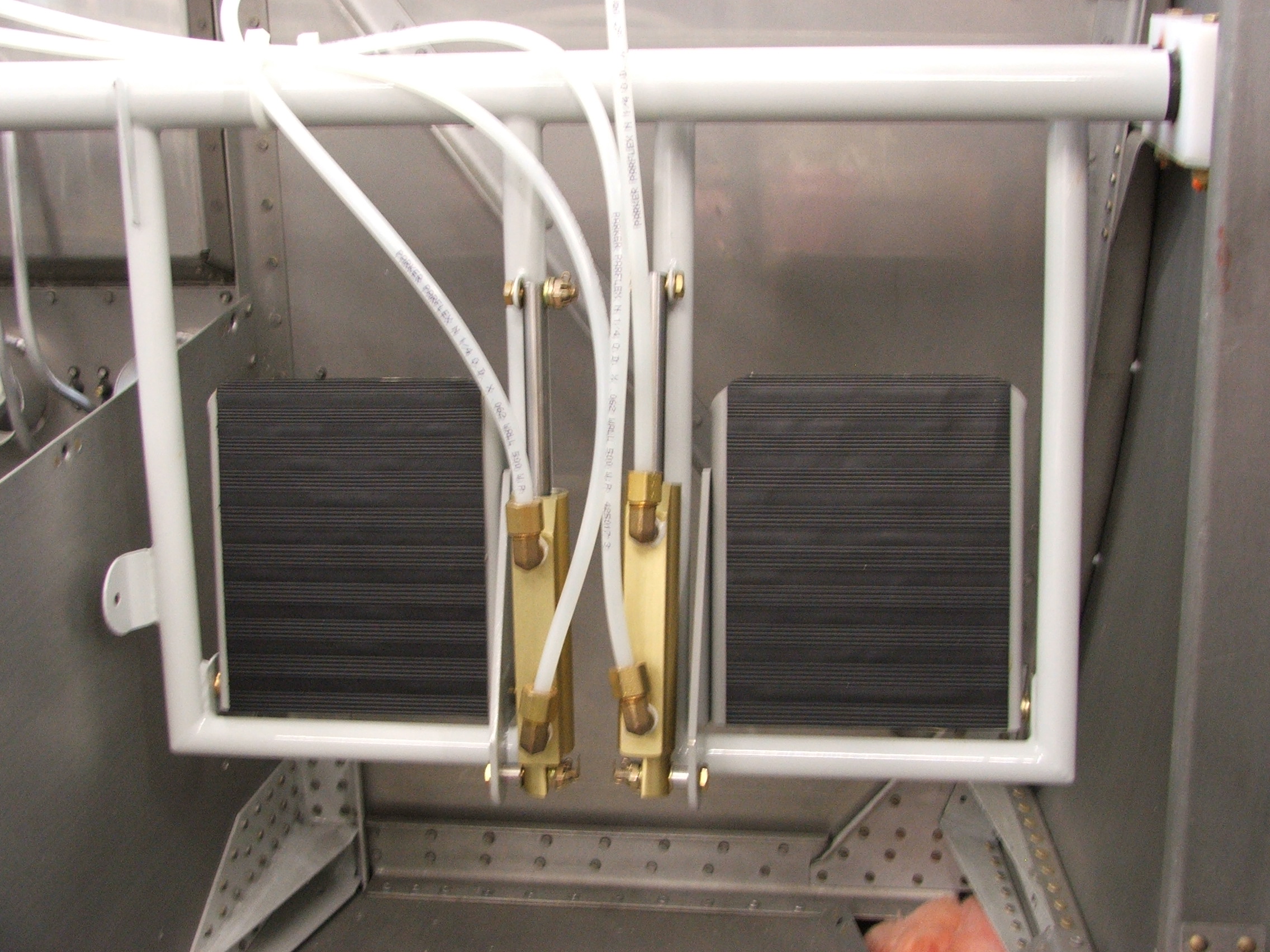

Don't like the John Deere look to your rudder pedals but don't want to spend a fortune replacing them? I did this to my RV-6 about 8 years ago and it still works. Go to your Home Depot aircraft parts store and buy a stair tread, found in the floor covering area. Cut to fit and glue it on. One tread does all four pedals. Available in black and dark brown. Total cost: $2.50 (not counting the glue).
