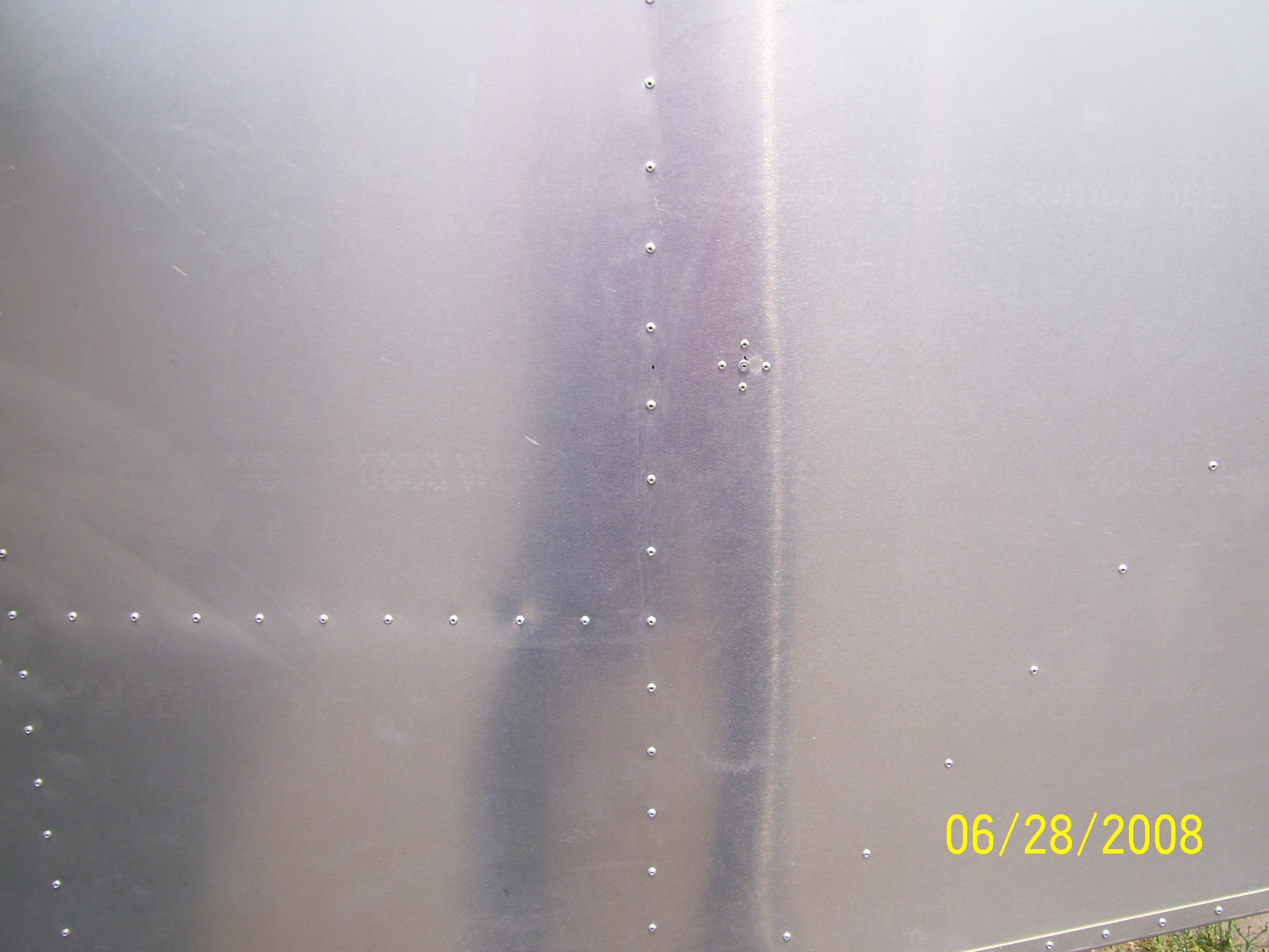

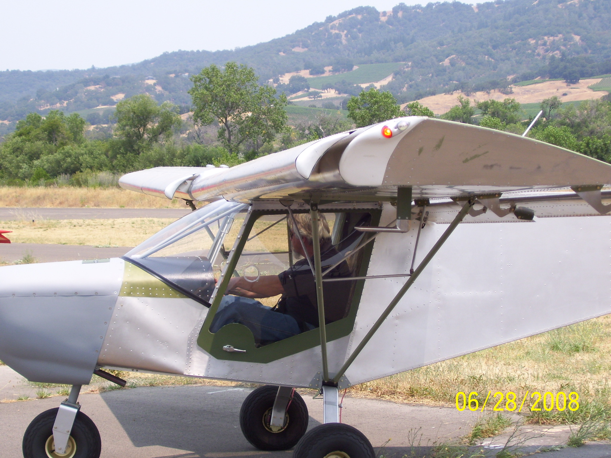

PostPosted: Wed Oct 22, 2008 11:52 am    Post subject: Air Speed Indicator Reply with quote
All,
Here is a couple of pictures I took of 701ZB, when I was out in Quality Sports in Cloverdale, CA.
The pictures show his just a little bit behind the baggage rivet line. Can not remember the gentleman's name, but he did point the static port out to me and said he has good luck with it. He flies with a Flightdeck D-180 (Dynon)
Just FYI
Keith
CH701 -- scratch -- skinning elevator
N 38.9940
W 105.1305
Alt. 9,100'
(5" of snow last night)

craig(at)craigandjean.com
PostPosted: Wed Oct 22, 2008 12:22 pm    Post subject: Air Speed Indicator Reply with quote
