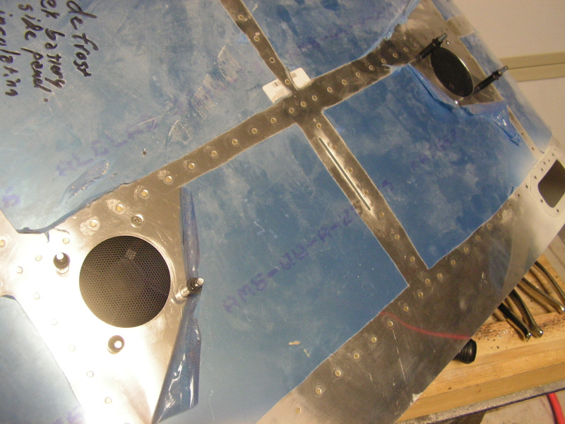

You can also just drill a little grid of small holes and no cage is needed. Just screw the fan on underneath the glareshield (screws going in from on top).
Jesse SaintSaint Aviation

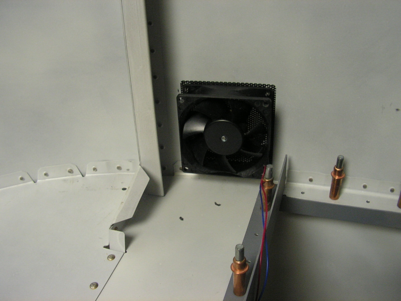

I got a really cool (no pun) fan at Fry's in Roseville CA. Less than $12 and it has a very small 3 speed switch on it. I put it on the dash about where I thought that I would need the defrost effect most (center left). They also sell a cheap black plastic cover that projects about 1/8" above the dash.
The fan cover is about $2.99. At these prices you can afford two fans. when they run you can barely hear them on low, but on high they really move the air.

I primed the dash area before installing the windshield making sure the bonding area for the window was free of paint. Installed computer fans with black grills and am using Cleveland Tools glare shield cover http://www.cleavelandtoolstore.com/prodinfo.asp?number=GSF15. This cover was rough cut before installing the windshield and will be final installed very soon.
Vern Smith (#324 main gear on & still finishing fiberglass:)

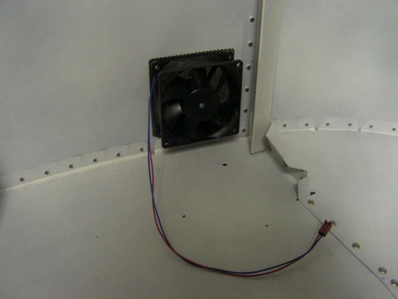

In my aircraft the defroster fans have been renamed to panel coolers. I have a Grand Rapids EIS6000 located at the top-center of the panel that was showing 145F internal temp with the outside temp approx 70F. Cut the holes and added 80mm fans and the temp dropped to 104F in similar conditions. My fans are turned on if the avionics are also on.
shield cover

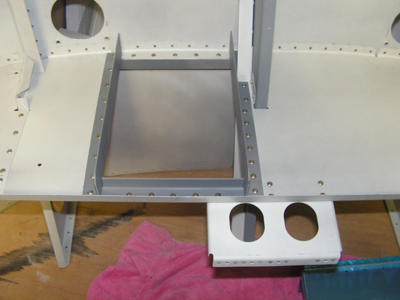

How have builders determined exactly where to place the fans? Will this be
determined by the avioncs choice, or can they be installed ahead of avionics
selection and installation?

bob.kaufmann(at)cox.net
PostPosted: Thu Oct 16, 2008 8:43 pm    Post subject: Defrost fans Reply with quote
I think that if the aircraft is pointed to the south, then the
defroster/avionics cooling fans should be to the north of the windscreen,
and south of the panel in the exact apex of the curve of the larger radius
of the arc on each side of the center post.
Bob K
PS You will only change your mind 127 times.

Hi Dave C
I started by looked over Tim's site and then took the plunge. In hind sight I would have moved the defrost/cooling fans aft about 1/2-1" as they are fairly close to the base of the windshield. As for side to side placement C I'm using a left of center radio stack so that pretty well dictated the placement off to the side.
One side note is my radio cut out in the sub panel didn't need to go as high in the panel as it does. But when I made it I thought my radios on the top of the stack would be deeper.
Enjoy C
Vern Smith (#324 back at fiber glassing)

Responding to best placement for fans:
The purpose is to remove the trapped heat from under the panel and I do not believe the location matters a bit. However, the order of assembly does matter as the fans (install two) could easily interfere with the back end of the avionics.
Suggest you build in the following order:
1) Install complete panel
2) wait
3) think
4) change the panel
5) sleep on it
6) change the panel
7) Cut the holes and install two fans (even though all the heat is biased to one side)
Cool Mount GPS and/or XM radio antennas forward on the glare shield (if you desire) yet back far enough that they can be removed if necessary.
9) finish the rest of the plane
10) cut a pattern for the glareshield
11) Install the front windscreen
12) Install the top skin just aft of the baggage compartment
13) fly
Bill DeRouchey
N939SB, flying
