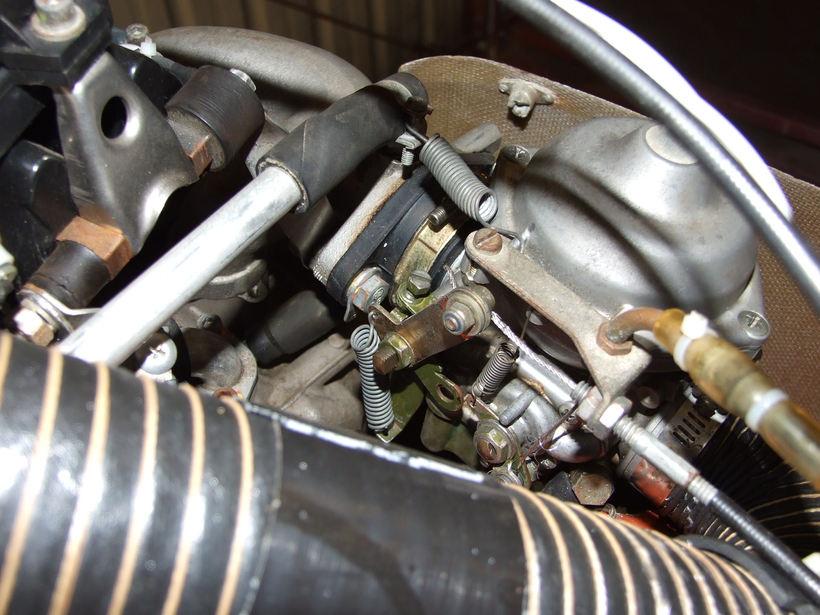

Just got back from the hanger and I took a picture of the linkage I am talking about. It seems like that is an awful lot of spring just to open the throttle in case of a linkage failure. Not sure I would like to see what happens if the linkage only fails on one side either.
The main problems though are the difficulty in holding a specific throttle setting during approach, and the fact that the throttle creeps open during cruise.
Jim

I just looked at the spring in your throttle linkage and it looks to
me that this is not the original Rotax part. I would order new springs
from a Rotax dealer and see if that does not change the situation.
They look more bulk than the original and also the ones I am using
have a long straight neck on one end. Take a look.
Top left of photo. Hope you can see the long straight end of the spring.
Johann G.

Thanks guys. I went to the Croke 701crash posting, and it appears that his original springs have a long end also. So it looks like mine have been replaced.
I will contact Rotax.

Those are not Rotax springs. Order some new carb linkage springs and enricher /choke springs. The new springs are lighter than what you have. Don't get caught up in the good ol'e boy way of fixing your engine. There is a reason and usually a very well tested reason that Rotax does things a certain way. You thought enough to buy a plane and you want it to keep you in the air without facing any problems now or down the road. Maintain it with the same fore thought.
The push / pull type of throttle will work. Just make sure you use the correct wire and throttle.

That picture says it all. That throttle return spring looks a lot like the carb support spring just above it, and as Roger said, that is definitely the wrong spring.
Our RANS S6 has a Vernier throttle with correct Bing throttle return springs and that combination works as designed.

Those are not the correct springs for the engine.They look home made.Get in touch with Lockwood or another vendor to get the correct springs. I had the same problem with my Kitfox and went from the friction throttle to the Vernier (new) from Spruce. I can now dial in my throttle settings. I takes some practice but it works well.

I bought the correct springs from Rotax and installed them. Problem solved.
