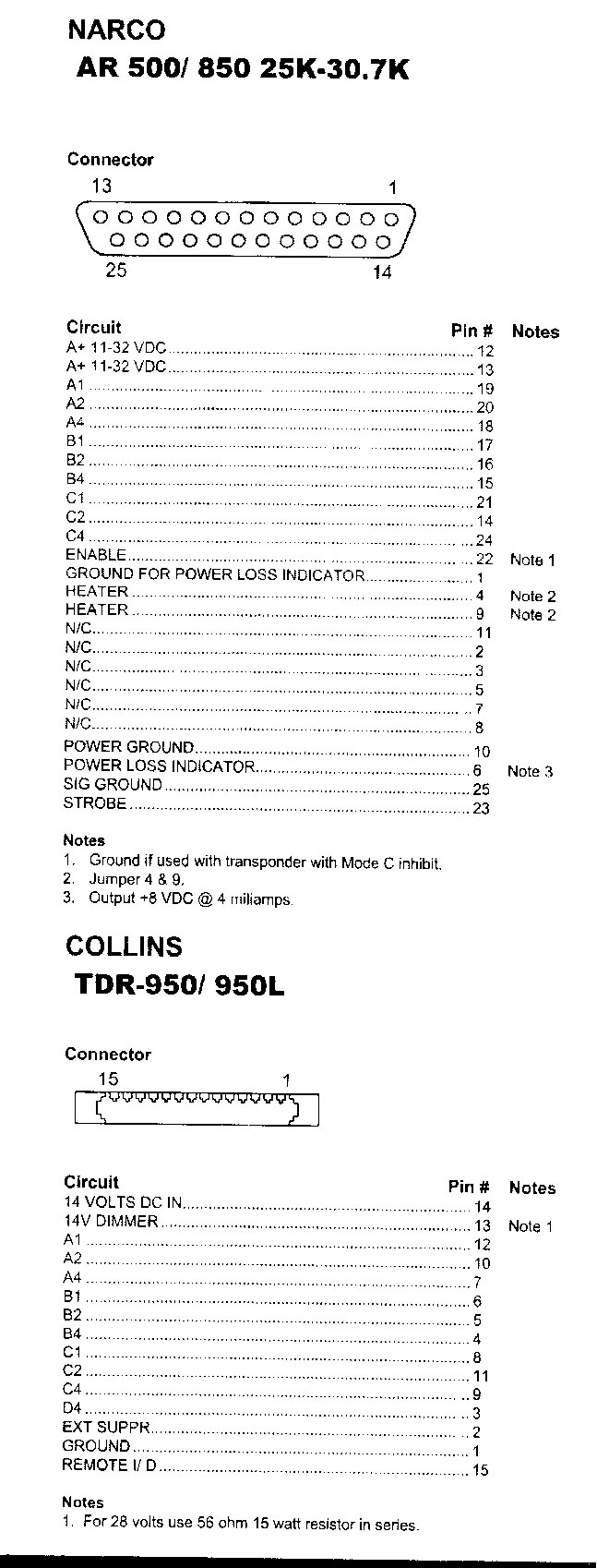

I am looking for pinouts for Collins TDR-950 transponder & Narco 500 altitude encoder so I can connect them together. Does anyone have the pinouts?
de encoder so I can connect them together.- Does anyone have the pinouts?
They're available on the AeroElectric site, John:
http://www.aeroelectric.com/Installation_Data/
See TDR950-950L.pdf and AR500-850.pdf.

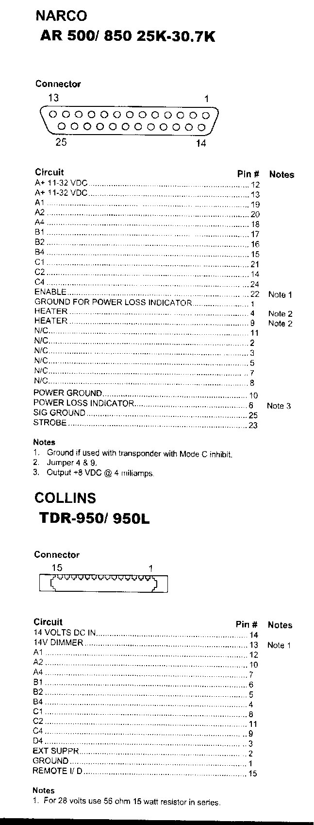

Try the attached pinouts
